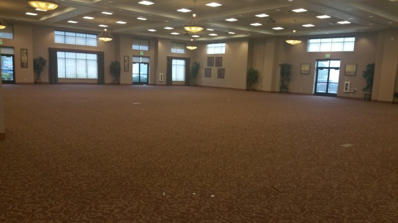

Largest Hotel and convention center in town....
Did all convention center, Restaurants, side meeting rooms, halls, stairs, stairwells...
About 20,000 square feet....

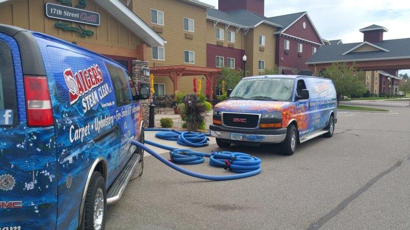

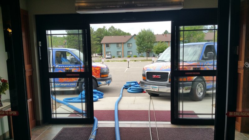

Me, the boy wonder (Son in Law Aron) 2 Butler High Heat Truckmounts, 2 Zipper wands....250 foot hose runs....

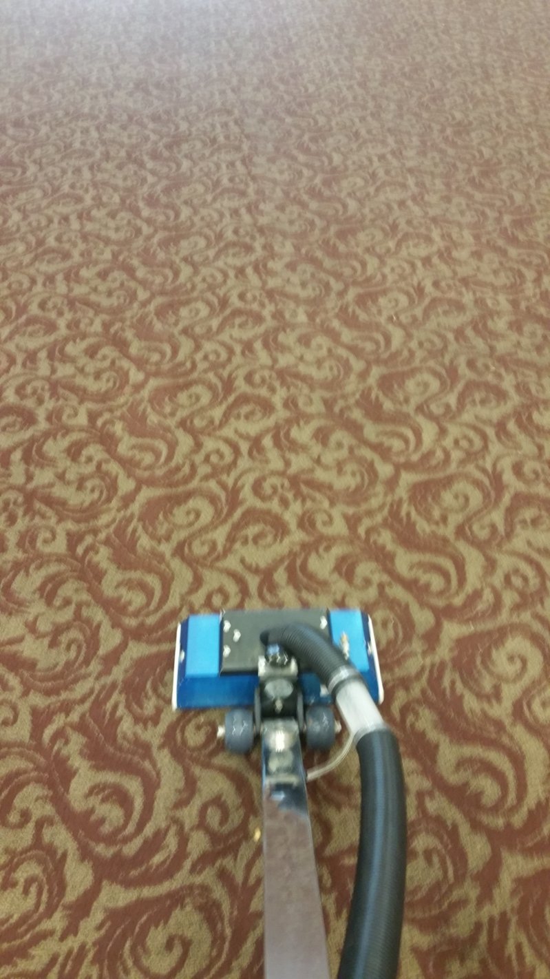

We would still be there right now and tomorrow if we were wanding....

What soil level would you say the whole job was in general?
What psi do you run Zipper at?

With my PMF 703 16 inch wand I can do wide open 4000 sqft right at 4 hrs. Zipper sounds twice as fast.

How many times did you dump the Butlers?
LOL on the oil change...and yes...they are due....
We went through just under 25 gallons of fuel per van (was getting pretty low)
and about 800 gallons total for the project....
We have the 210 waste tanks and pump outs....rarely use the pump outs...
But they came in handy today!
As well as love the 210 waste tanks....
The older Butler had a malfunction as the shut off float went bad in the tank of the 08....I have a new one in the shop and Butler has a bypass right on the wiring harness at the waste tank hook up....

Convention center and bar and Restaurant's had some heavier soils, but the rest not too bad....but we were really seeing soils in the site tubes...
Didn't get into any place that we had to agitate though....
Was pretty much spray and go which saved a lot of time too...we were prepared though...

20000 sq ft wide open space is doable with the zipper......
I did 3000 sq ft wide open space the other day in 1 hour with the zipper add 1/2 hour for setup and breakdown......usually took me about 1 1/2 hours w wand......
wide open carpet should be minimum 2000-3000 sq ft per hour w zipper..about 1000-2000 w wand.
I actually believe 1 truckmount with a zipper and pumpout could do that whole job in 8 hours
