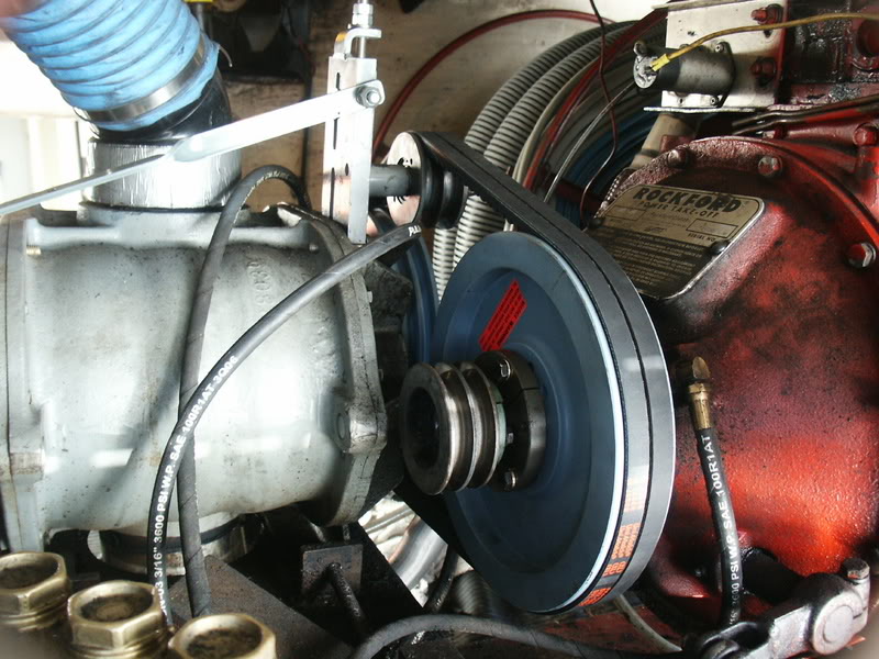

Although the proper method is to loosen up 4 bolts . . .
our customers just roll them off, and roll on the new Gates #3VX belts (about 10-15 minutes)
Belt tension is preset at our plant with Gates belt tension tool.
Only problem I have seen, is with poor quality import belts being incorrect length.
Larry

4 bolts on the blower or motor?
You'll hand to show me that trick in two weeks cause I'm real tired of undoing my C4 blower bolts.

all machines should be built with a tensioner pulley to use for replacement and adjustment....
it is just totally stupid to have to move the blower or what ever just to change a belt......machines depend on proper alignment and adjustment........when you have to start moving things that should stay stationary...........your just setting yourself up for problems............

My Big Red, you can forget about unbolting the blower, no slide to it at all. Had to get the belts on and off with a screw driver. THEN I bought one of John's HX'rs tension pulleys. Sure made it easy! It just bolted right onto the blower.
I had just installed some 10in sheaves to give it more belt contact.

I'd like to see a video or instruction diagram on how to properly set the tension and align the pulleys on a machine like this.
The way my c4 is laid out, thereto ain't no way you're going to roll the blower belts off with a screwdriver. Pump could be done though.

Jim is right on with the tension arm statement.
Gates does NOT recommend idler systems for their V-belt drives.
It decreases the power capacity of the belt system about 10%.
If an idler is used, it has to be larger than the one pictured above (post #22).
Also, as a side note . . .
the TM blower had the same side load, and a smaller bearing diameter.
Larry
P.S. Sutorbilt only uses belt drives in their packaged blower systems.
