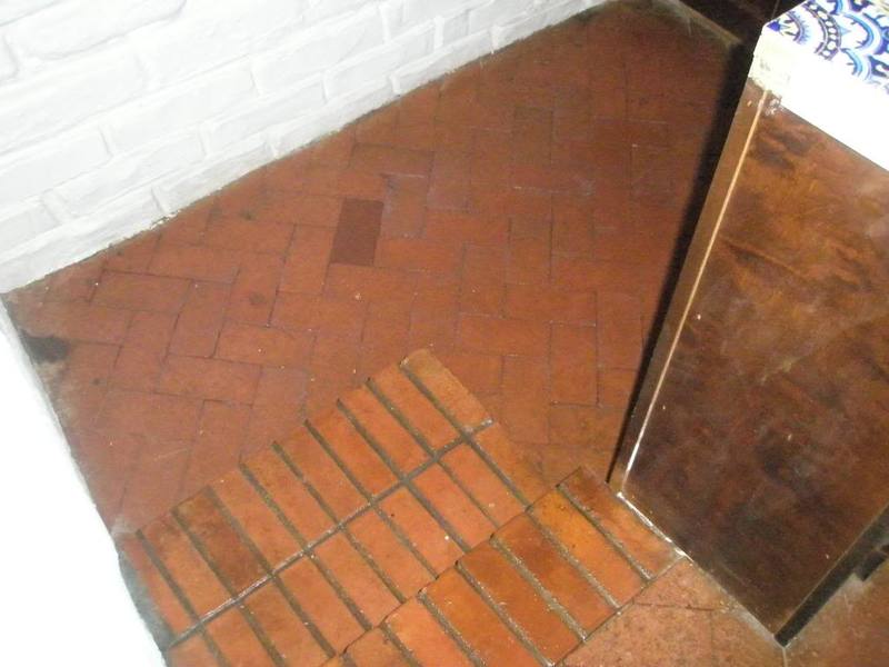

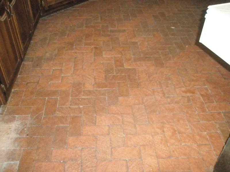

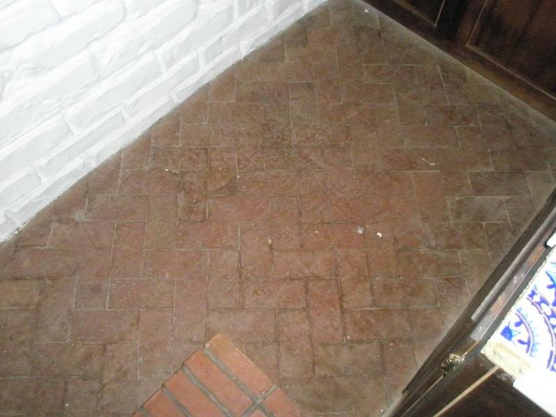

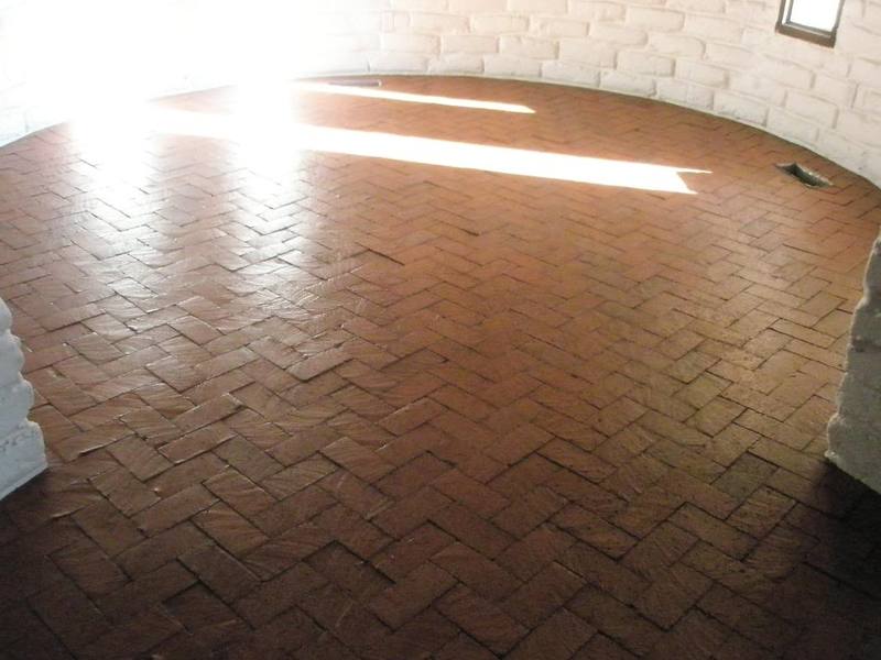

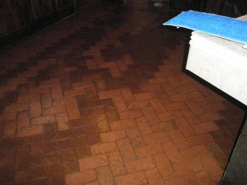

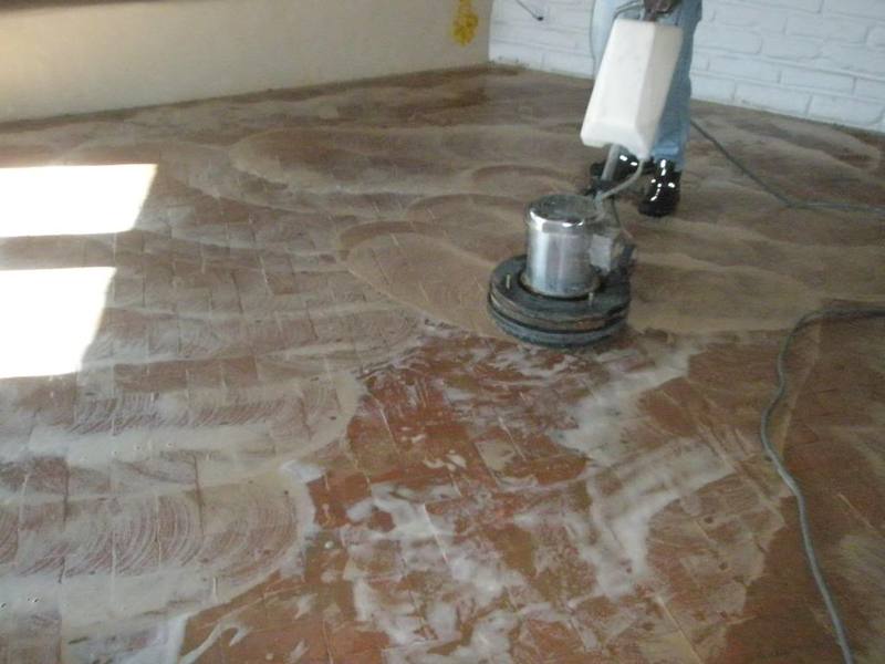

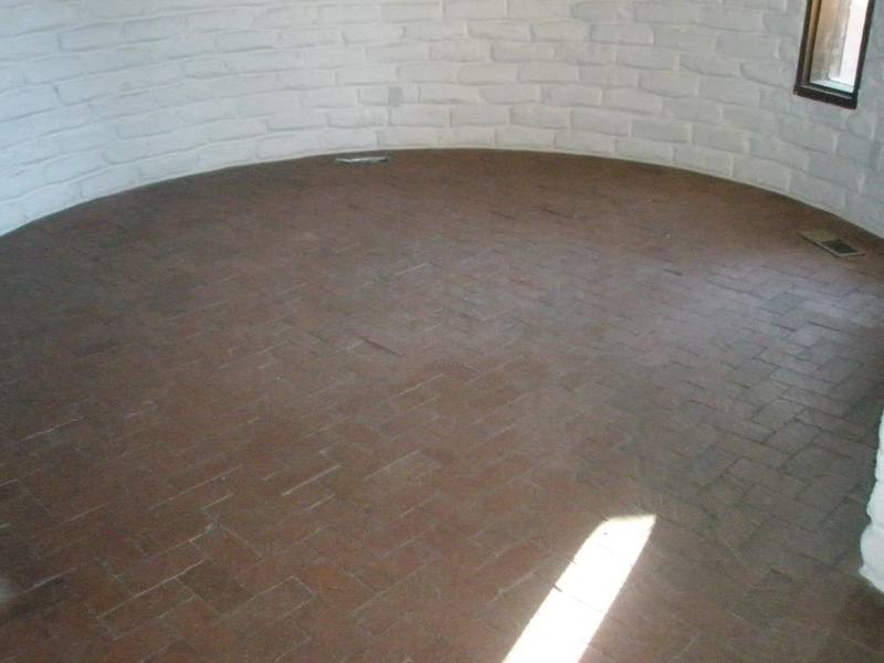

stripper 707 I think nyla grit brush 50 lbs of weight scrub rinse and 7 coats of ultra chem labs concrete finish. I will never have to go all the way back down. I do a fair amount of this and more all the time, just like the grafiti removal. It just pays so much more.

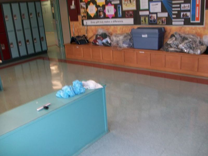

Finally, I'm not the lone person using Ultra Chem products. Have you tried any of their strippers and other floor finishes Ron? Also, the Clean prespray for carpets is really good. Takes blood, rust, gum, grease and nearly everything else out easily.I bought the last 150 pounds of the Extract powder I could find here as they sadly aren't making it any more.. If you ever get a chance to meet Ian , the chemistry engineer, you'll gain a ton of knowledge. He spent years with S C Johnson before he went to work for John.
Their Diamond on VCT at a school I do:

I used the mini spinner to contain all the mess they dont want that shit running down the street.
The diamond is nice, I sell their neutral cleaner and conditioner to all my tile and stone jobs so i know what their supose to use. Keeps the floors looking their best for the longest. but they are spendy.
