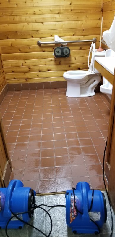

This bathroom kicked my butt.
Was a wax coating that was different than a wax.
Two strippings to bust it loose.
The rest went well. Good thing they had more work to make up for my 2.5 hours in that little bathroom! 😕

10,245
Rotary would have made the wax job easier. That’s why I carry at least an RX 20. I also use Kaivac floor tool for strip jobs if not an auto scrubber.

Mike G
epoxy guys are supposed too have a sick steipper that will help break up epoxy. ive wanted too try it on wax but haven't had too many bad ones unless saltillo
