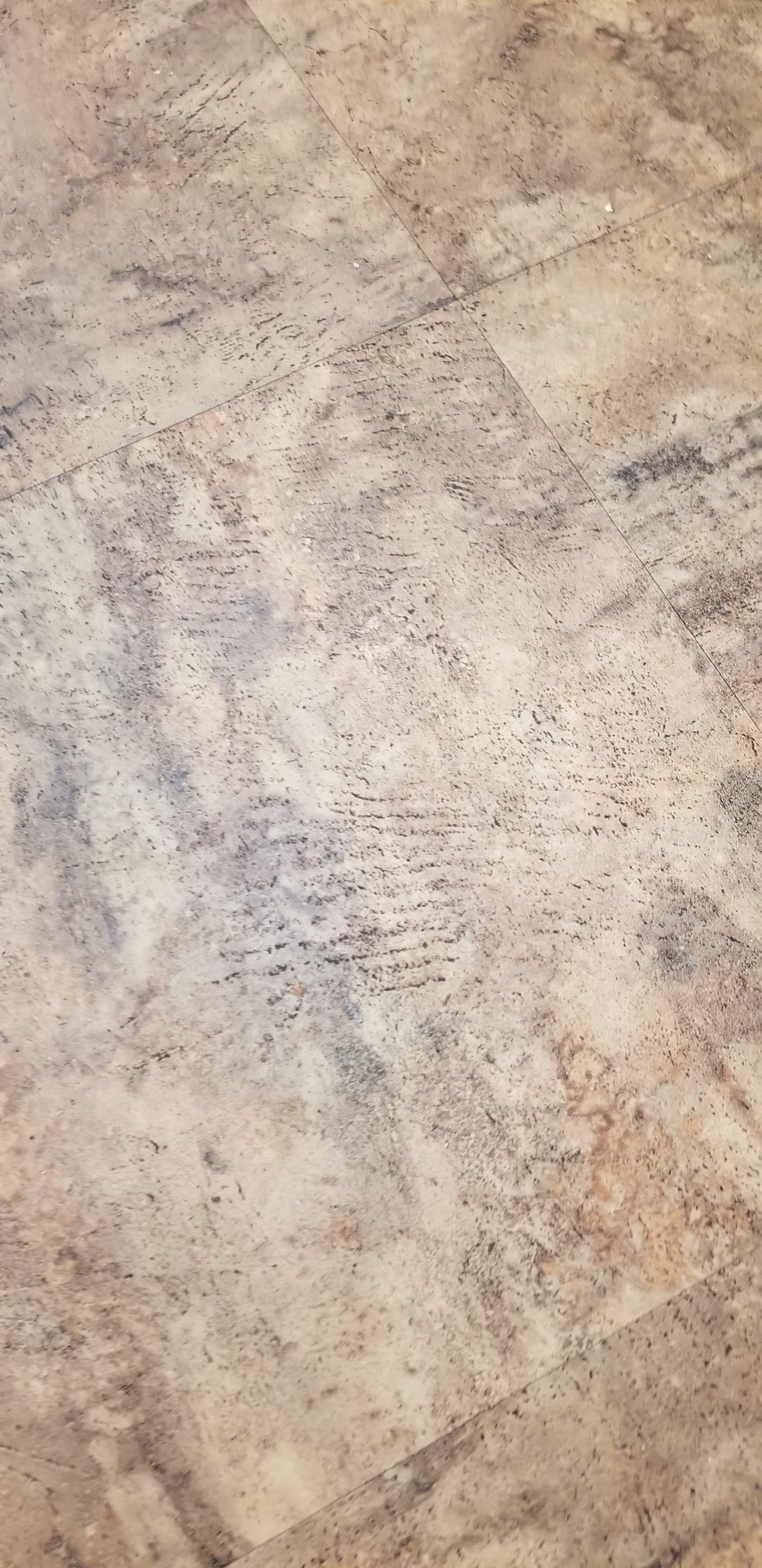

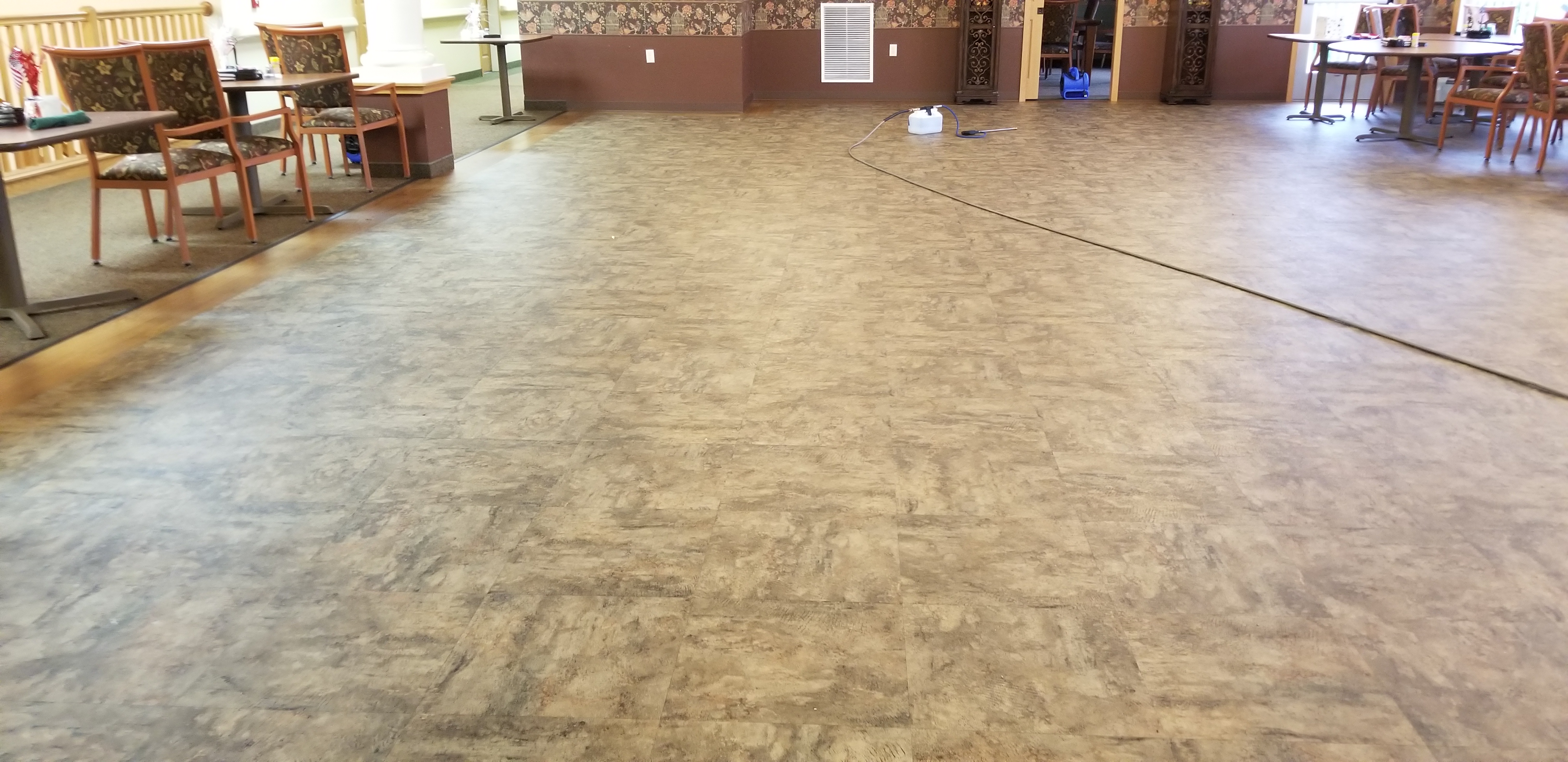

Last nights LVT cleaning
11,200

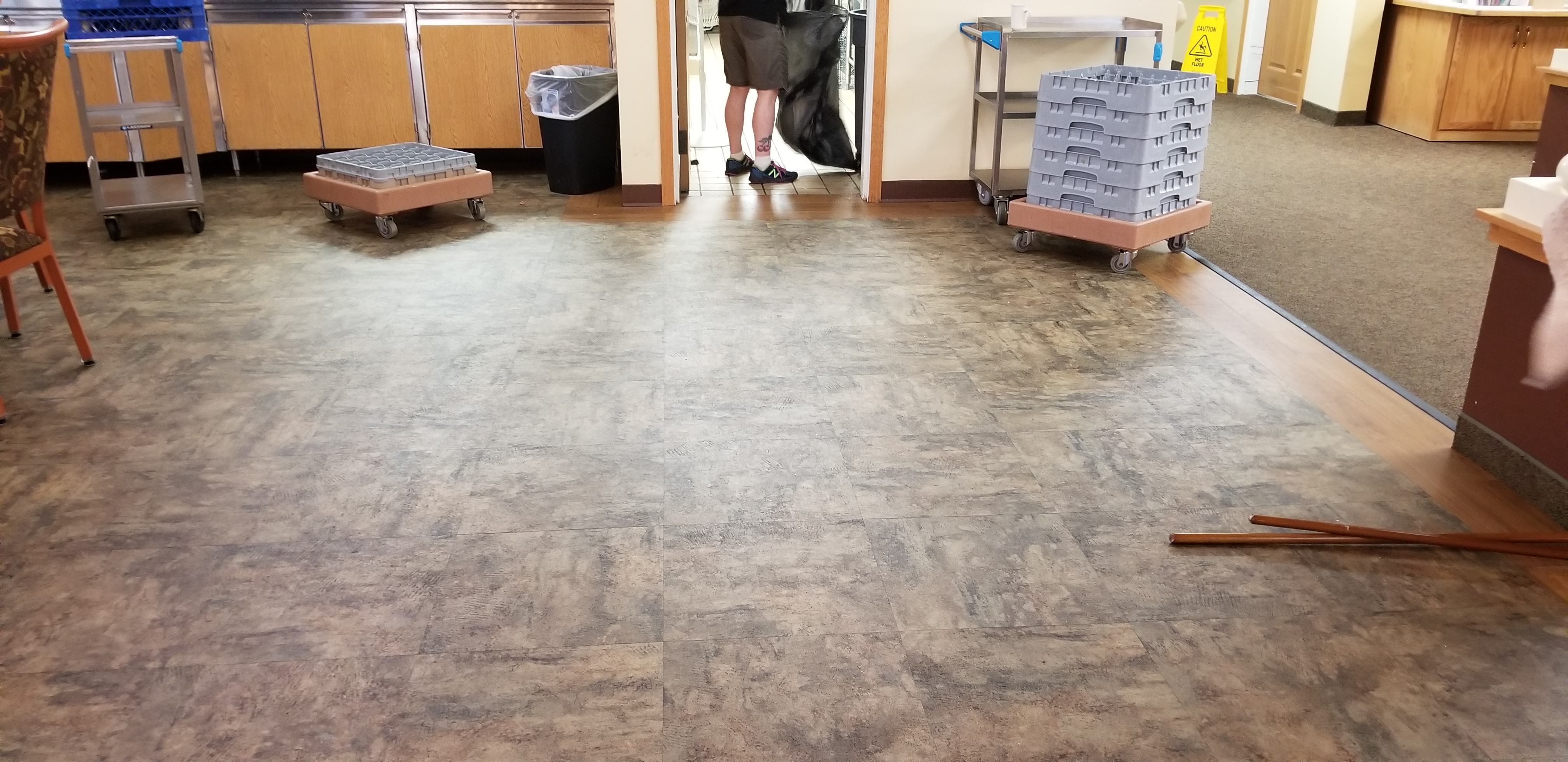

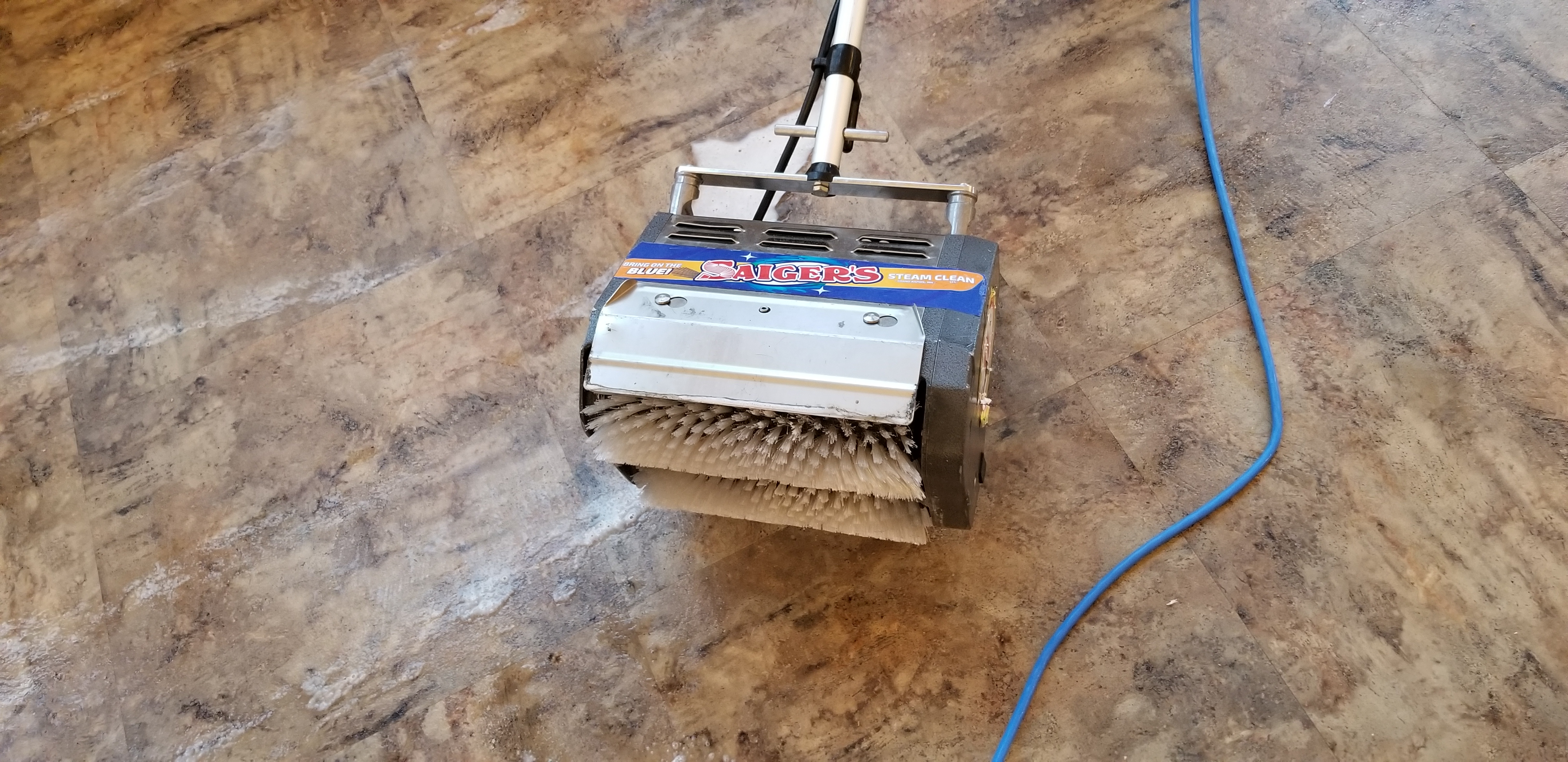

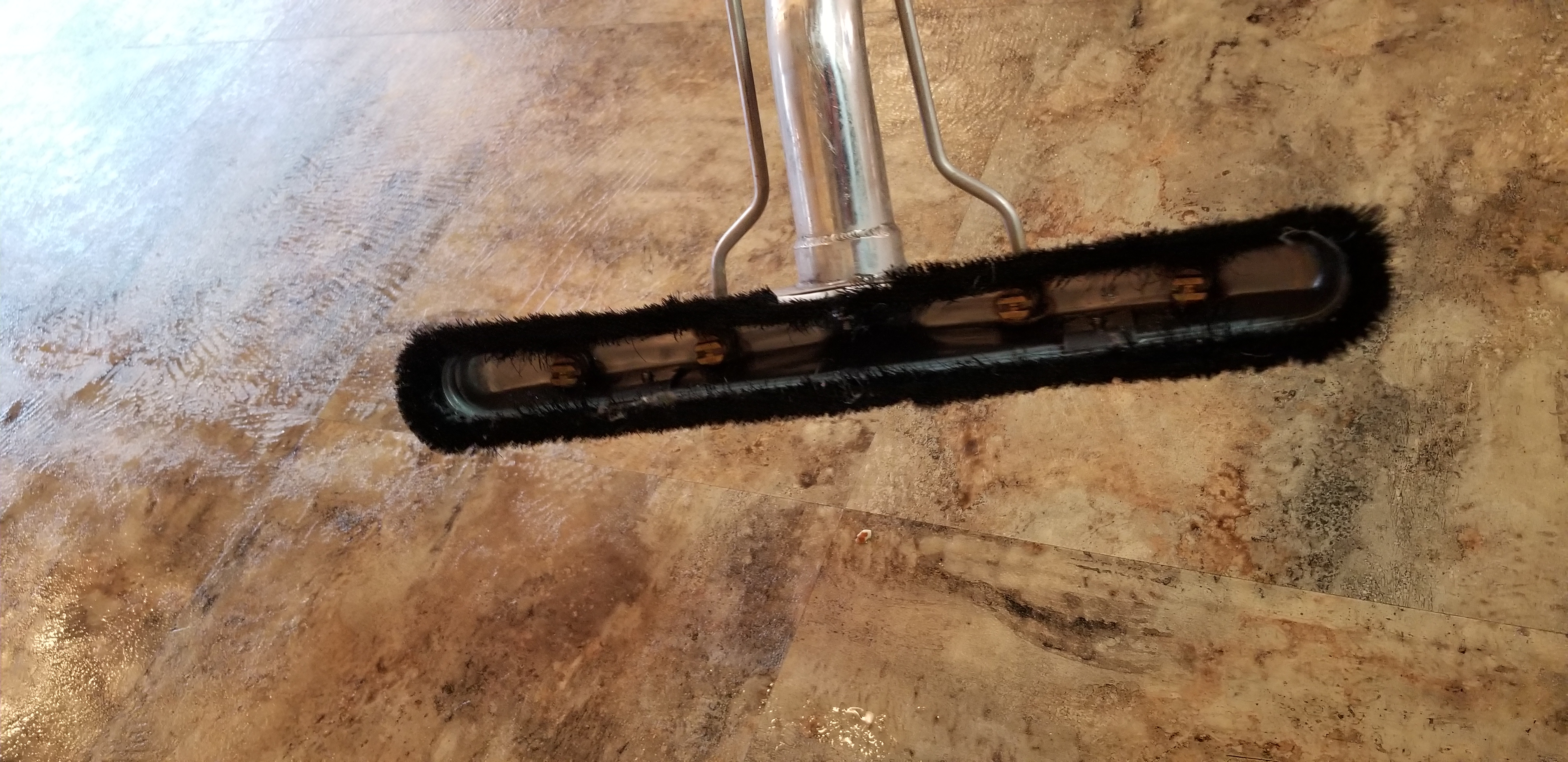

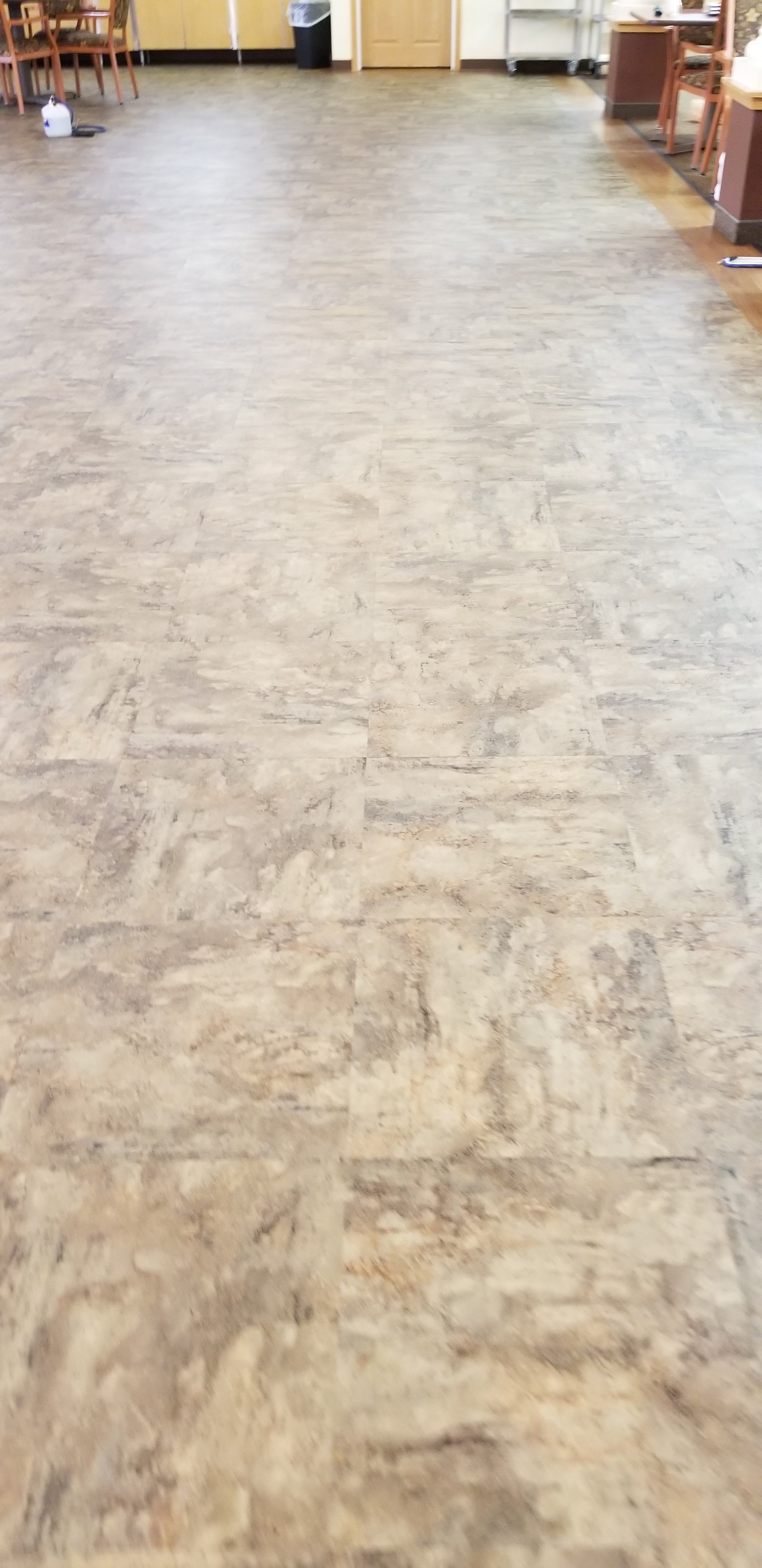

They used to have this carpeted and we would clean.
Now LVT...so they asked us to clean.
about 2150 square feet that using one mop and bucket everyday....
It's just dirty and sticky.

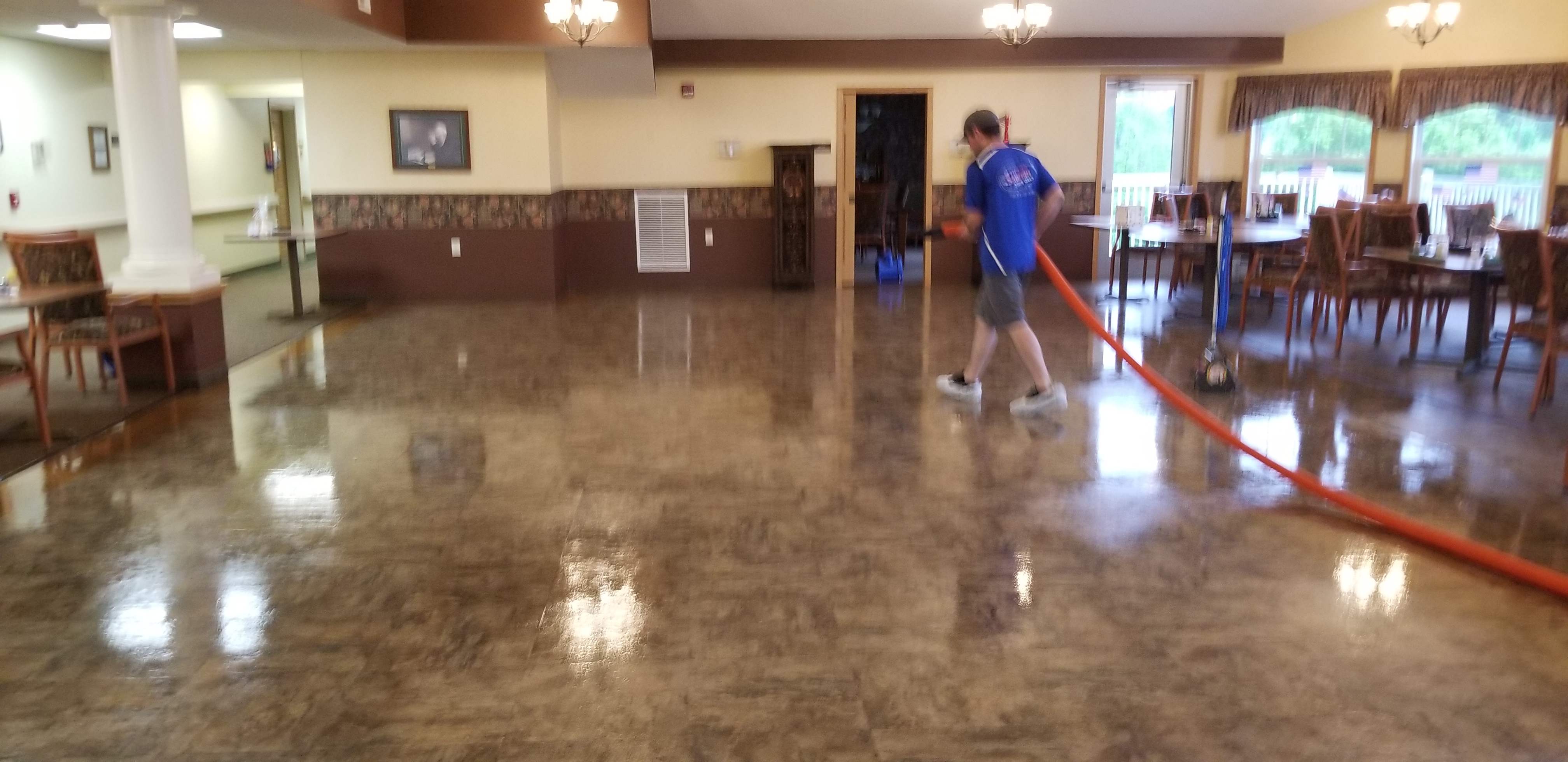

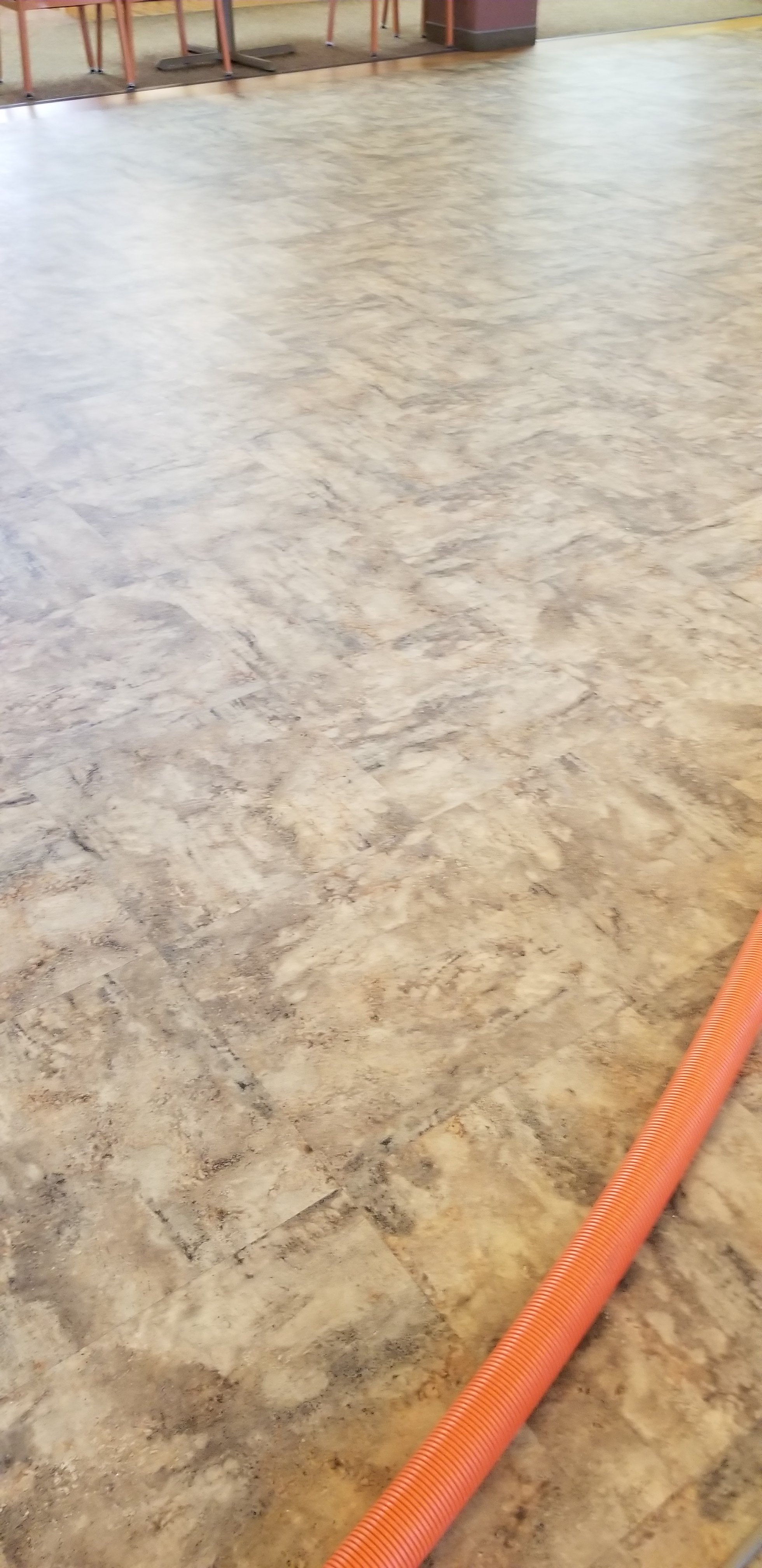

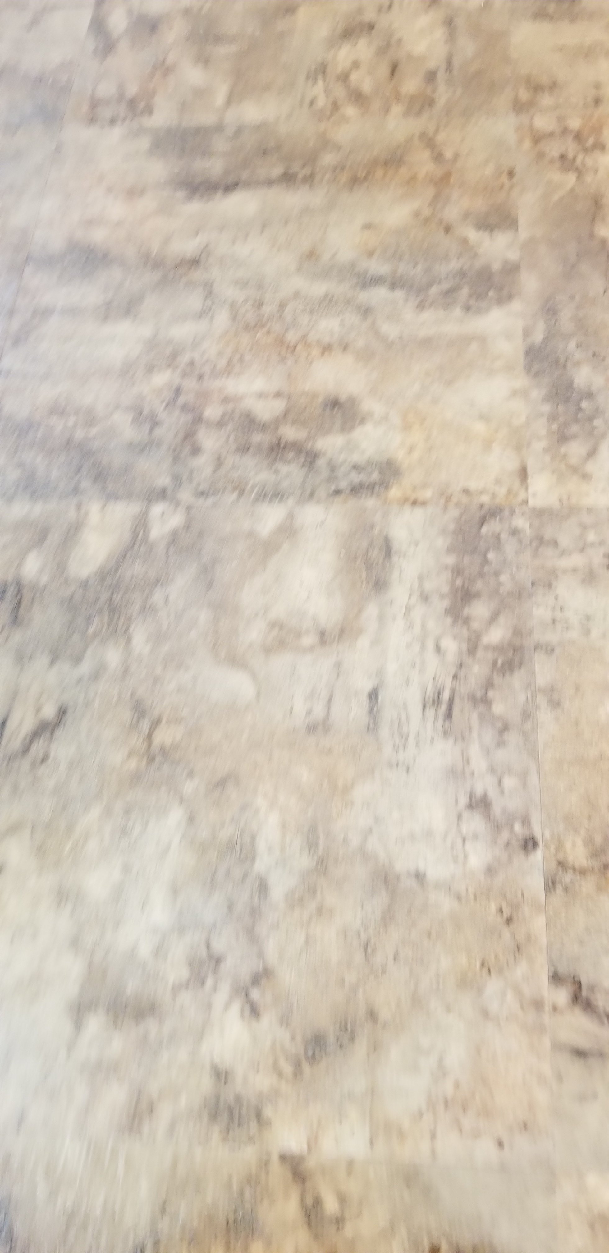

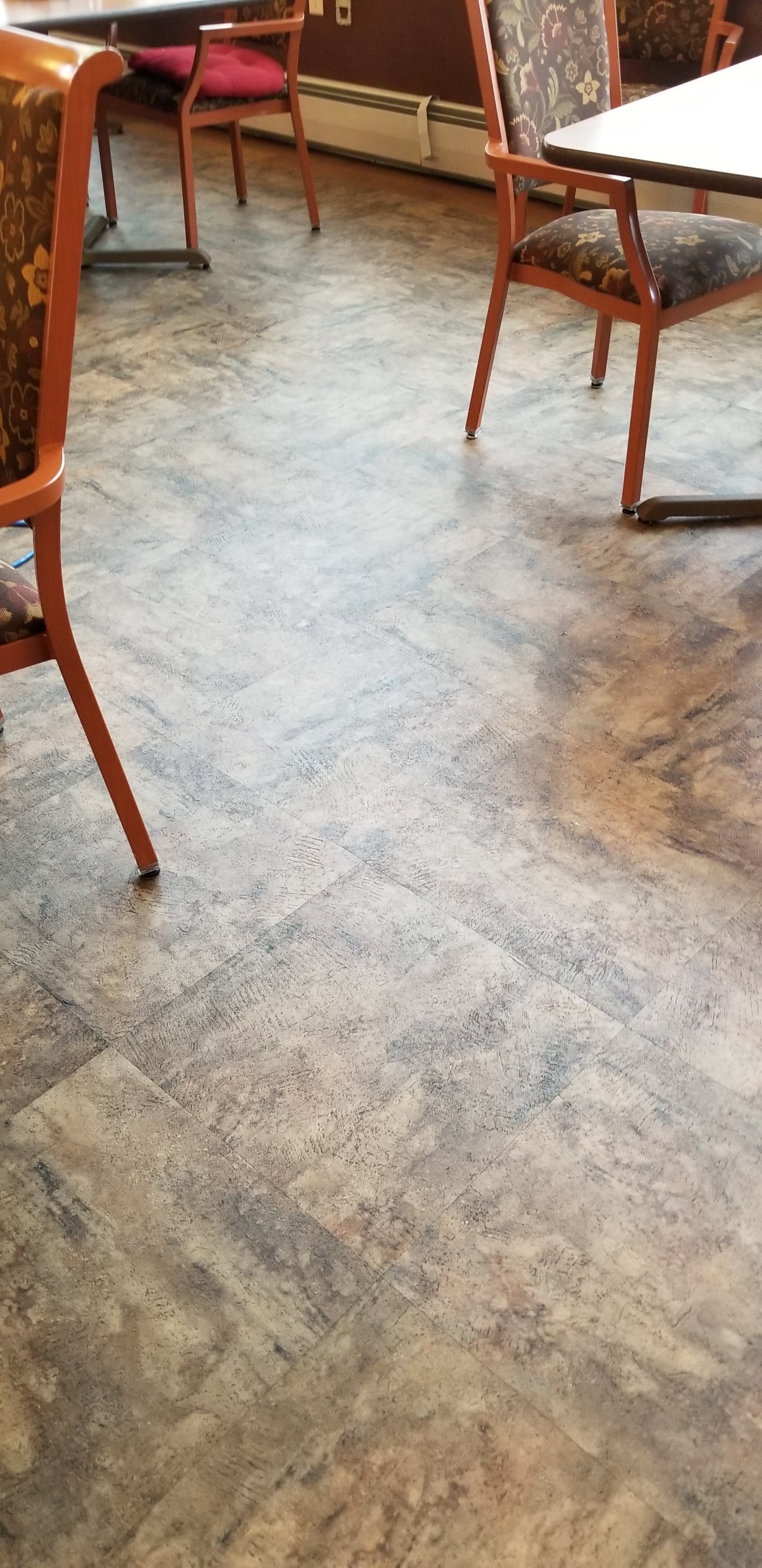

Now it's squeaky clean....

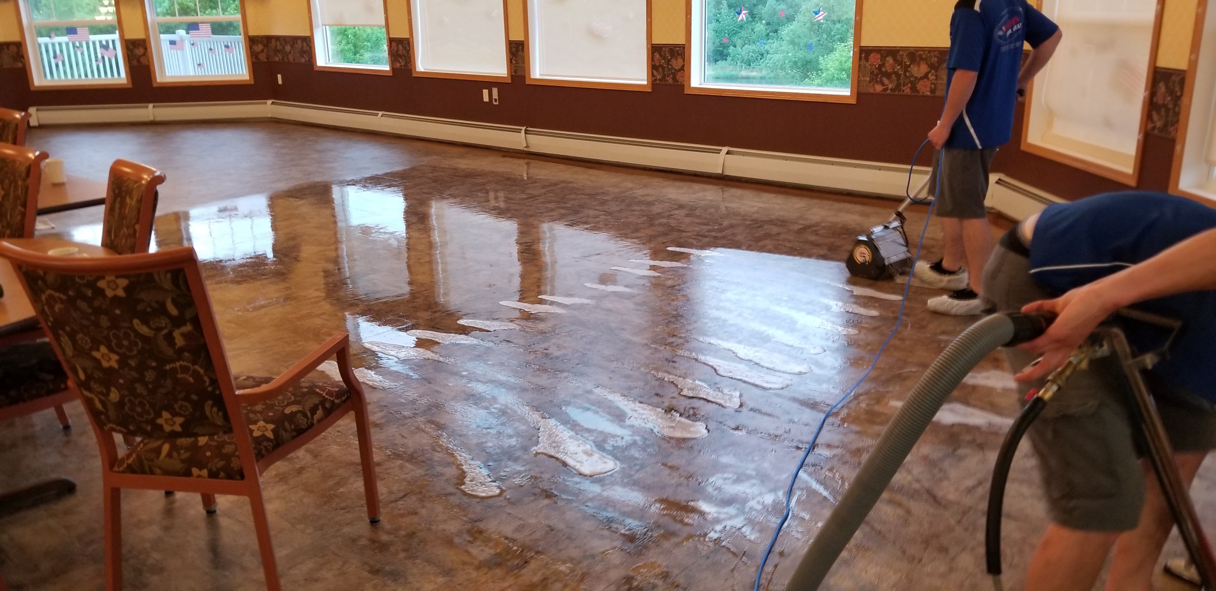

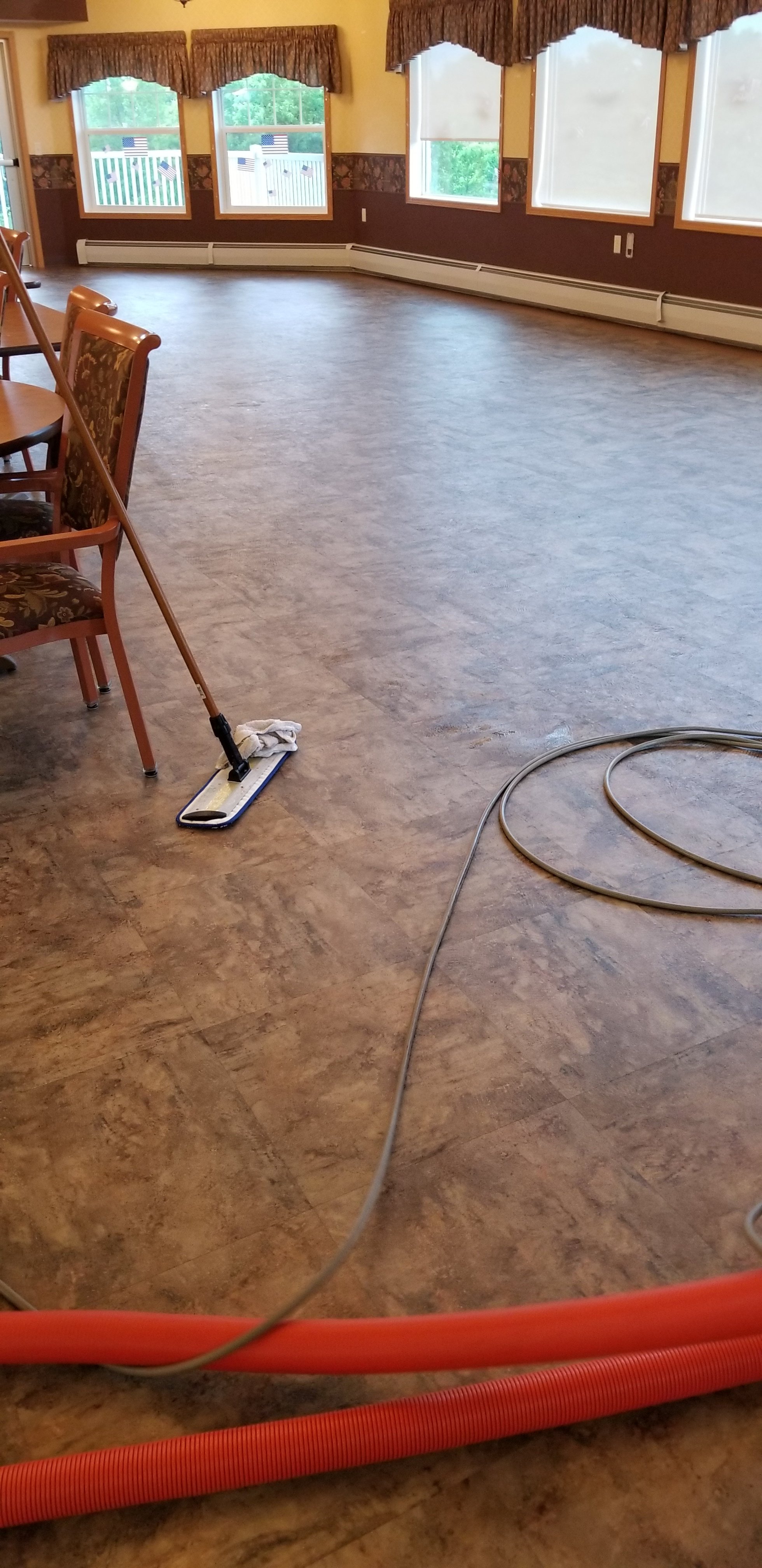

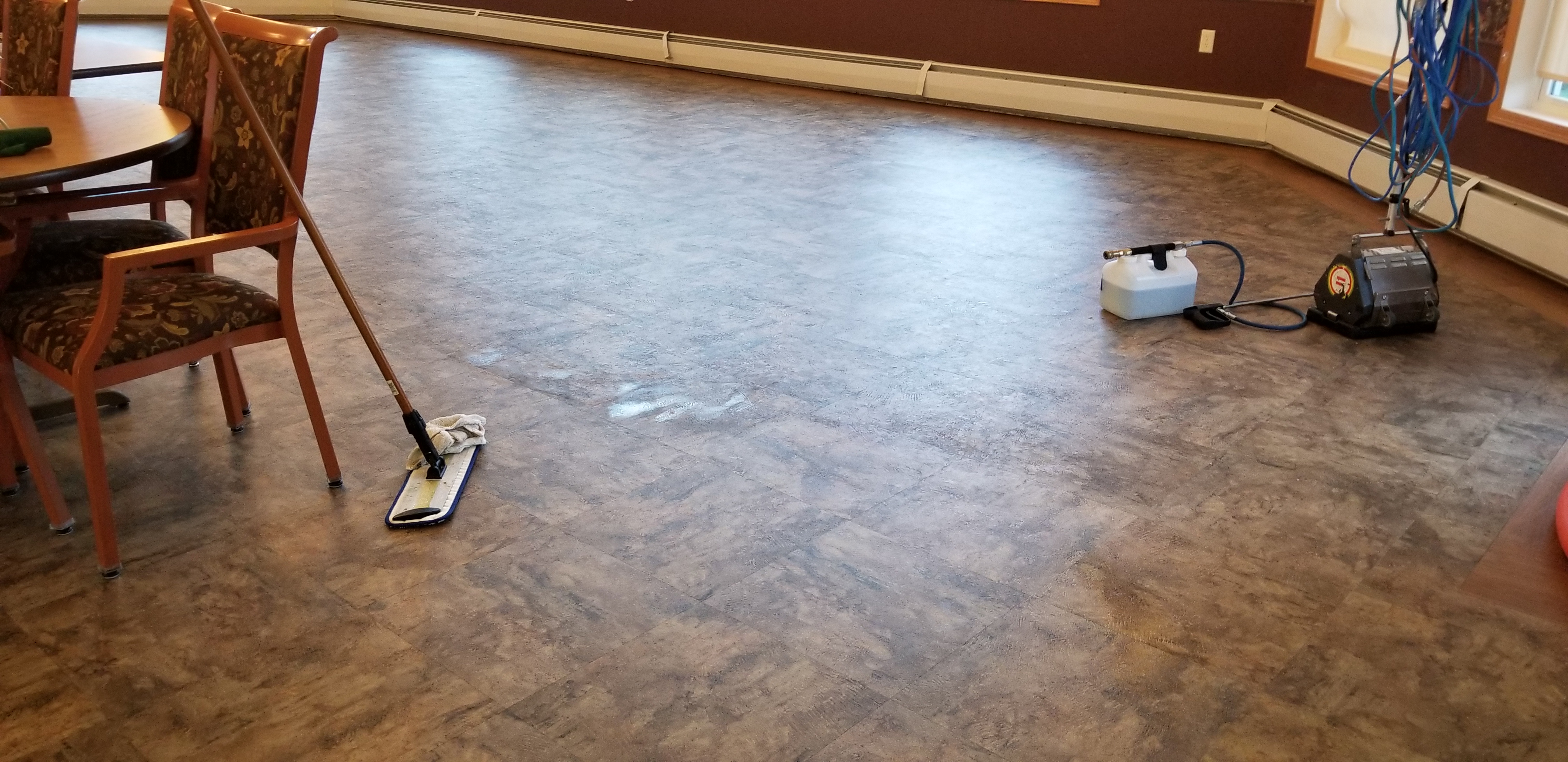

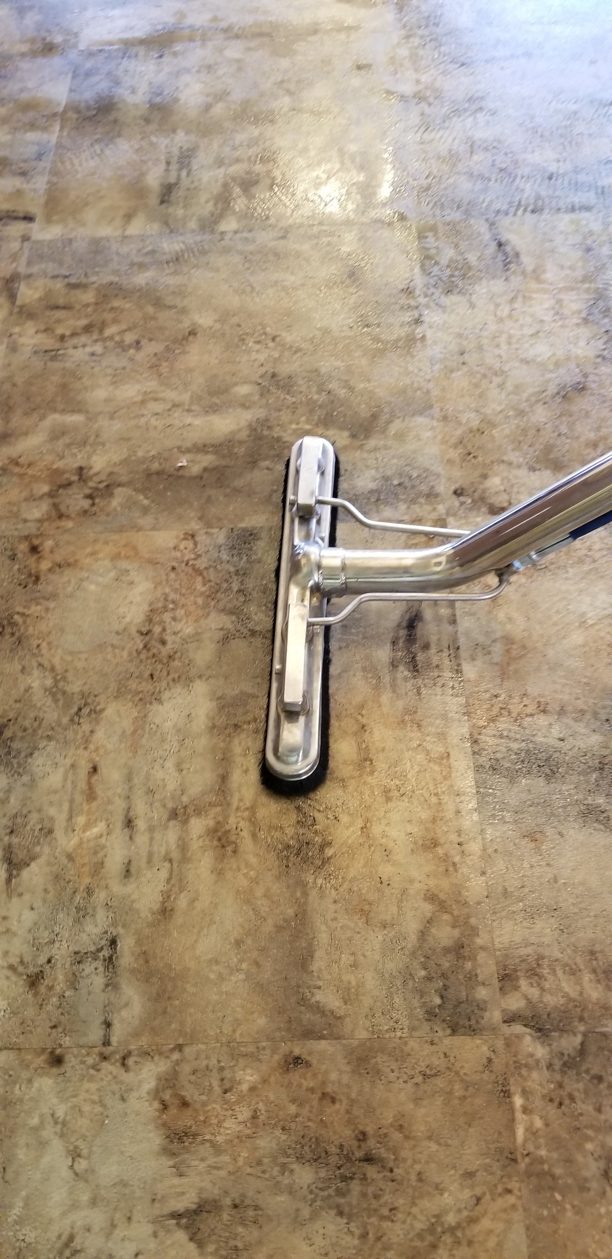

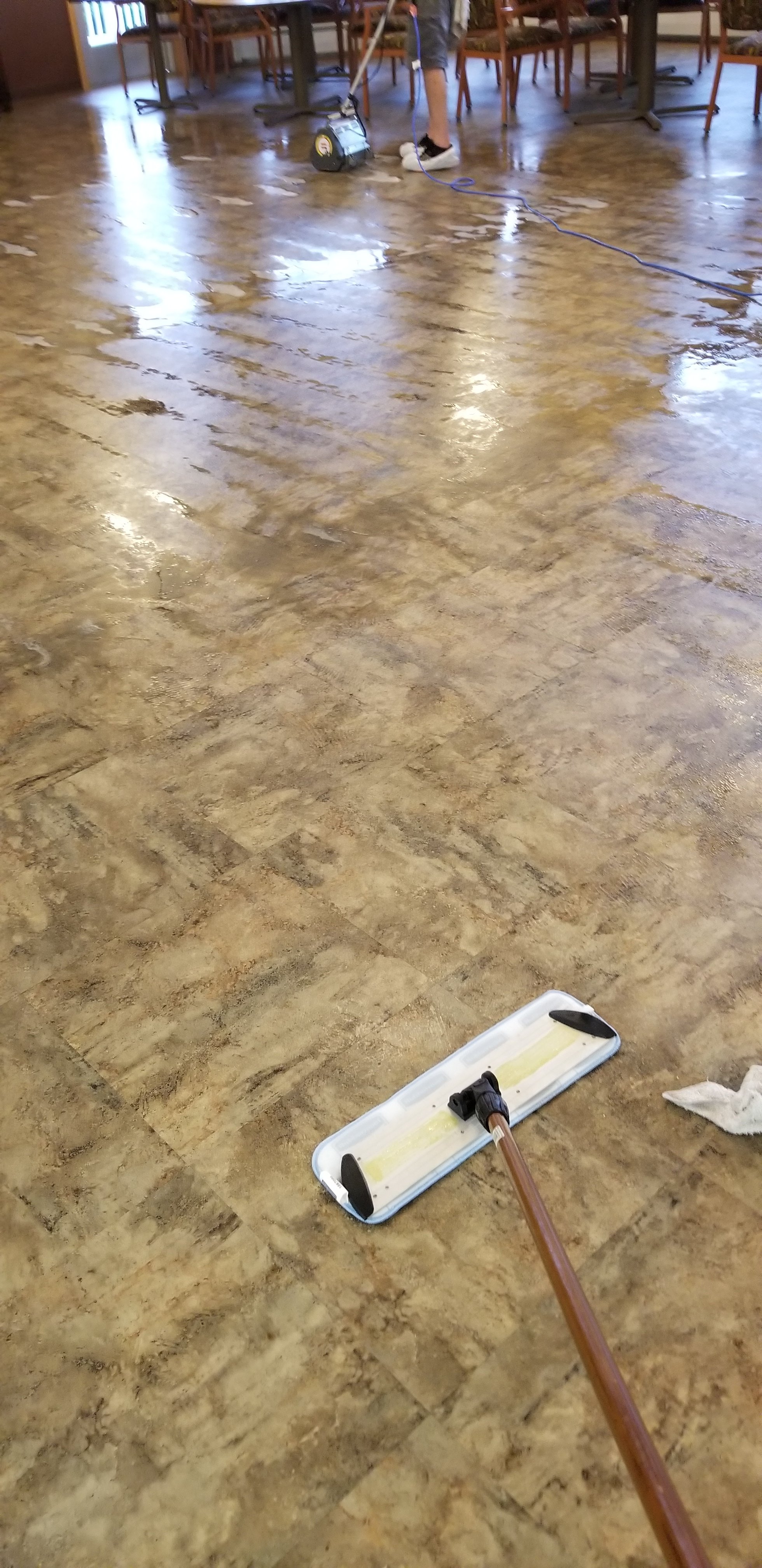

Light mist of Saiger's Sauce 1

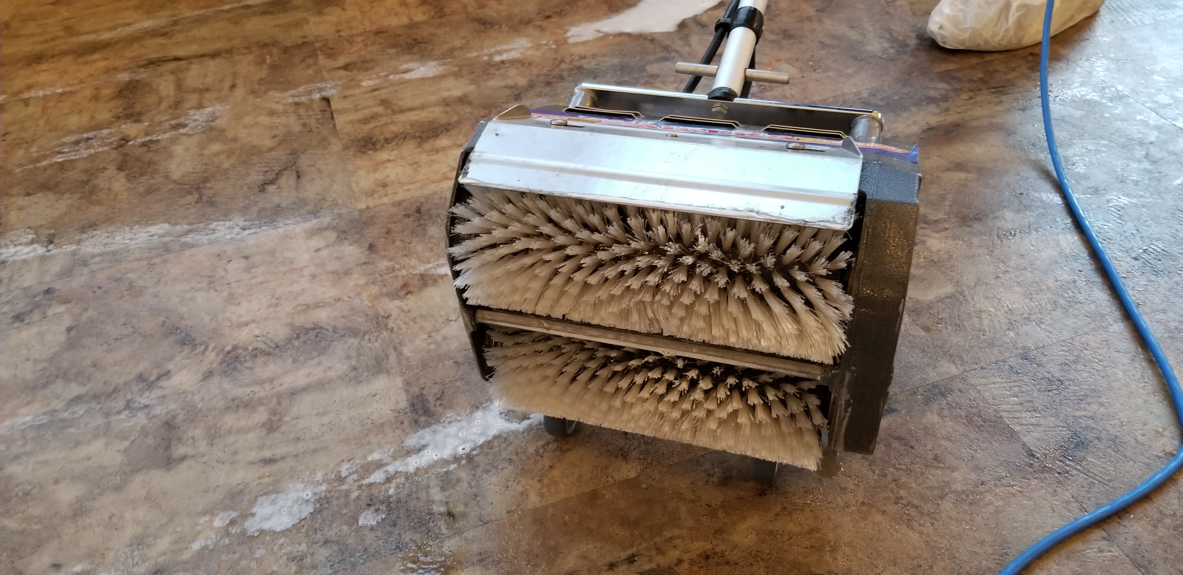

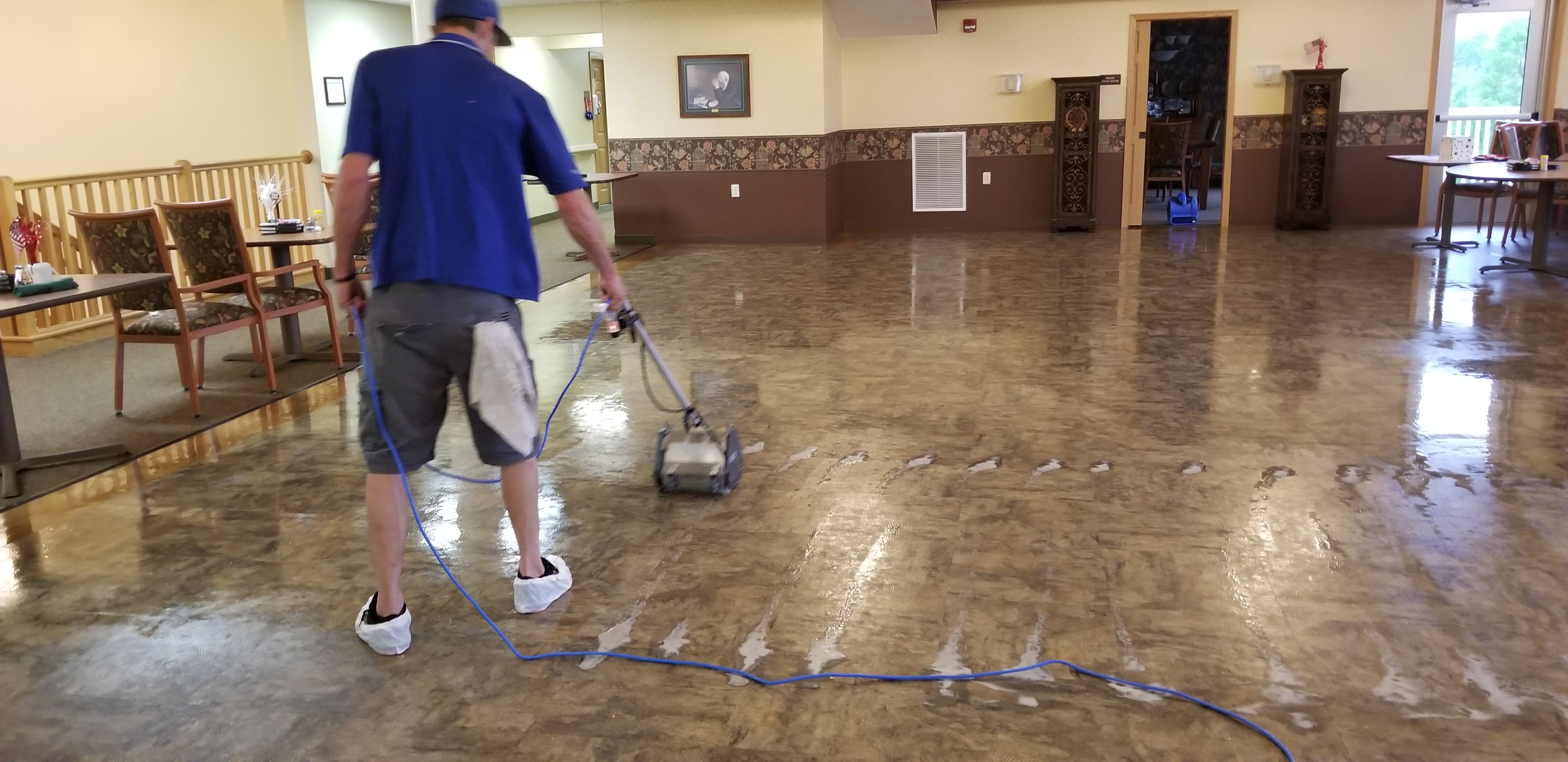

CRB scrub with standard brushes

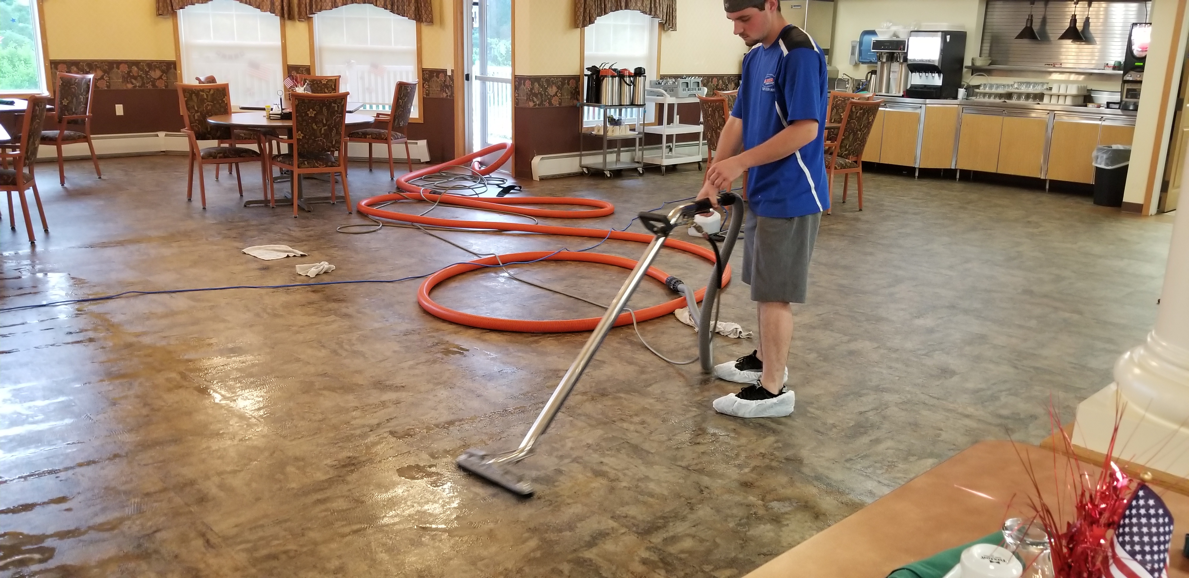

Rinse off with hard surface wand and 400 psi

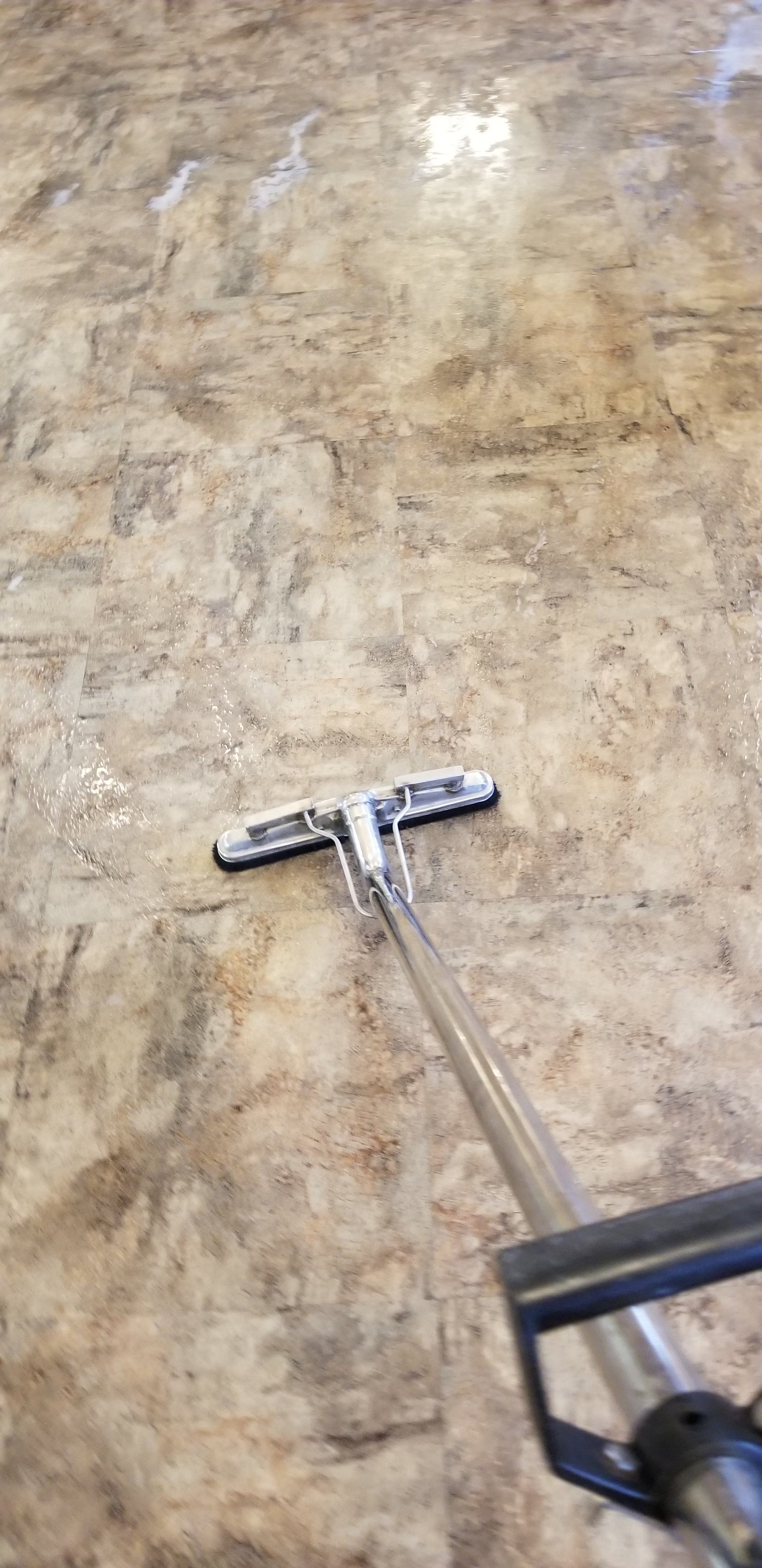

Flat mop to make sure no foot prints and speed dry....
Send invoice....finally go home for the day....

Be nice to have 20" CRB.... If I had to that all the time, I'm purchasing can power scrubber...
28,277
sure you posted enough pictures Mark?
10,237
Looks really good. You made a lotta work out of it. One of my 26” auto scrubbers would’ve had that done in about 20 minutes.:biggrin: But good job
