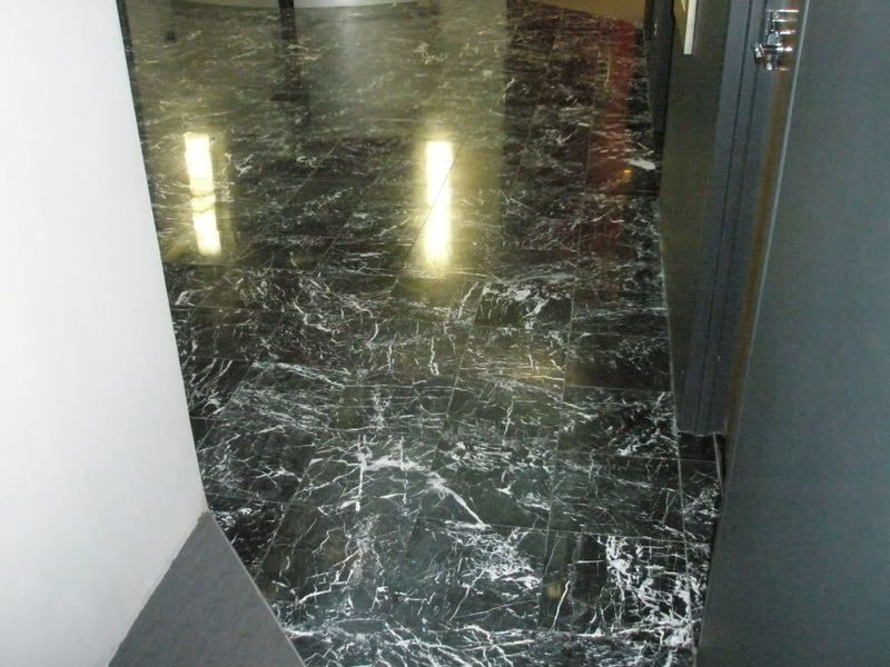

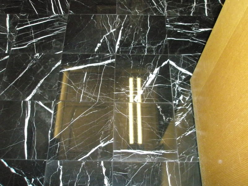

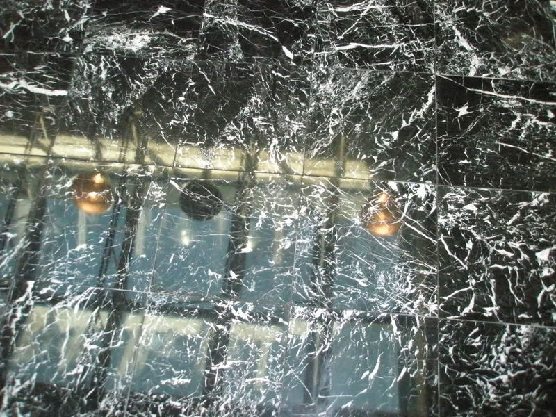

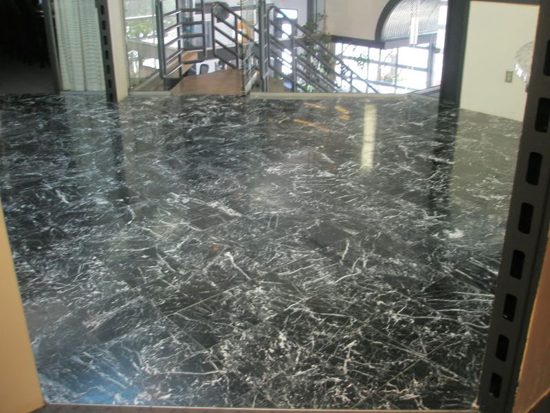

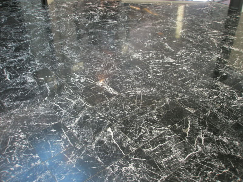

this is my latest stone job with Monkey Pads. It was a black marble and in bad shape. The maintance crew had slaped some wax on it and it looked like shit.
Before
its hard to see but they washed the floor with a acid cleaner and it has a bunch of acid marks on it.
After

no im not going to flatten the floor they knew about the un even floor. shined up real nice thats what they wanted.

Good Job, on the veined black marble.
Did you have to start with 400 grit Monkey pads for the acid damage ?
We typically use them first, on that type of problem.

picture framing is when the floor is uneven-or has lippage the lippage on this floor is not all that bad but due to the color of the stone it jumps out more.
First step was to strip the wax off the floor applied by janitor. We started with the 800 grit and did that step twice. We did the rest of the steps up to 11,000. Then we sealed with impregnator and set for 45 minutes, then buffed with cotton bonnett.
Ps you rinse the floor between steps.

Look at the bottom picture of Ron's.
Find the tile at the bottom of the flour. light.
Look at the dull areas along the bottom edge.
That portion was not polished as well because the tile below it was slightly higher.

In the after pictures beside the door I see near the flourescent light reflections of what appear to be window paneing.
Am I right Ron? Did you encounter any lippage?
