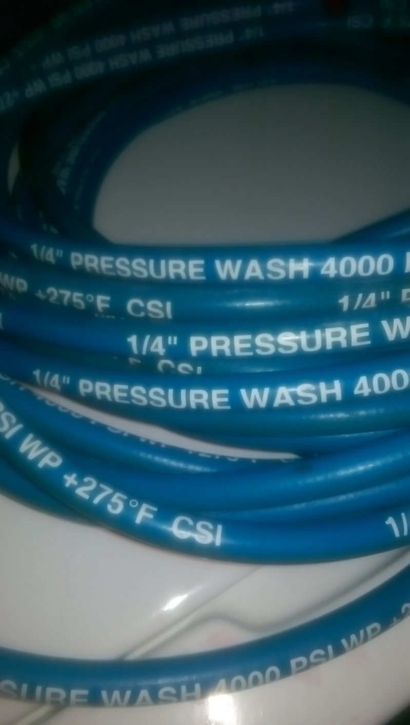

I get this locally, .75/ft. No issues, superflex and holds heat well.

I would question that 4000 PSI hose . . .
I'd ask for a mfg. spec sheet to confirm those ratings . . .

We like a section of wire-braid blue hose right at the machine ;
since it can withstand 275' temps from high-temp HX's.
I have a bunch that I got with my TM from you, so I guess I will take it to the hose shop and have them cut and make me several sections for this.
