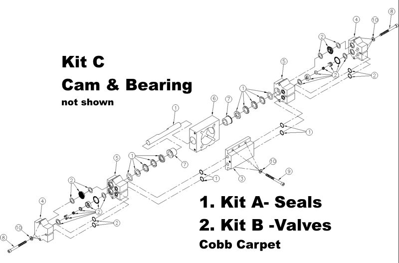

My pumptec is leaking water out of the pump head.It's nearly impossible to figure out where as I looked for a while, but it seems to be by where the bolts are. I tried cinching down the bolts with an allen key, but it still leaves a puddle. Suggestions?

Most likely it's the plunger seals in Kit A.
Not too hard to install.
