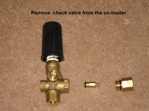

I couldn't take the pressure regulator any more so I replaced it. I can't get it to work for some reason. It shows no pressure and then spikes when I change the pressure and then nothing. I took it off and checked to make sure all the ins and outs where right. I even got s second pair of eyes to check. It's on the bench currently. I took it apart and checked for something foreign. Nothing. It's possible the 3/4 line from the bottom of the water box isn't a perfect seal. It is a little stiff. I bought new while I was at my supplier but haven't replaced it yet. Any ideas.
Gene
Gene is it an exact replacement part? The reason I ask was I faintly remember a tech support memo that said to remove a disk in the regulator.
I'm not saying this is true of your case as this was many years ago.However small changes specific to your unit can make huge differences.
Reactions: GeneMiller
GeneMiller
Mar 24, 2009
3,541
Boca Raton
gene miller
It's the same brand just 9 years newer. All the connections are identical except the bypass. The new one says bypass on both sides and the old one only one side. Since the other side has no markings I'm assuming it is a bypass Also. Could be a critical mistake but if it was an in or out I'm sure they would mark it. I do remember hearing about A spring and poppet that needs to be removed. I'll open it and check. Thanks Richard
Gene
Its been too long I wish I could remember better. However I do believe you are correct about the spring and poppet. Maybe try Youtube and see if someone put up a video????
