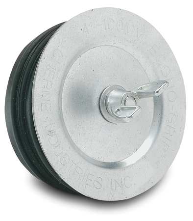

Plug it ..

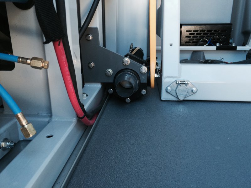

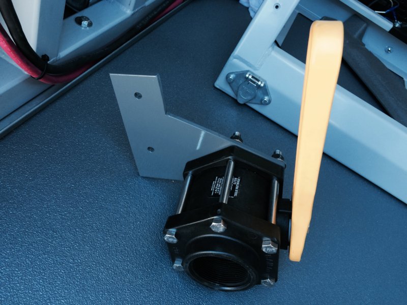

Think I paid 35.00 bucks for the valve and built the bracket myself. 2 inch Banjo valve on amazon.
