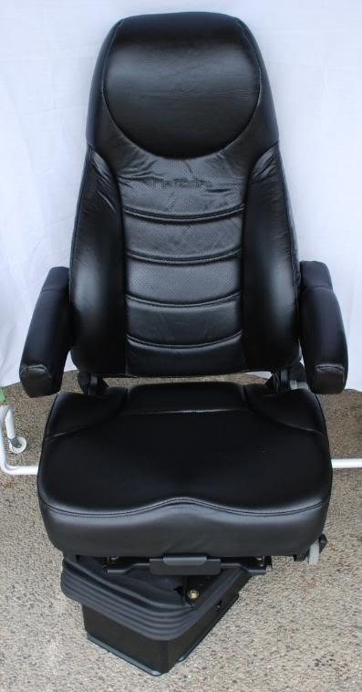

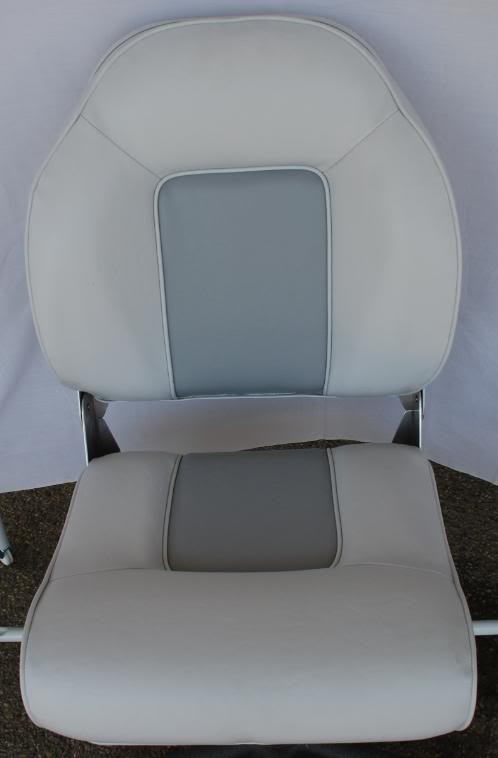

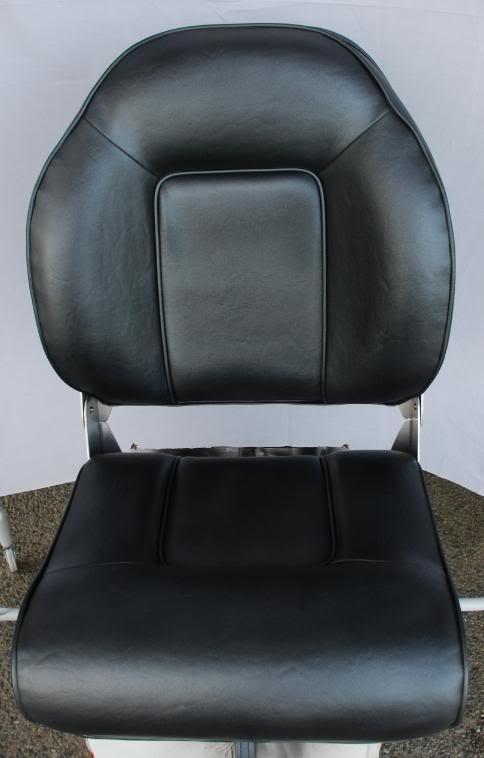

Picture #1 - Leather/Vinyl Combination - white pigmented leather and black simulated leather (before).
Picture#2 - Refinished as Black Pigmented Leather with the classic leather scent (after).
Picture #3 - Simulated Leather (before).
Picture #4 - Custom Refinish to Pigmented Leather “Metallic Effect” with the classic leather scent (after).
