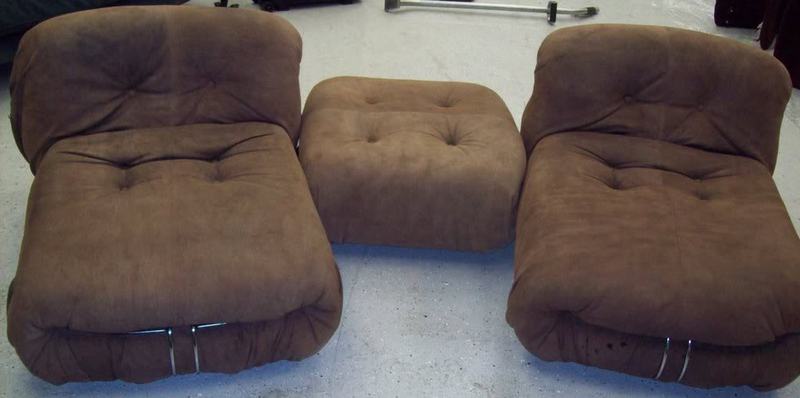

Besides the grease stain gone on this 20 years old nubuck, which is the correct answer for reviving its color?
Pick your answer!
A. Hydrating with Fatliquoring.
B. Hydrating, Fatliquoring with Nubuck Transparent Dye.
C. Hydrating, Fatliquoring with Nubuck Opaque Color.

I'd pick A but honestly, I'm just guessing.
Is this a job you have got to do? If so, can you post some progress and completed pictures please?

Well I'd say "C". I didn't know there were 2 kinds of nubuck dyes - transparent and opaque. But since the finished product looks more than transparent, I'd give it to the opaque. These are the kind of jobs I've not done, but need to learn. So Roger spill it, how did you get to the finished product? And I've got to agree on the softening and re-liquoring; even in the products I've used occasionally, I've seen it work.

This job was done by a carpet cleaner like you (his 4th nubuck set so far since October 10th).
He was frustrated with previous systems, but now elated!
These are the only 2 before and after pictures send to me for review and instruction.
I may post pictures of his first nubuck attempt, if you like.

The nubuck water based transparent dye is livelier and brilliant.
It is design to penetrate deeper, with a finer softer feel.
It is developed to even out the color difference after fatliquoring but since it is transparent it may not cover up undesirable appearances.
The nubuck water based opaque dye has a better hiding power or coverage which is also UV stronger.
But it does not have a finer feel in comparison of the two.
It is very difficult to differentiate by look between transparency and opacity on a nubuck, since it does not have a smooth surface but nap and light are disperse in all directions.
So it always have a matte look until body oils build up that shines.
So you still have a choice of answer A or B plus C.
