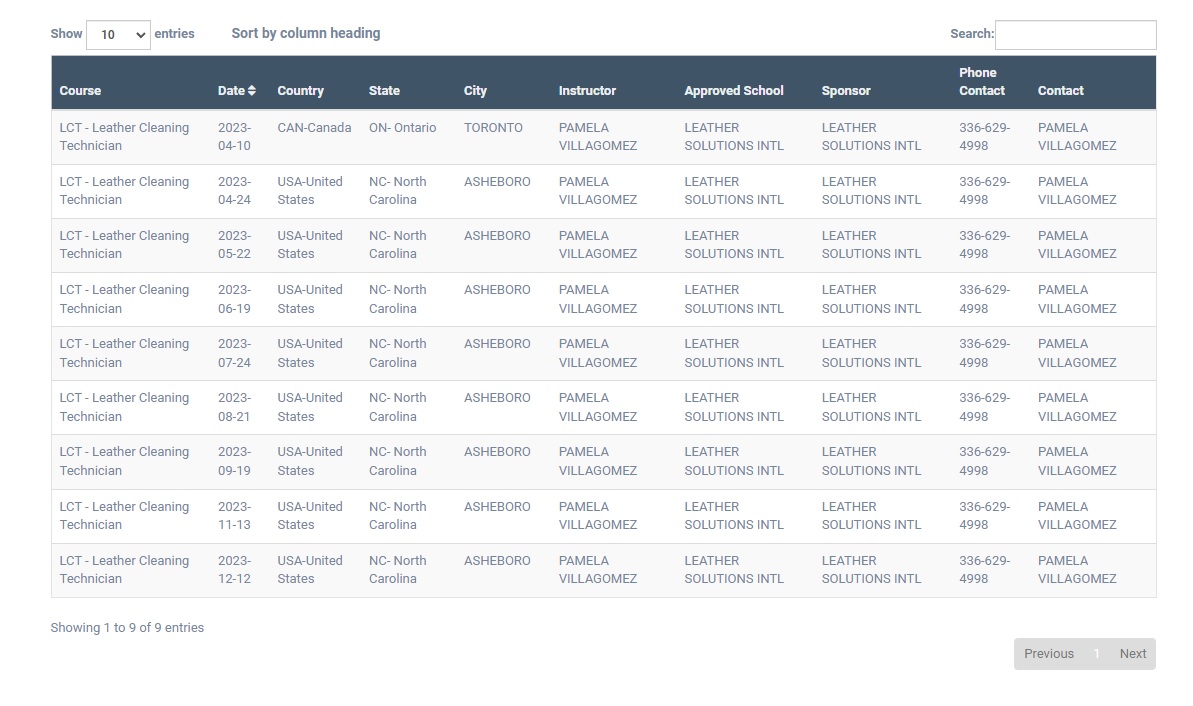

The IICRC has a class that is held about two hours away from you
and the sponsor has other classes

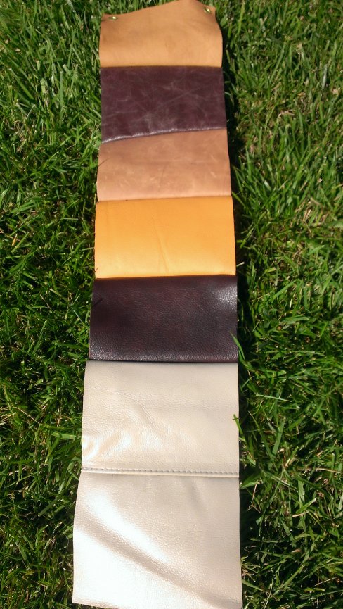

And we are now using Uniters, Leather Master for restoring color to pigment and aniline leathers.
