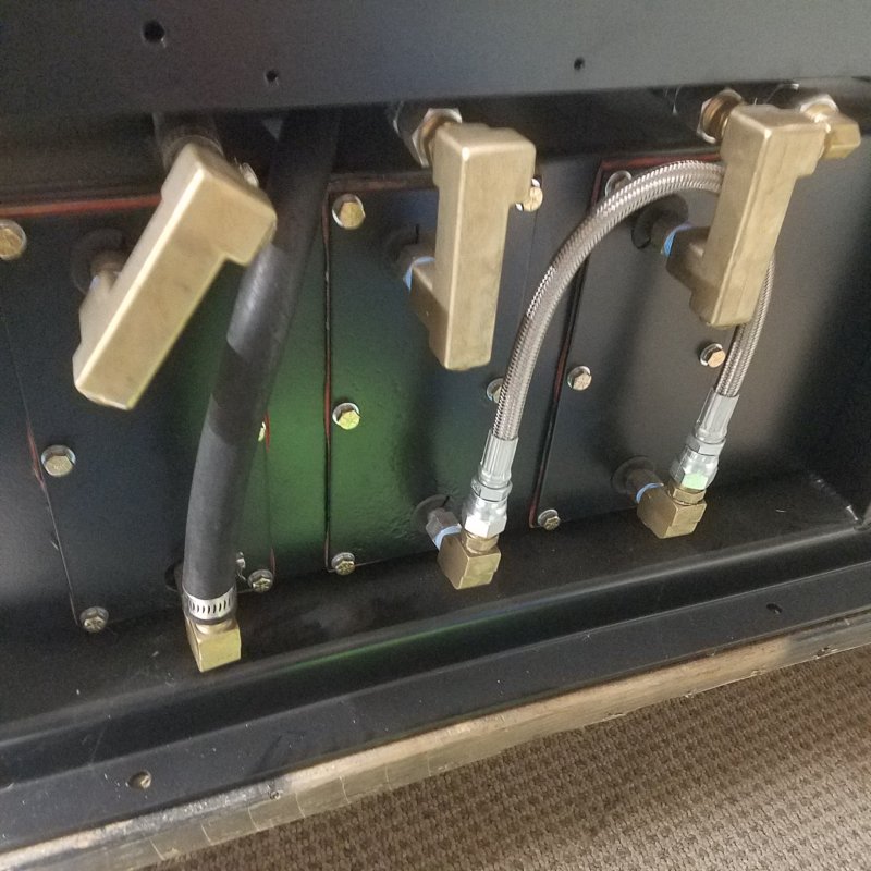

I know his is different, but it's just some compression fittings and hose clamps.. Then unbolt them with the 7/16" socket.

You should pull out something that looks like these..
I have these type also, but I have another one on the other side that is a SS tube kinda looks like my SS Devastator, it is hooked to the exhaust header pipe. I am pretty clear this weekend I think I'm gonna take a shot and attempt to take it out, I know it is coated, I will take pics of the process, may come in handy for some other people

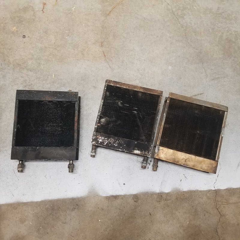

The more before pics the better..:biggrin: I can't wait to see them! They are going to be filthy! You lost real heat a while ago..

I know it is gonna be black inside cause my motor has to be using oil, it isn't bad you never see the white/blue smoke like a car does but I think that may be because hx builds up moisture on the coils when first started...my guess is that the burnt oil has probably just stuck to all the coils, what makes me think this is if I stick my finger into the exhaust port I can get this thick black tar like residue and it is thick so I suspect major build up.
I can go almost my full hours between oil changes without adding oil but still 5200+ hours is a long freaking time.
I looked at my manual and it LOOKS like the way to do it is to PULL the blower and slide the HX system out towards the back of the unit. Pics will come, wish me luck.

Well guys my cat is toast, for some dam reason this phone won't upload pics right to MB keeps on saying file to big??
My coils are black full of soot gonna take it to carwash and blast the heavy soot off

No cat as in catalytic converter for my heat exchanger it is completely blown out all throughout the heat exchanger coils is parts of the catalytic converter and the coils are coated in thick black soot

Holy cow 20 bucks and a gallon of degreaser to get this thing clean
