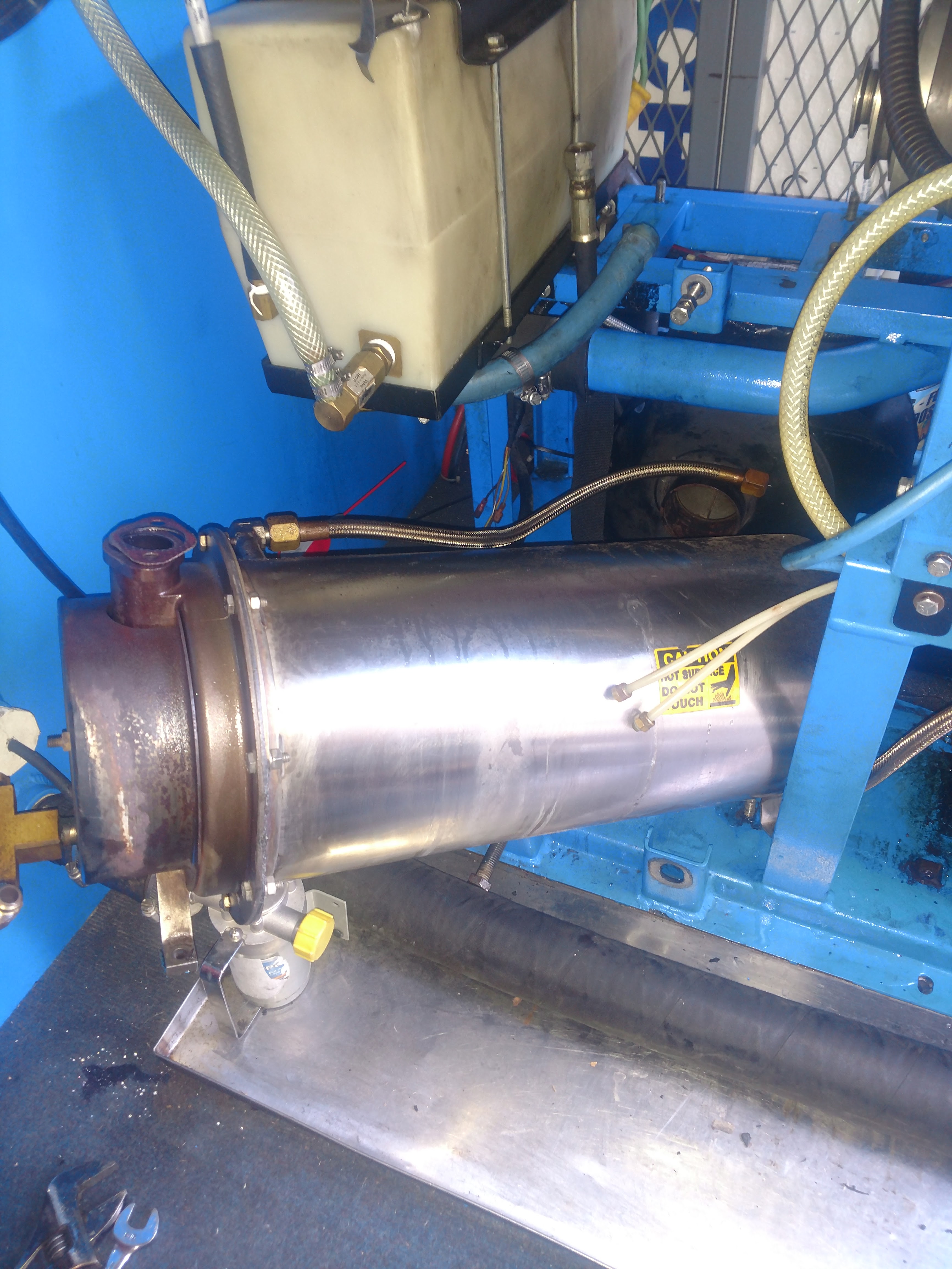

This is after 20.00 in quarters and a gallon of degreaser

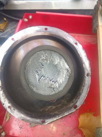

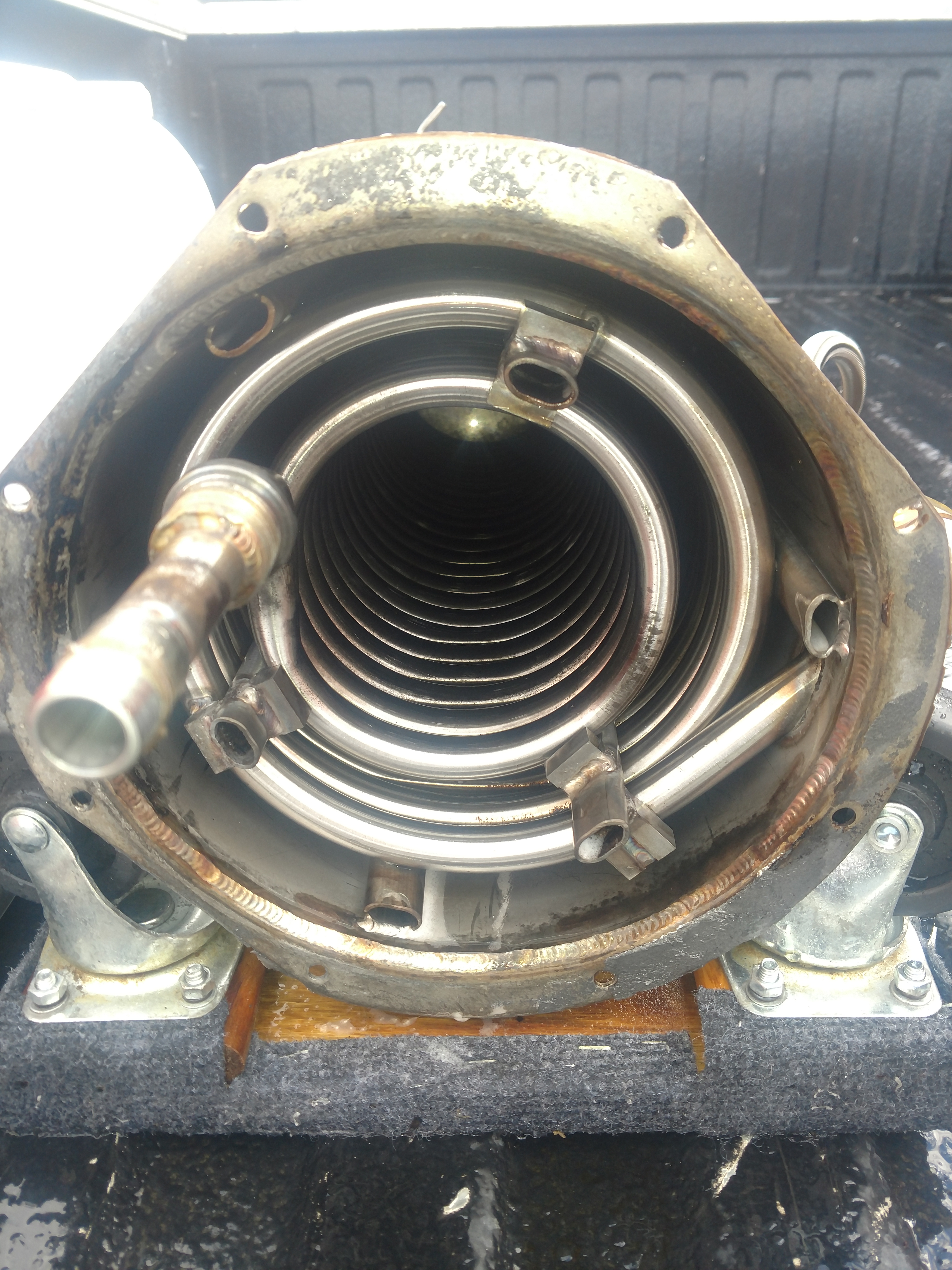

So this is how it went
1 removed water pump, not necessarily but needed to change oil and having it completely out of the way was better.
2 removed blower completely the reason for this is the whole HX system has to slide out through the back and the flipping bolts to the HX diverter are very hard to get to.
Unbolted the HX diverter from HX, removed the HX hose up by the unloader manifold, removed the HX hose from the back of the HX. Remove the 4 7/16 bolts from the HX feet....slide the whole unit out the back where blower would sit

The biggest problem on that coupler for me, was getting it into the perfect position to keep an air tight connection between the two. Getting it off wasn't that big of a problem.
The biggest problem for me on removing the heat exchanger was disconnecting the engine's exhaust pipe from the heat exchanger. I lost my temper and used a hacksaw on it, and just hired a welder to reconnect it. I'm sure the person who bought that tm was wondering about that weld spot if they saw it
As for the coils...I removed my coils to inspect it at 3000hrs, and they looked great. So for anyone with that amount of hours is losing heat, I suggest looking at the preheater on it first before going through the headache of what you just did.
