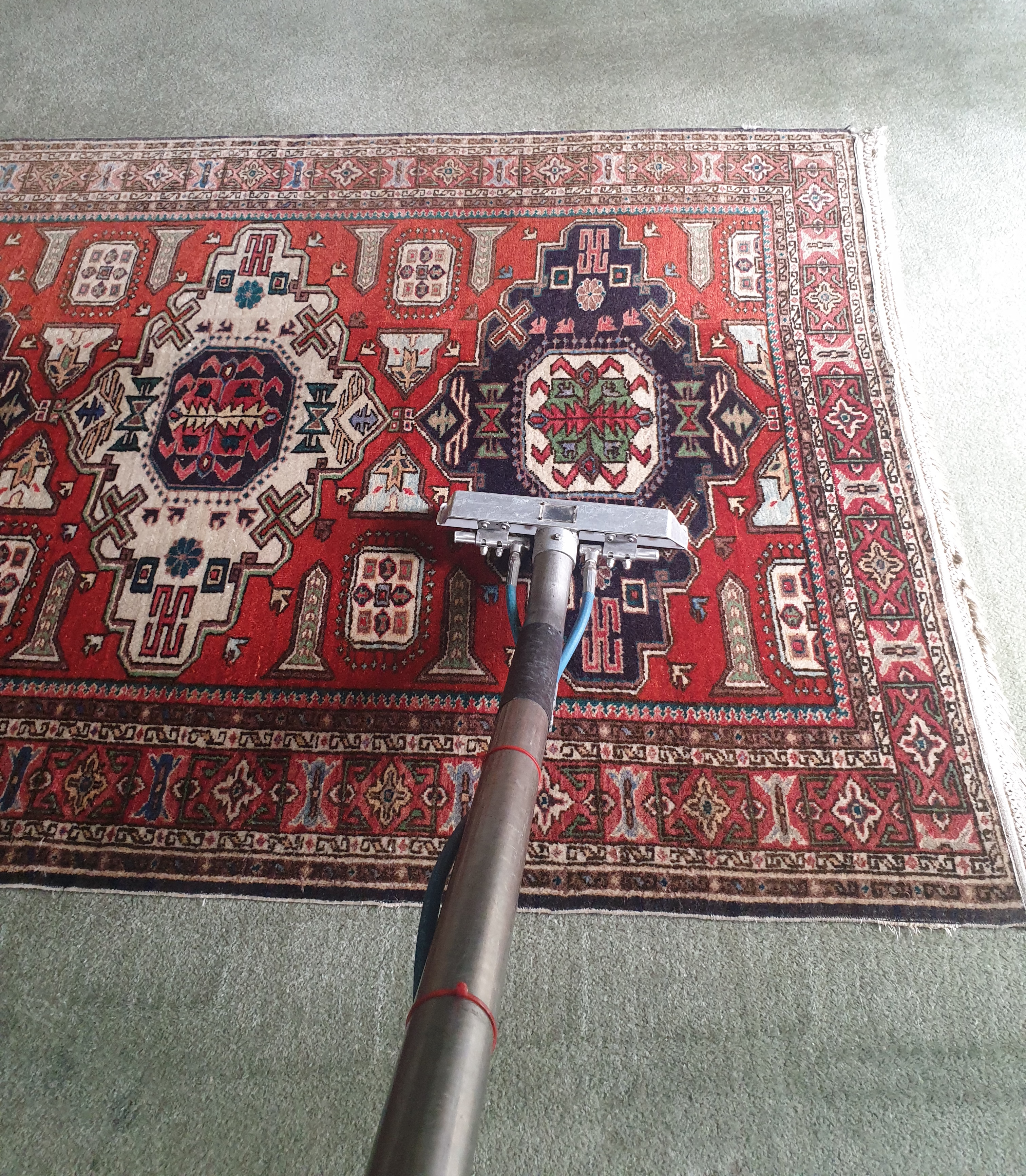

High value area rugs, including handmade “oriental rugs” made of wool or silk, are always best cleaned in plant. Cleaning in plant is more thorough, and far safer than cleaning these on location.

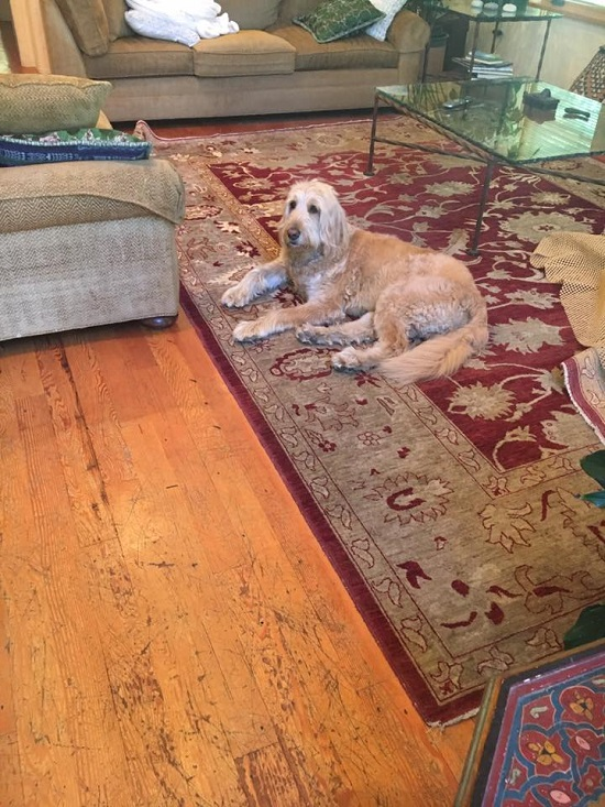

People with low cost rugs may not be willing to pay to have them cleaned in plant, yet the placement of these rugs on potentially sensitive hard floor surfaces (such as hardwood and stone) means that cleaning with hot water extraction could be risky to the floor surface, even if safe on a synthetic fiber rug.
Of an even higher risk would be the cleaning of regenerated cellulose rugs (viscose/tencel/art silk, bamboo silk, etc). These fibers are very moisture sensitive and rugs made from them will often shrink, brown, and experience severe texture damage when cleaned with on location hot water extraction.

I was reading this and I was thinking, "This looks a lot like something Lisa would put out"..... and Bam!
I agree though, wool and orientals should not be cleaned on a driveway.
