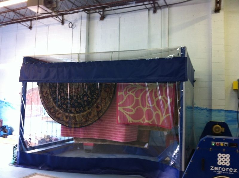

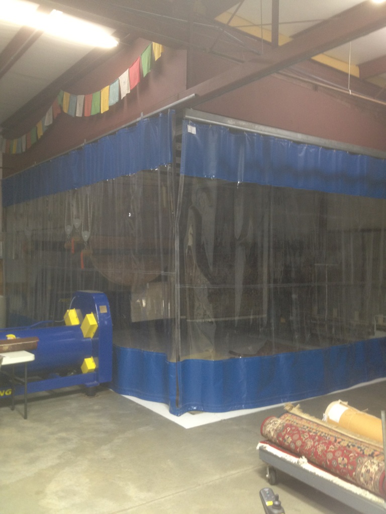

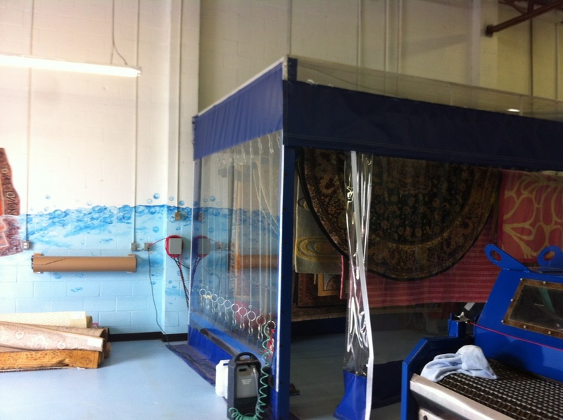

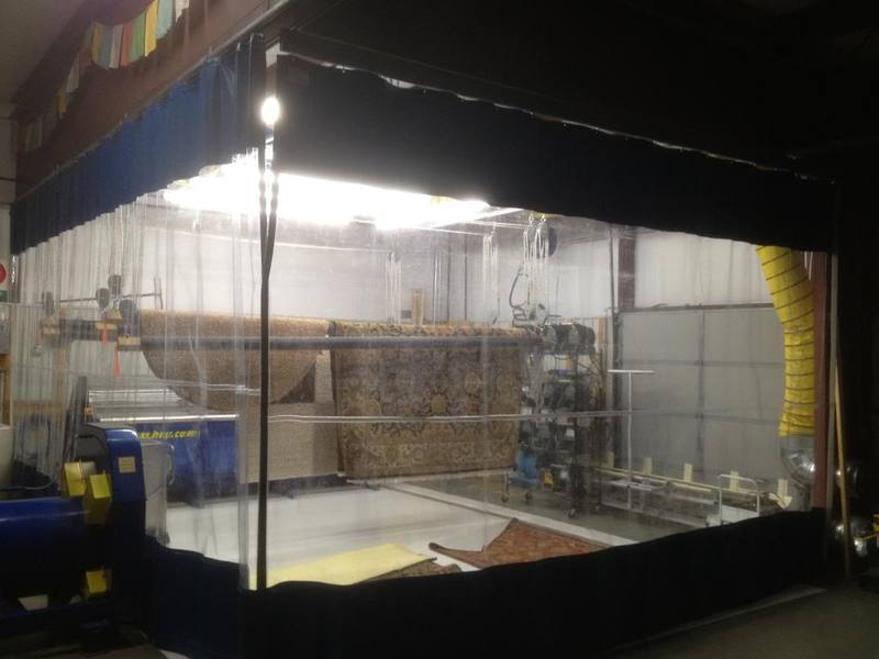

It's fascinating what some guys have come up with to make effective dry rooms for their rug hanging systems. Robert Pettyjohn's rug washing facility displays a great use of space and time. Lots of companies use free standing drying towers like we make, or others as seen here. Yet, instead of dehumidifying the whole shop, Mr. Pettyjohn's water damage drying experience led him to make containment curtains as featured in these pictures. He dries in hours with pumping heat in. High heat makes for a healthy rug too!
Our next Centrum Force Rug Summit will be near Raleigh, NC. Those attending will be able to see his shop with all its cool features.
Here is the same concept from Zerorez in Atlanta:
