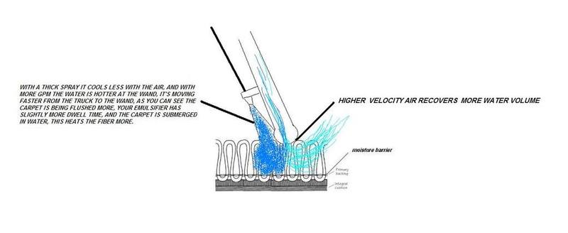

ok, see what you think about this. It's a lot more simple than I was thinking. The fiber will still be hotter from the increased heat on the carpet, and dry faster.
