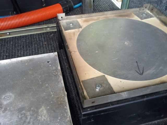

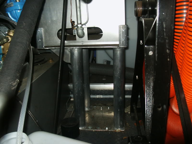

Mike Draper
Jan 13, 2008
4,402
I had my local machine shop make this Little giant stand. Basically its a thick piece of metal with a couple bends in it. Cost $20.00 to have them make it and took less than 10 minutes. It sits about 7" high off the ground. I then had it powder coated. Had my little giant frame duplicated and made out of stainless steel then bolted it to the floor frame. Its solid as can be.
