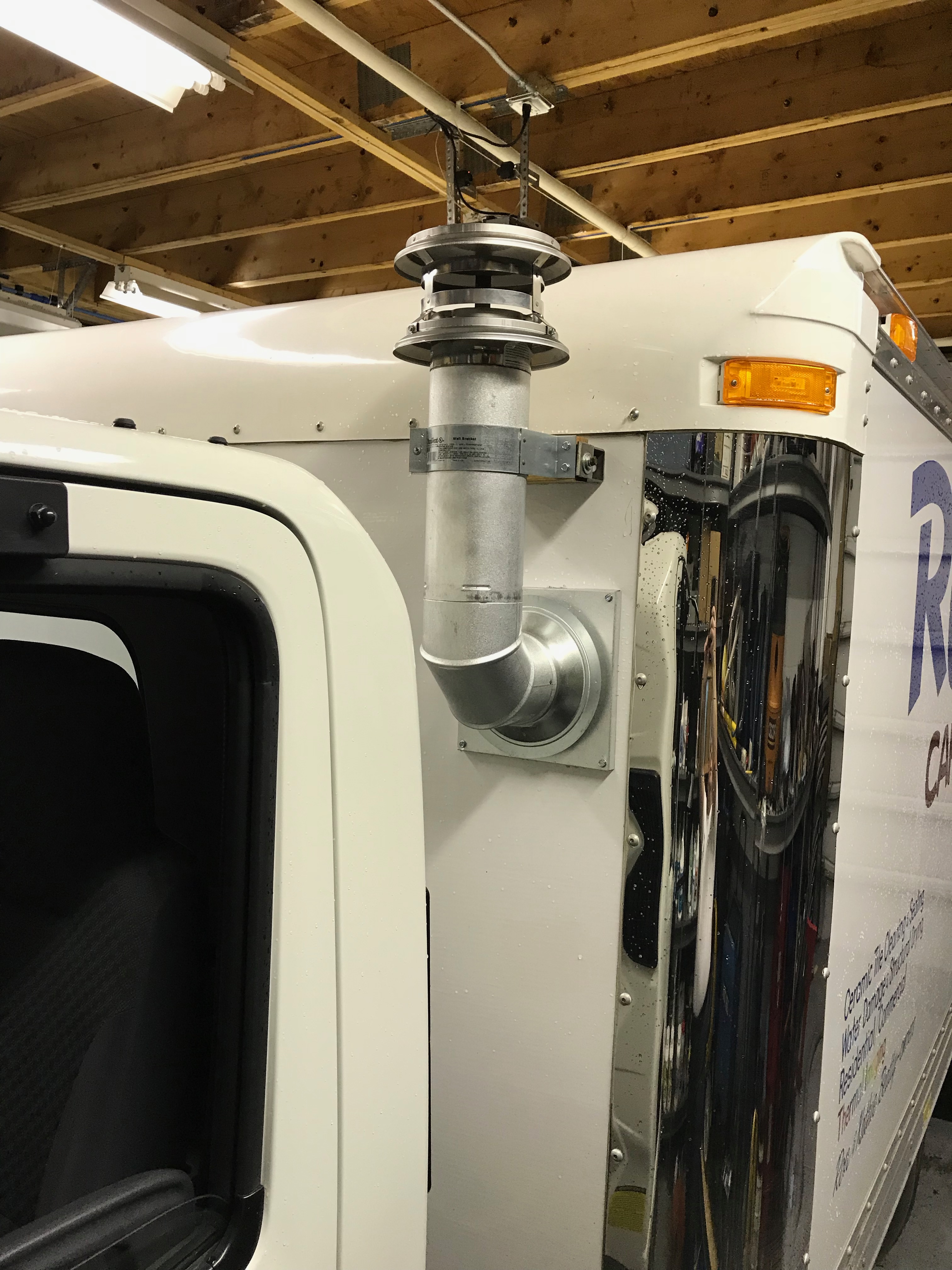

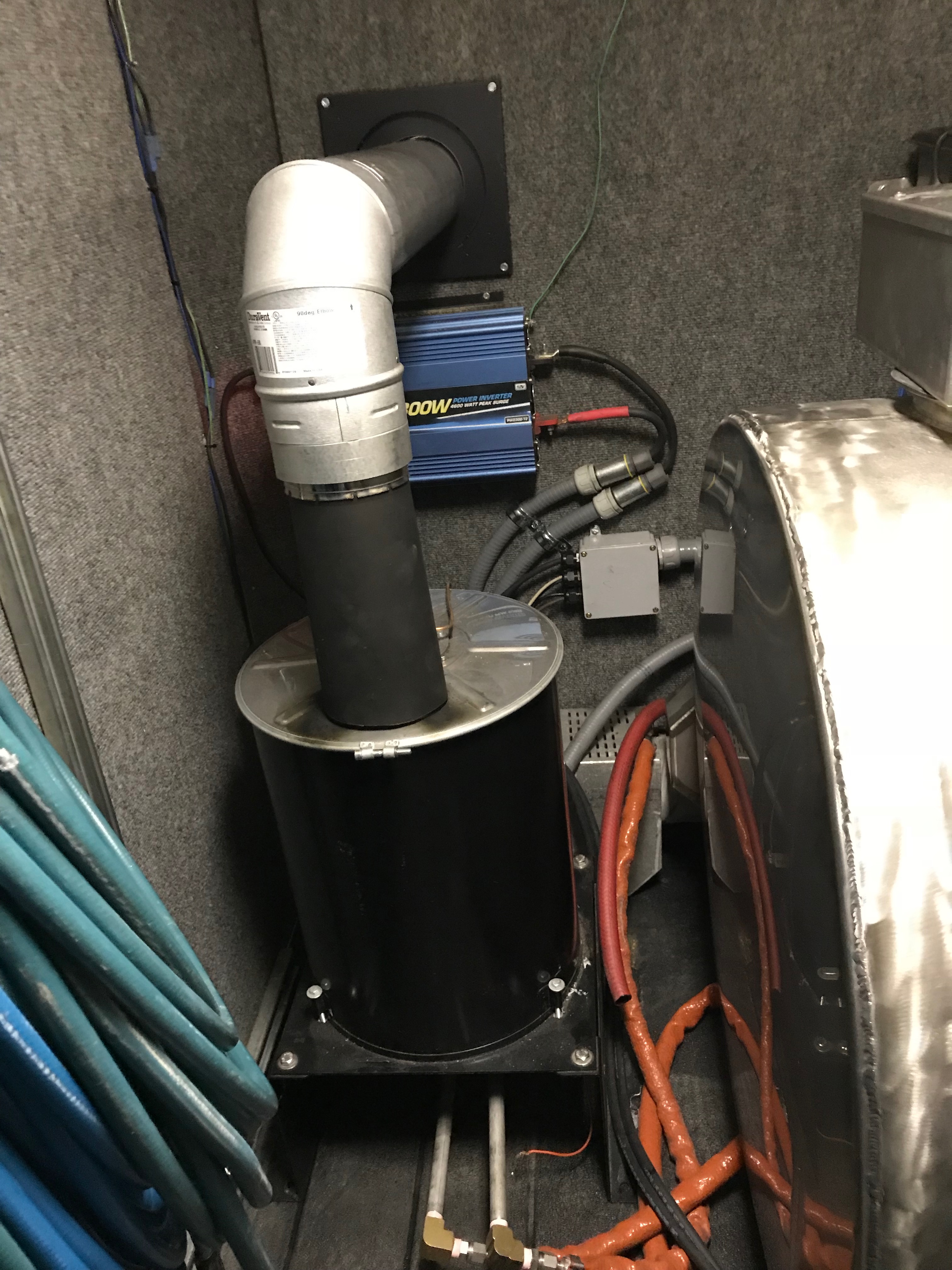

diesel is the way to go, less maintanance, efficient uses easy to acquire and cheap fuel.View attachment 86576View attachment 86577
Diesel is good, but it must be vented outside, which is easier to do in a box truck than it is in a van.
The auto LP only needs 3 amps to run, whereas diesel needs close to 20 amps if I am not mistaken because it is not gravity fed and it has a blower.
Our LP heater will maintain 280º with #12 flow wand. - which is insane and should never be necessary - LP burner ring has 32 #68 burner jets!
