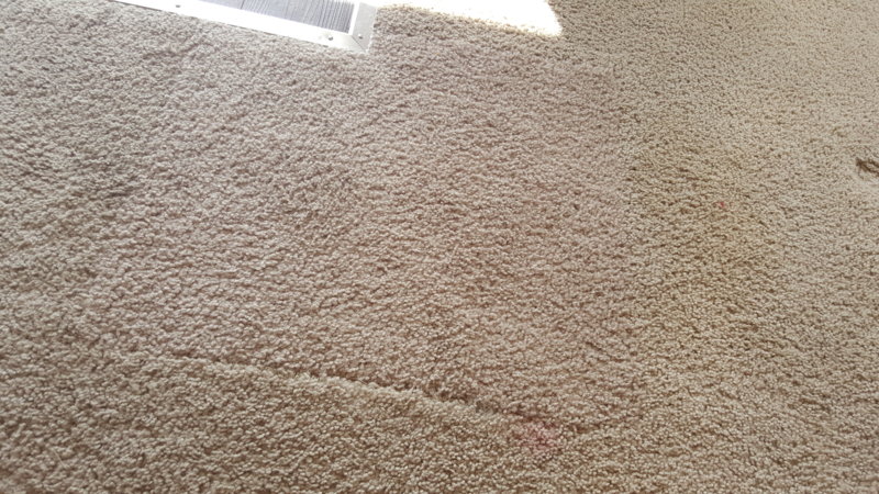

Charged $300 for this repair..
Its like stealing candy from babies..

In all seriousness thought, not all patches are going to look perfect. You only have so much to work with in some situations and it is what it is...
I've done a few that I had a hard time walking away from. :hopeless:

Wow. $300?
I will say that that carpet can be more difficult to repair than carpet with a longer nap. But, I am almost positive that the patch is turned the wrong way. A little straighter of a cut and making sure the tufts weren't tucked under the seam and it would have looked 100% better.
K
Kellie Hiler
I also would've gone further over to get rid of that pink spot.
But it's possible Mike did not have enough carpet to work with?
The nap direction looks good it's just cleaner carpet. That gap is concerning though.
Not sure why you had to use glue @Mikey P? Do you have a Kool Glide?
As long as you give the seam tape ample time (15 minutes max) to cool and set you can clean right over it with no issues. I wouldn't necessarily rotary over it like a beast but a wand would've been fine. But that pink stain is right on the edge of the seam..:eekk:

Its hard to say the condition of the donor piece and maybe he could only run it one way because the slumlord that hired him only gave him that option. I mean, this place had a state inspection tomorrow and we patched it with some piece that didnt match. It was like patching a pissed on turd. Got 3 full canisters just off the living room lol!!
