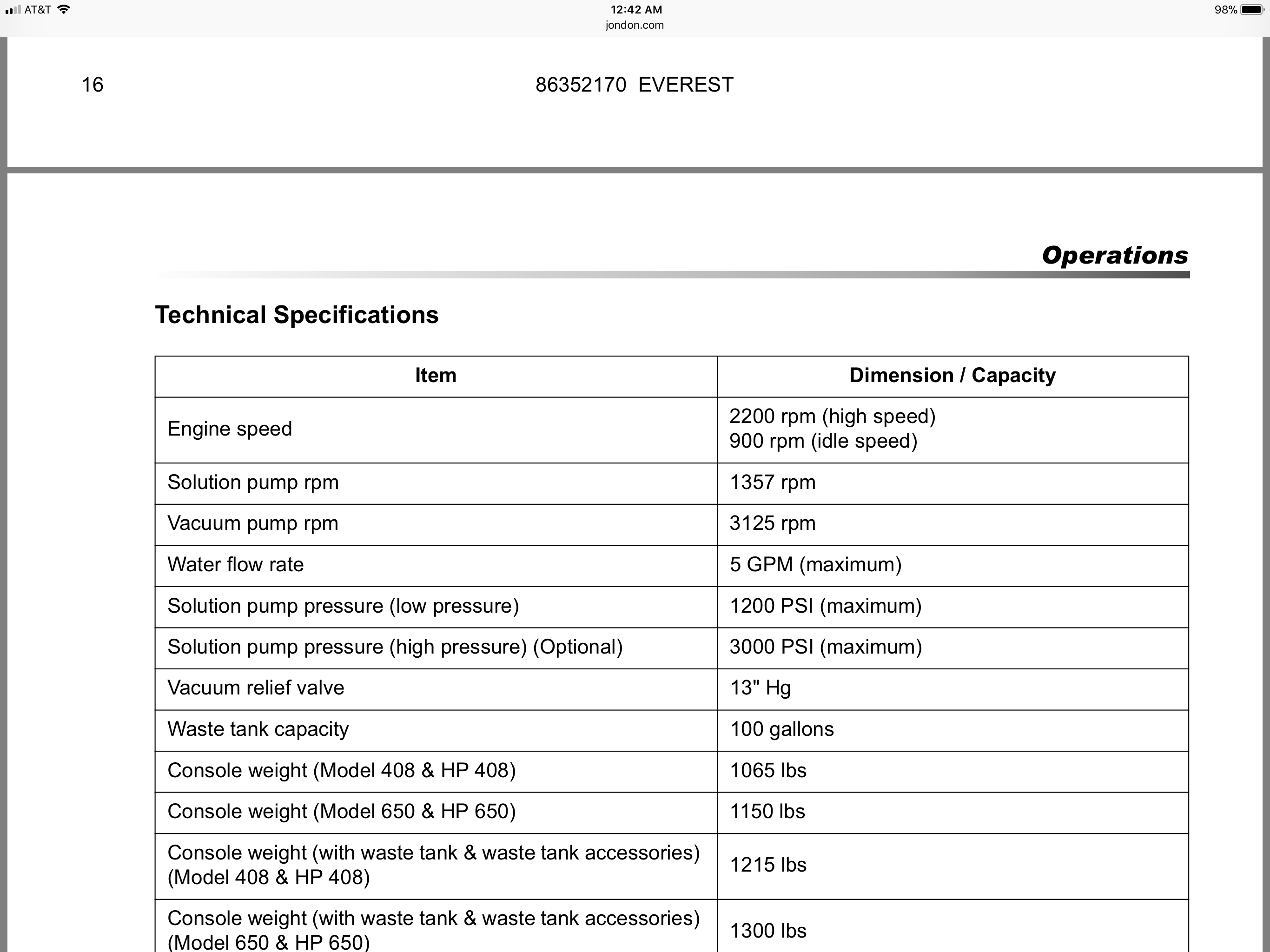

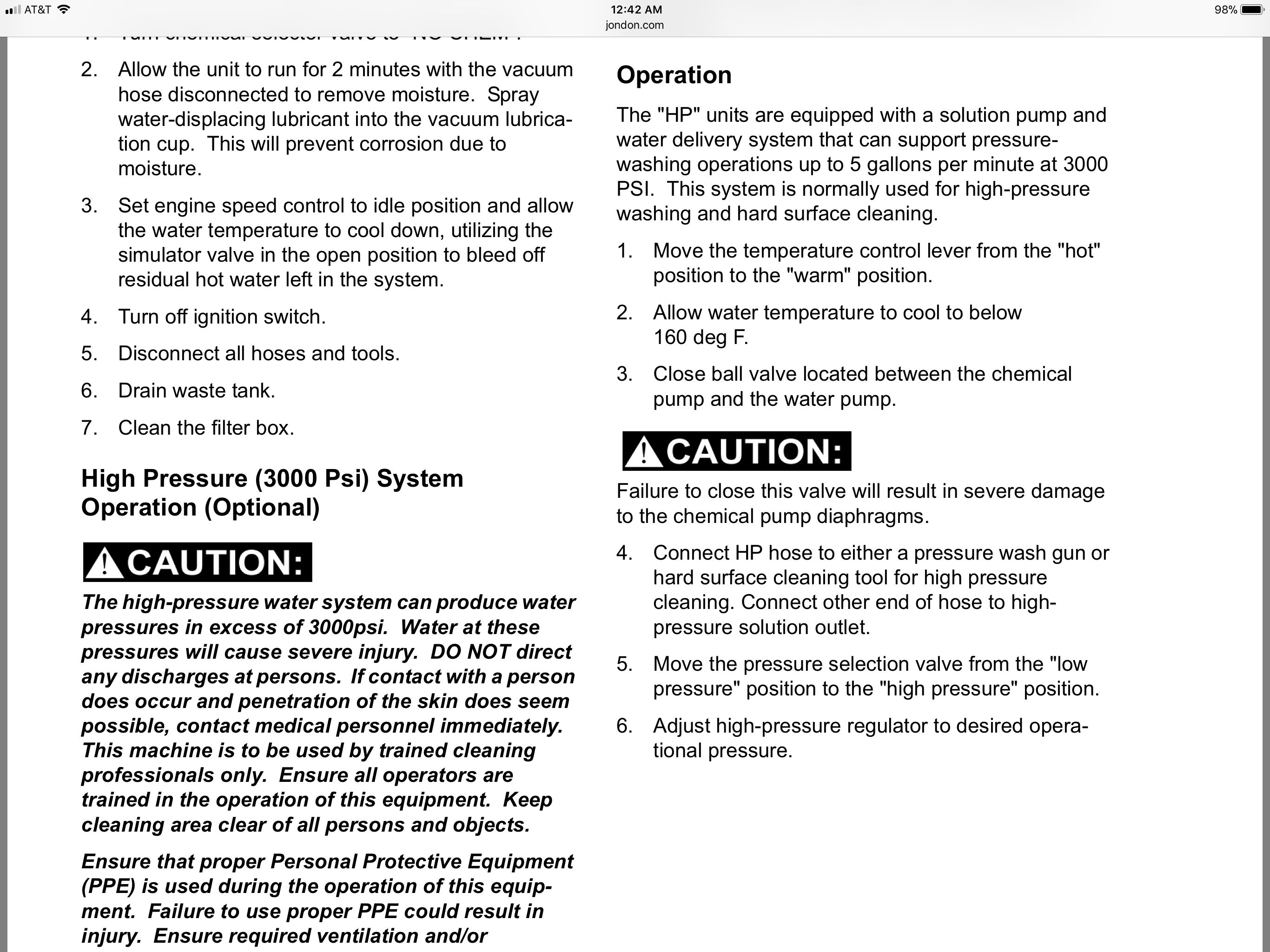

Please let me know if you need any clarification, these are from the Prochem Everest hp manual. You have to bypass the heat exchanger at 1200 psi.

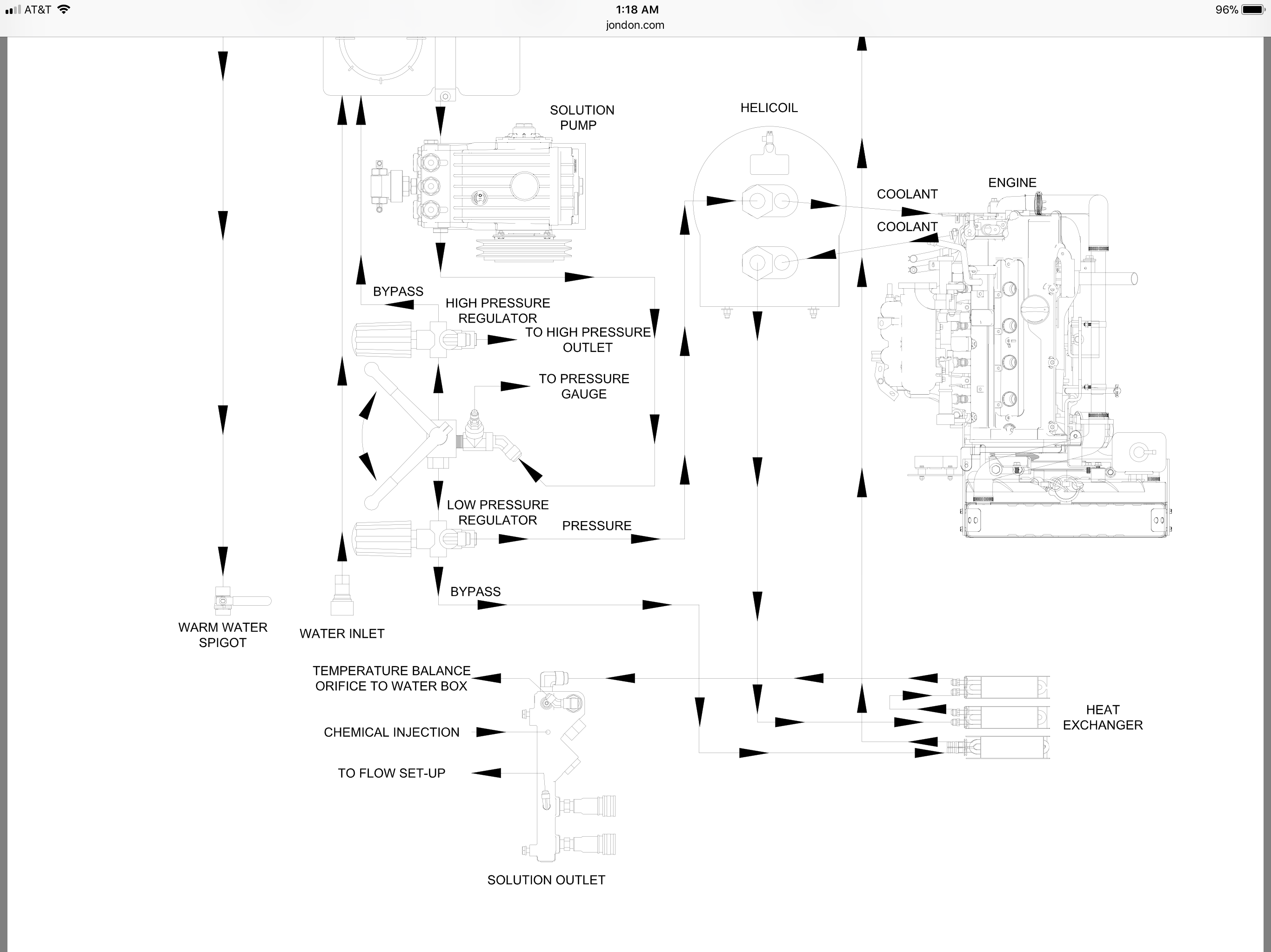

As you can see there is not a heat exchanger in the “high pressure side” of the pressure system as it is diverted and just goes to the panel for service.
