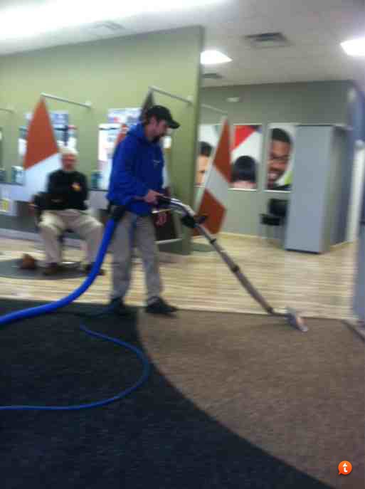

I flushed the crap outta this wit da Roto Rooter 360i, then edged n dry stroked it all w the wand.
45min from arrival to drivin off w some lolly gaggin in between : )
Did that guy who was hawkin' you offer to help drag hose?

You're kind of short too, like me. It looks like that wand is on the long side. Does that bother you on big jobs/long days?

Nah, thats the Owner : )
GreenHorn dot bother me that long. Works well.
