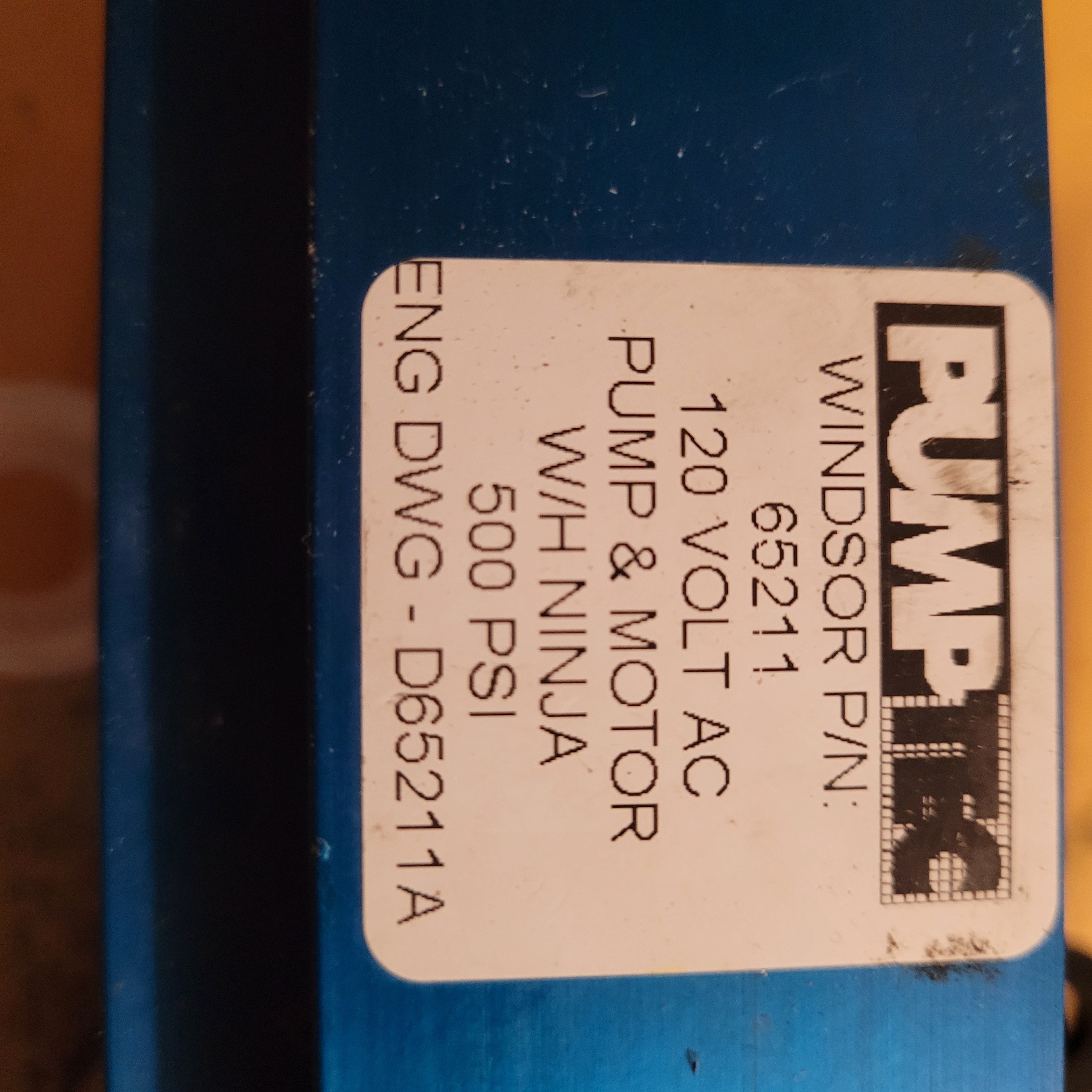

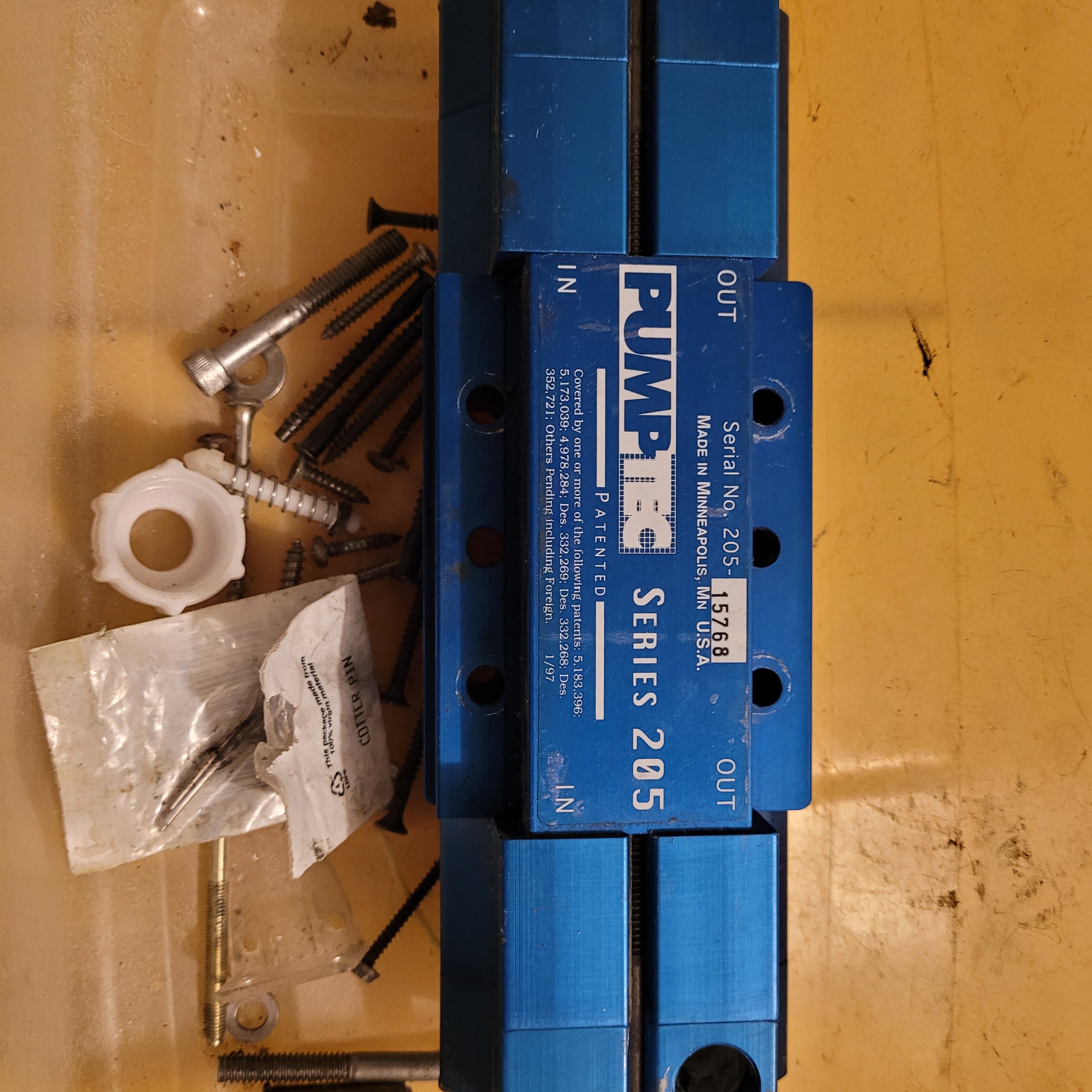

This is a 205 V in the attachment.
Like Clean Response said, you have to talk to us, there is no other way around

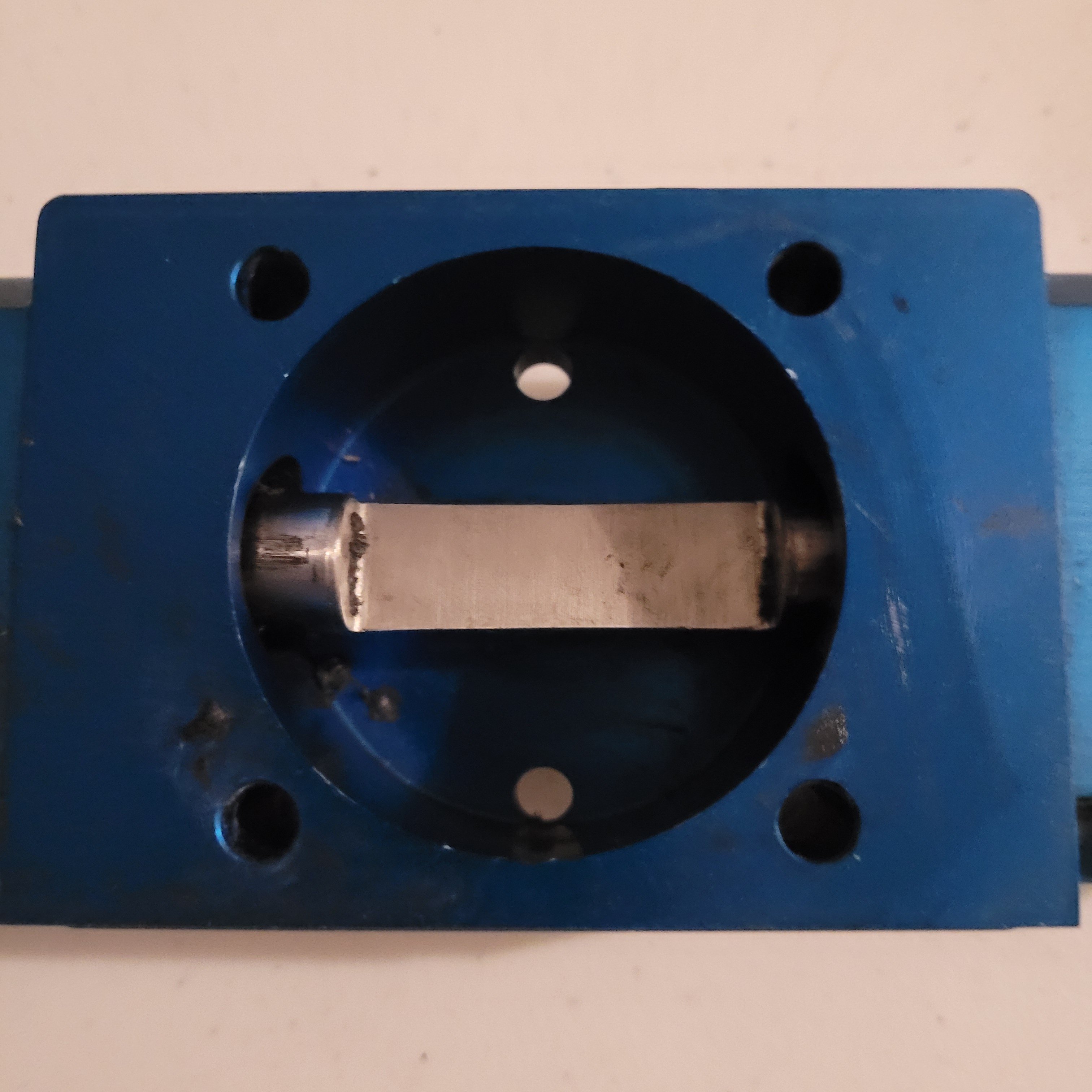

View attachment 123529 View attachment 123530
Here is your" buddy' plunger that creates all the pressure.
You're not going to be smarter by reading all the responses. You have to start the process of elimination. Why don't you start with wiring, check for the leaks of pressure hoses, and disassemble the pressure regulator (the bullet's seal may be broken or it's worn out. Fill the porty with water, turn it on, and record the sound of it. We might be able to diagnose the problem by the sound of the pump. Usually nice muffled sound means seals are fine, if it's running kind of rough, with a lot of friction, and screeching noise, it means worn-out seals and O-rings. It's all a guessing game before you take a look inside.
