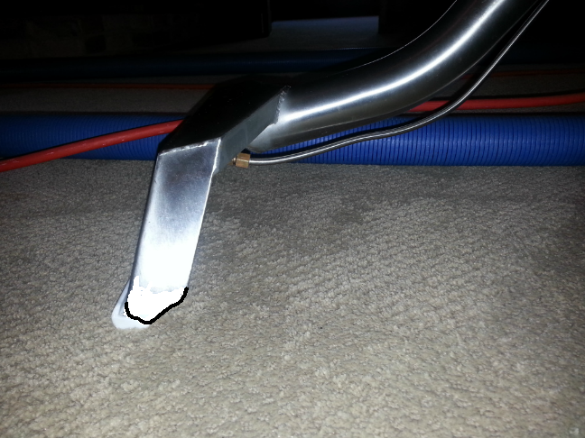

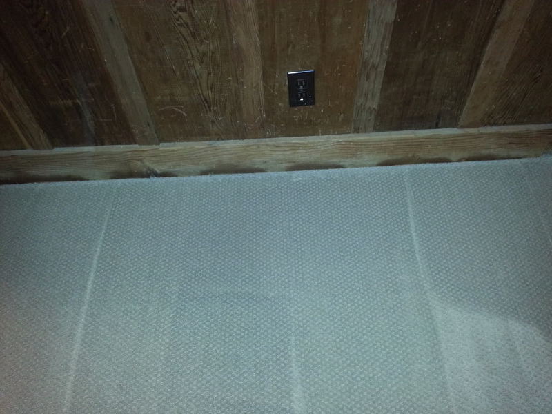

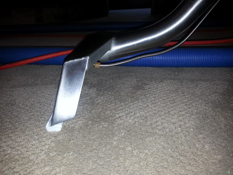

Problem is, most if not all metal wand wings/spray guards are not designed to be used with a glide. With out a glide the wings are flush with the carpet surface. Add a Glide an not the wing is at least a half inch off the tips of the carpet fibers allowing water to escape. Our first job had raw wood base boards and both the Ti and BB were soaking them...
Now if the wing was shaped like this the (slight) overspray would be prevented..

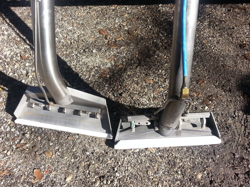

BB and PC TI side by side..
Over all for $500 its a super sturdy wand that would really kick ass on carpets that lighter wands hop skip and jump on or really any carpet that a HE man is willing to use a wind of this heft on.

I don't know, looking at that last pic, maybe there is room for the shorter check valves from WestPak.
the wet base board pics was with the wand going head into the boards and not along side, which was even worse... But they dried up with no damage within minutes.
