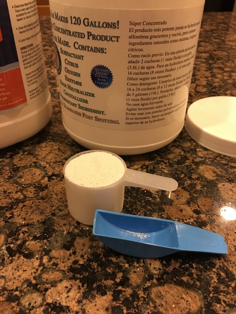

I've been using this in pet situations light to moderate soiling. Nicer nylons.
It's seams kinda of pricy at first but like Judson slop and gobble just a dap will do.
This is a 8 lbs jar of 2x concentrate it comes with the little blue scoop.
5 of those scoops equal one scoop that came with the flex.
When we do pet jobs, small dog urine spots and stains we'll take 5 to 6 blue scoops in a 4-1 hydro force
Mix with 150 degree water and add 5-10 oz of kill odor plus.
Today I did a job half trashed green half mix above.
You could still smell the urine in the area without the greases eater when fans are running.
The Grease Eater Kill odor plus combo drop an Airpath if you saturate and use a black light get rid of the problem 99% of the time.
It's loaded with enzymes oxy and delimonene its a good every day pre spray.
I carry some other stuff for trashed carpets. But this we use for pet jobs and customers are happy.
I would use 4-5 of white scoops of flex in a 4-1 sprayer only one scoop of the Grease Eater.
Ps the products aren't comparable and don't replace each other each has they're place.
