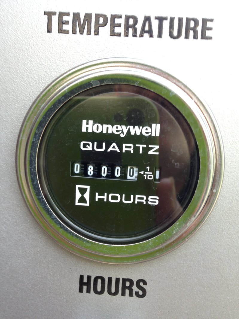

800 hours now? Should be a good year!
798 to be exact. we clean year round. install date was 6-22-15.
