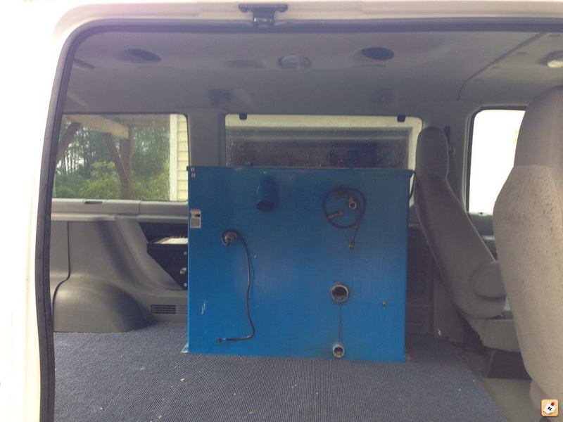

The machine is on my garage floor, so it will be a challenge getting it into the van.

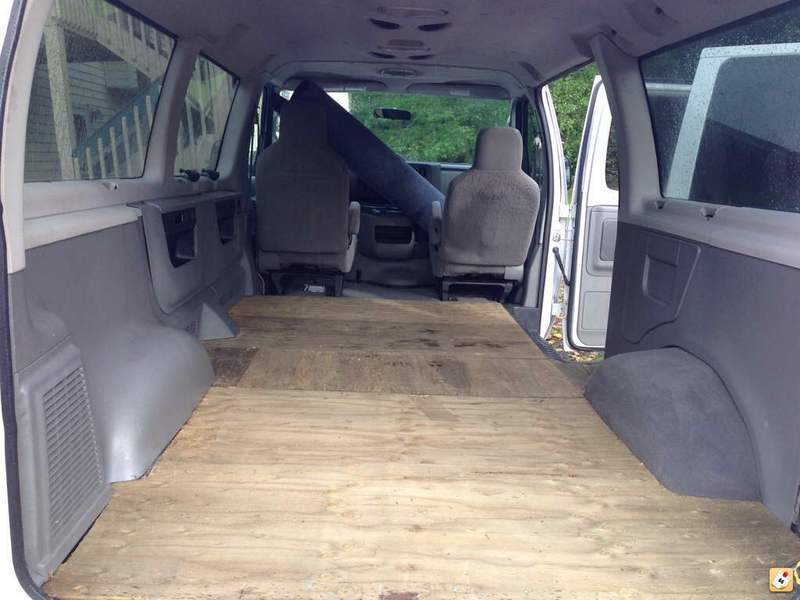

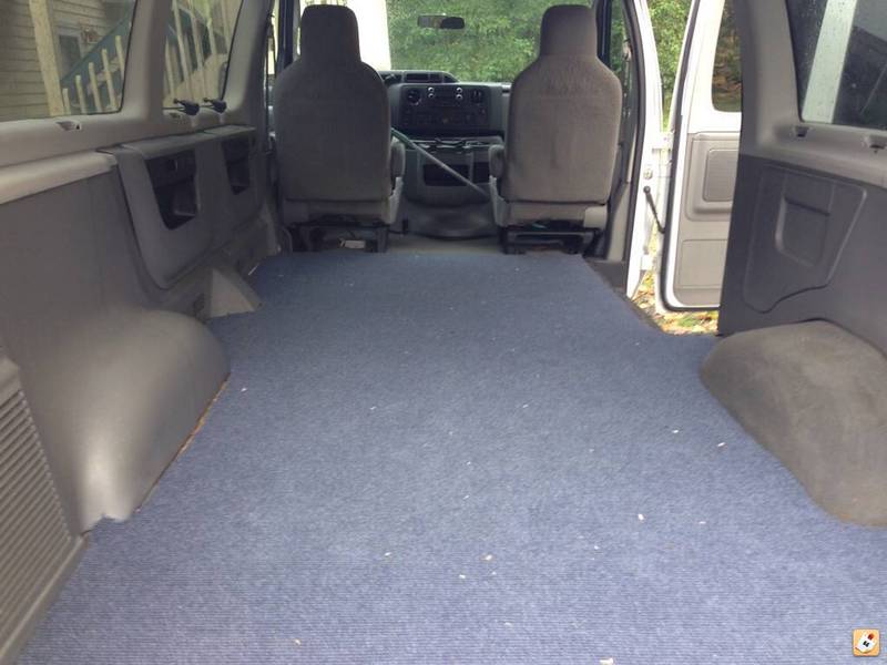

This will be the 4th van I've went with outdoor ply wood, ( marine grade ) with carpet.
I keep thinks clean and leak free. Works for me..

Fork Lift for me. My machine is too tall for a cherry picker. Only an inch or two above the machine through the door.

Pretty sure I'll go with a fork lift.. Like above, I don't think I'll have the clearance for a cherry picker.
Hoping to have it installed by the weekend.

Outdoor carpet glue. Notched trowel.. Quick and easy, still holding strong in my 06, I use marine grade plywood. It holds up.

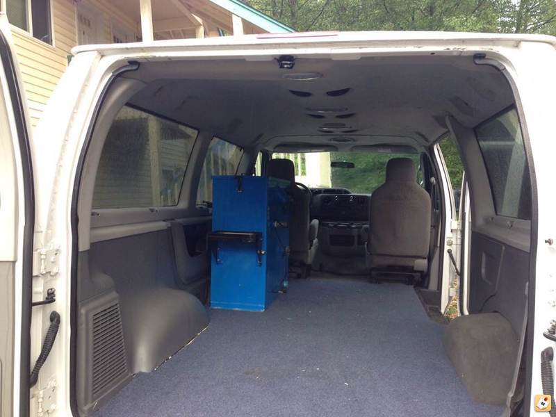

Today I trimmed out the interior behind the waste tank, earning me a couple extra inches side to side.
My 405 should fit nicely.
Then the question, do I want an employee to drive newer van and older 405?
Or the older van with the newer thermal wave?
Thinking I will start with the more reliable thermal wave as the employee's wheels.
I can personally trouble shoot the 405 if problems arise, and I'm a skilled talker if I must communicate issues with the client.

Carpet on the floor is great, Beck! Mine got lined, then bubble foil(insulation), marine mdo/plywood, then outdoor carpet. I put the bubble foil on all the walls and roof. It's cold here!
