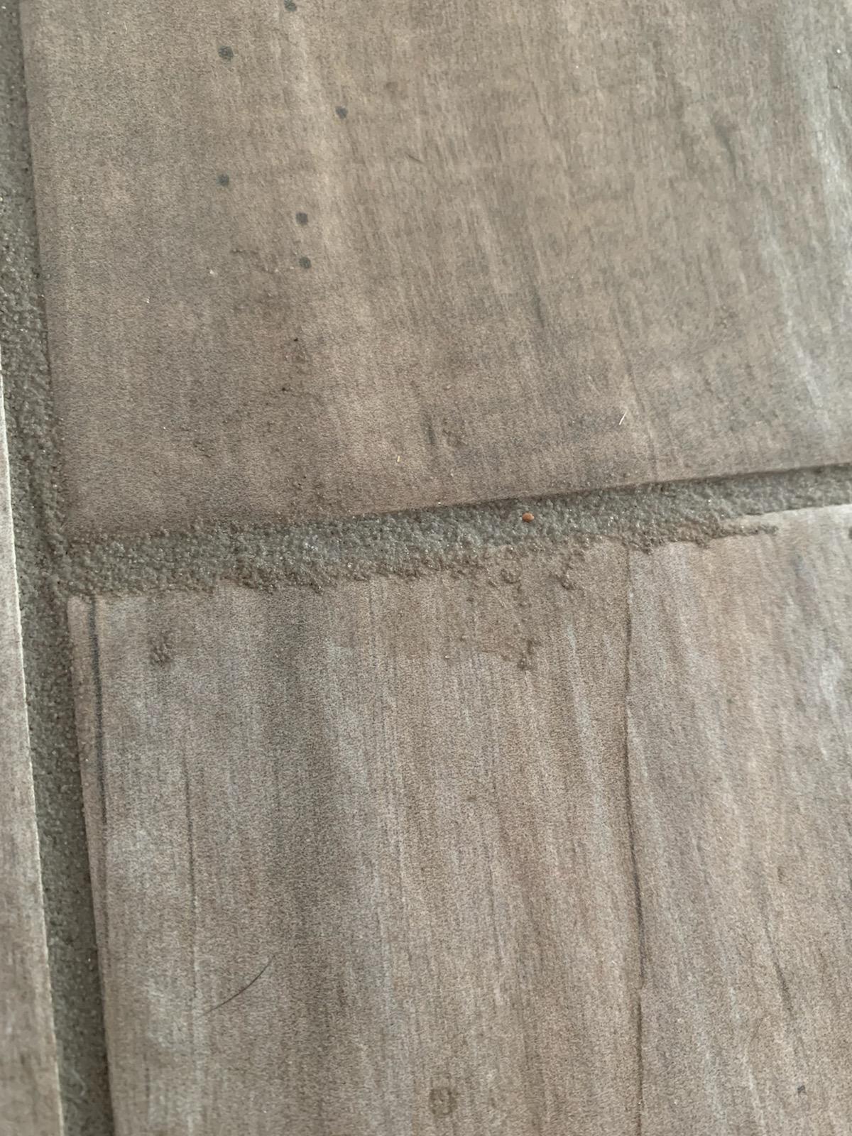

does anyone have any experience with getting this stuff off I'll get more pictures soon but she says it's all over the floor this is one example she gave me of it just overflowing out of the grout line..

I am assuming that it has at least dried if not cured. In trying to remove that grout on that tile, the coloring on that tile may come off. It is a weathered woodgrain tile correct?

I walked away from a job where the homeowner had tried to grout their own porcelain after paying a pro to "just install the tiles, ill grout it".. idiot trying to save money
He grouted the new bathroom floor using way too much and left lumps of grout to dry all over the place.. I came and looked at it several days later and it was literally concrete at that point. You would never get it off without lots of scraping and destroying the tile
