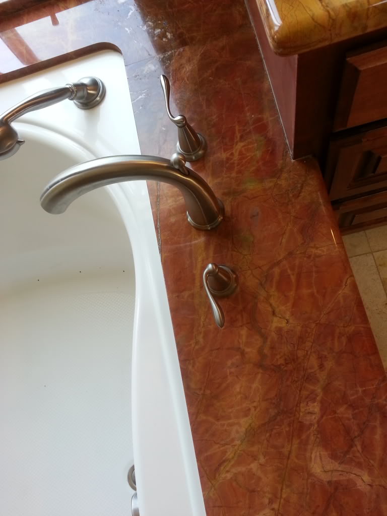

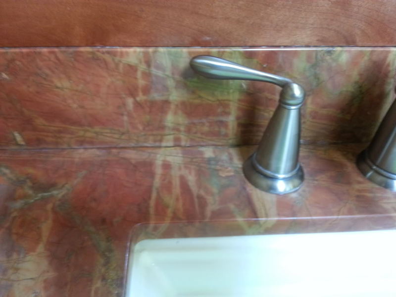

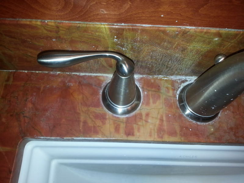

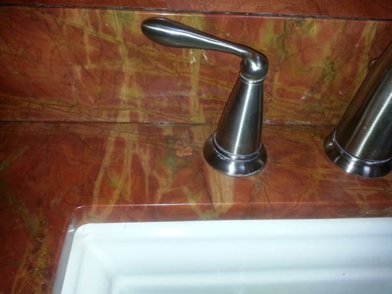

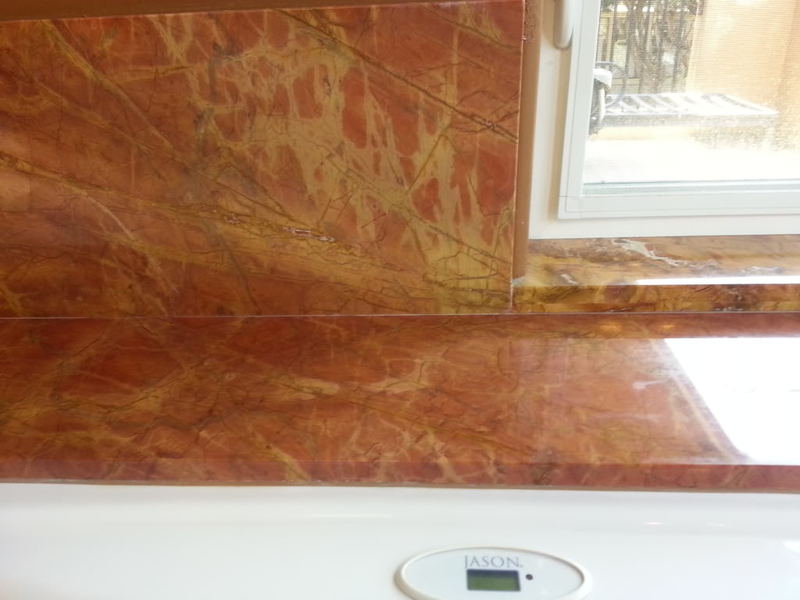

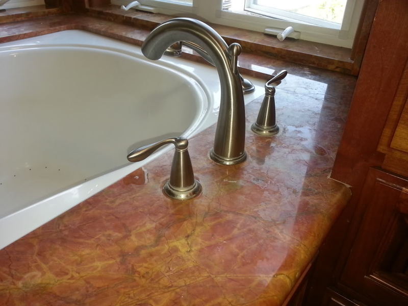

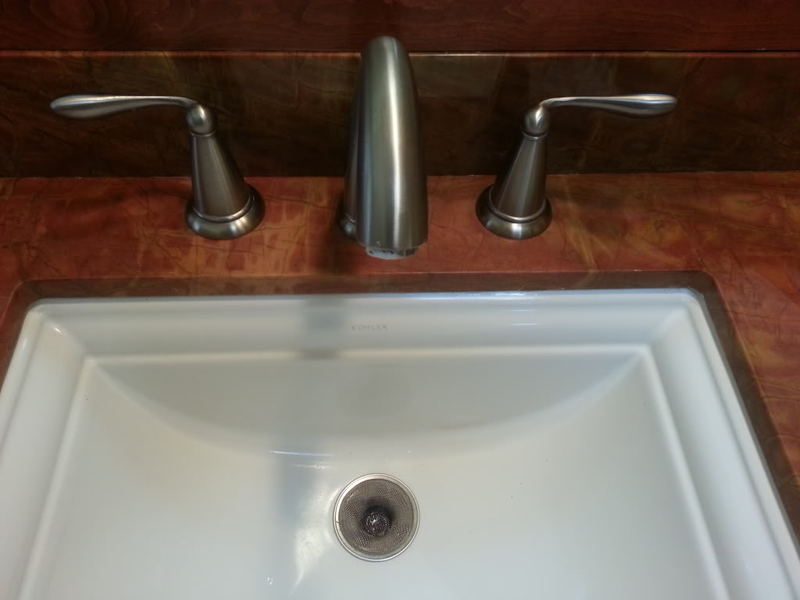

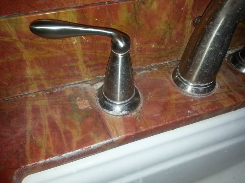

Just Stone Scrub, a Red pad and Cobbs enhancer.
BEFORES..
other sink
AFTERS
This area was covered in build up
ridiculous counters for a messy family of five with zero housekeeping skills and no budget or desire for real polishing...
We also cleaned their shower, regrouted the wall/floor joint and cleaned and sealed the travertine floor
Still $2100 worth of work to be done there.
