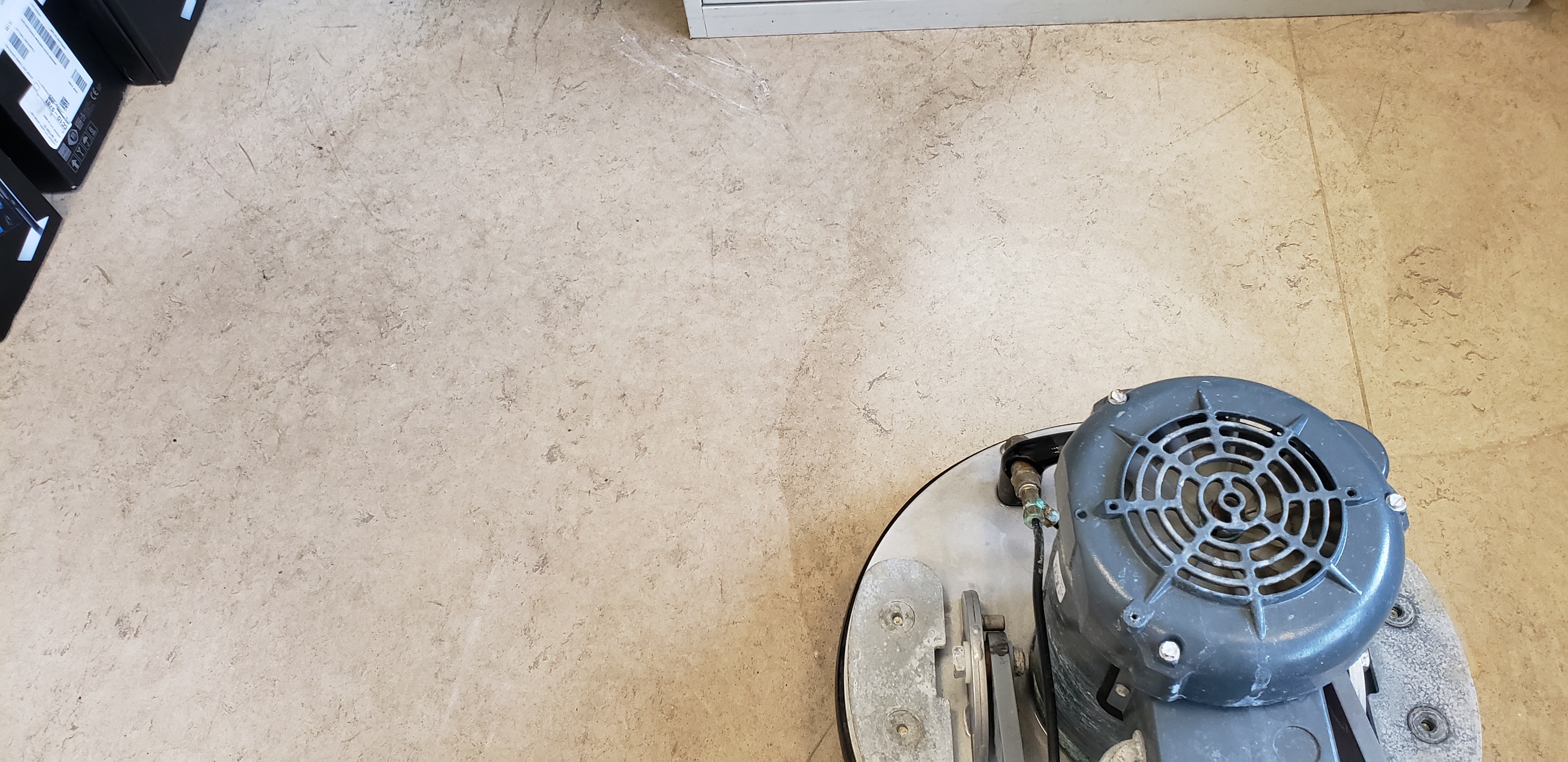

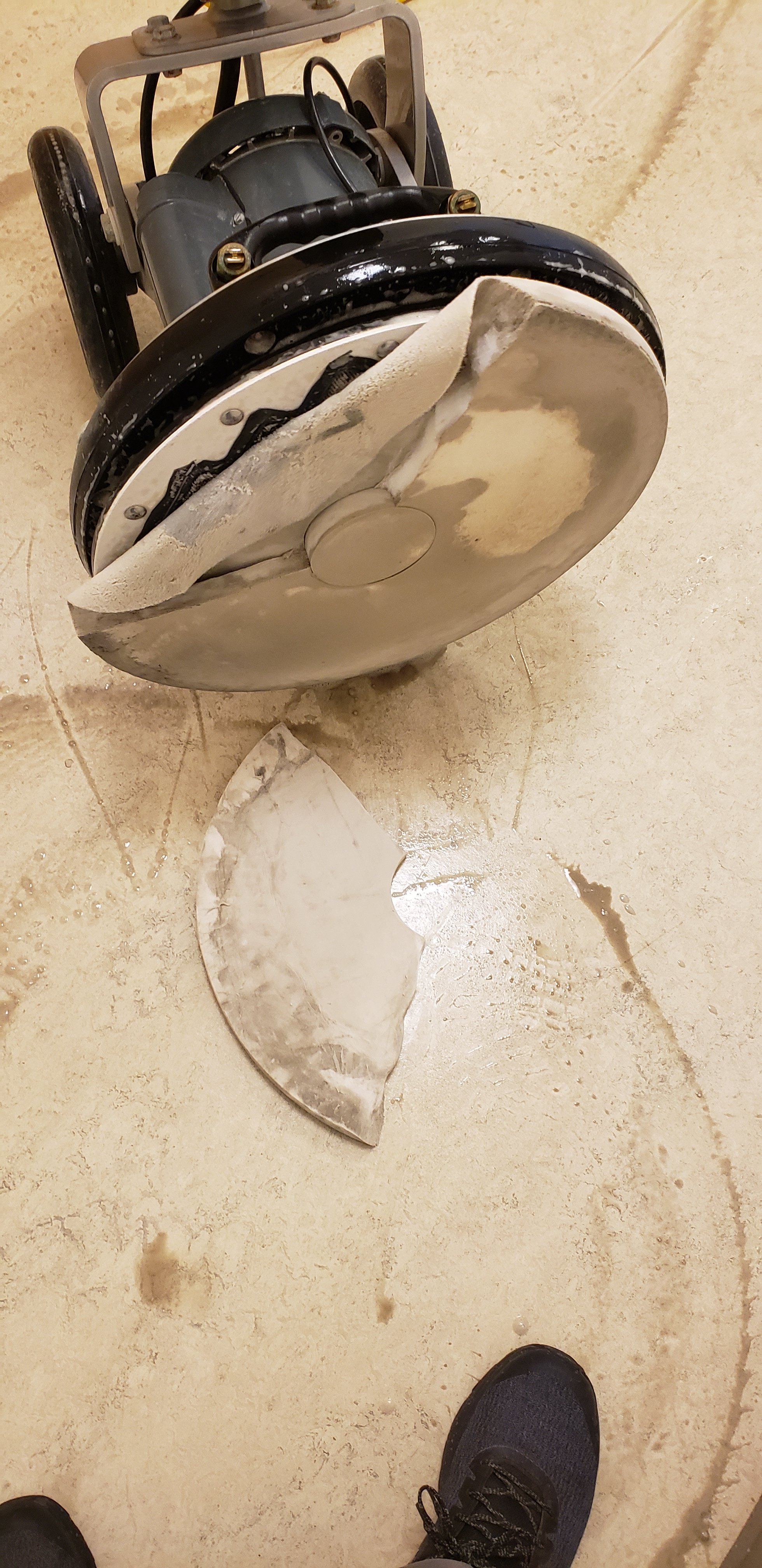

I use these pads on marmoleum. I acquired this account recently and the floors were horribly damaged and neglected after less than 10 yrs of use. Marmoleum is damaged by stripper, I tried a portion and burned it. The orbot eraser pads worked great to suck the dirt out of the wax and damaged spots.
