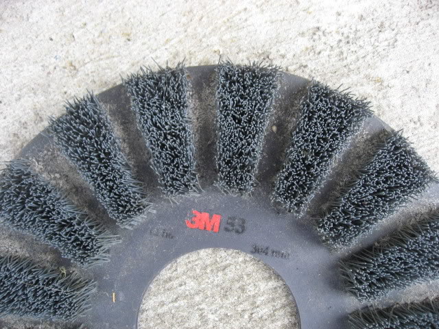

Here are some pics of the brushes we use. I meant to do this a long time ago for you Mikey..
This is the segmented brush for cleaning tile and grout.
Here is a close up that helps explain why it works for grout.

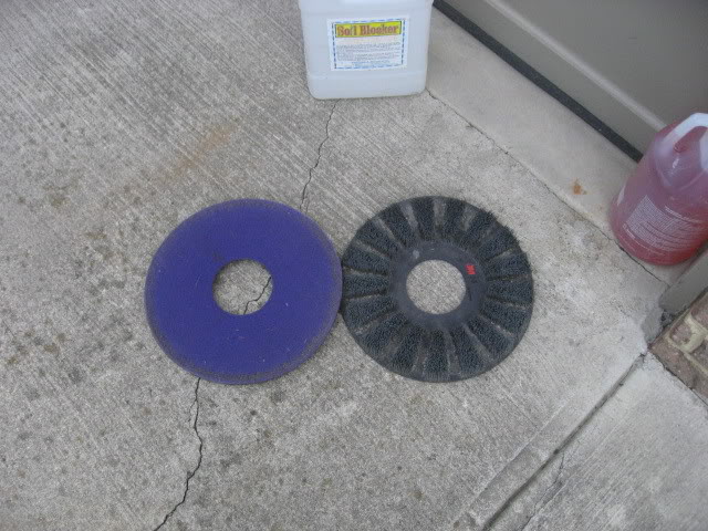

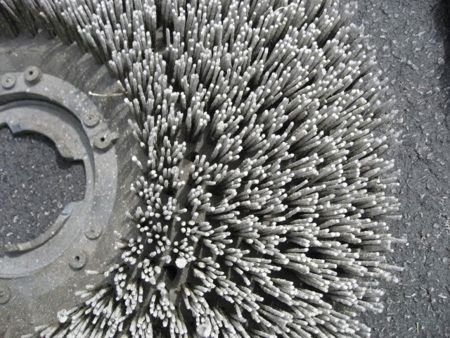

This is the aggressive magnagrit brush we use for stripping. It will work on tile and grout, but can make a mess AND can do damage to softer tile.

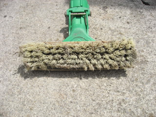

This is the Unger deck brush. I'll post pics of the new one as soon as I get it. This one is worn out.. My guys would use this on some accounts years ago instead of dragging in the rotary.

We don't. With experience we just don't splash a lot of stuff. The stripping brush slings less than a pad does while stripping vct. The grout brush can sling some if it hits something just right, but it is not usually a problem. It is mainly in the technique.

Wow, those might just pull that damn wax out of the grout.
That magnagrit would have worked on some concrete we just stripped and sealed.

The gaps between the rows of bristles allow them to get down into the grout. But you already knew that.. :roll:

Yeah that's what I used on the waxed ceramic yesterday. Worked like a charm. Thanks for the tip.

I've been eyeballing those segmented brushes for grout on Cobb's website but scared to shell out the $200+ for one if it didn't work.
Thanks for the feedback.

Bryan, we use the 53, which is soft enough to scrub most any sheet vinyl but aggressive enough to scrub grout. We have them for swing machines and the auto scrubber.

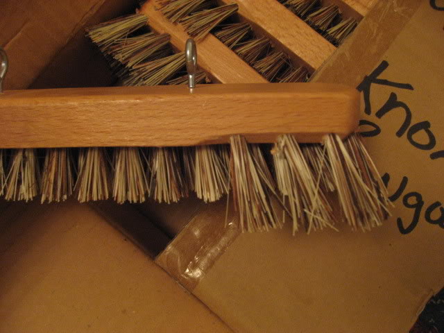

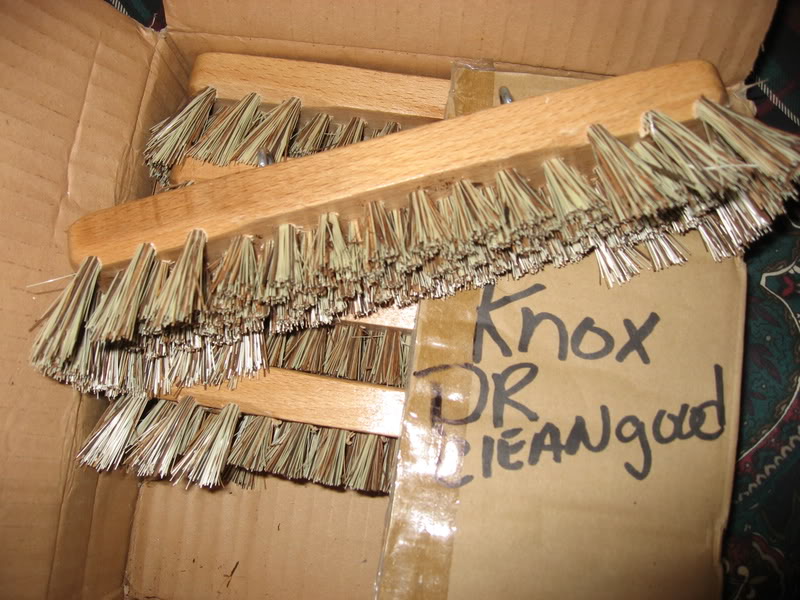

Here is what the Unger deck brush looks like before scrubbed down to a nub. I just got a case in today.
Notice the difference in the length of the bristles on the edge. This brush makes edging tile and grout a lot less of a nightmare. I have had accounts where my guys would prefer to scrub a whole kitchen with this brush instead of dragging in the swing machine.

Are those Nylon, Wooden bristle or neither?
