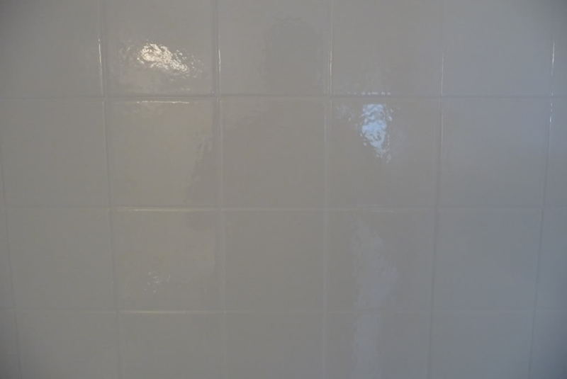

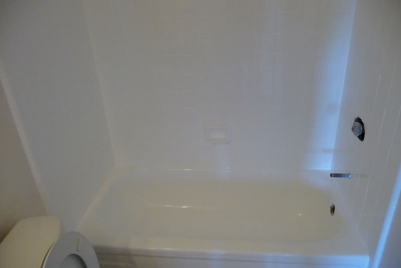

Have any of you any experience with this?
It was done on a shower stall at a section 8 I was at yesterday.
Looks great. Totally seals the entire surface with a epoxy.
I just have to wonder how long it lasts and how it holds up to doodle bugs and scouring.

Its that crap in the spray can one of my local section 8 apts does it all the time looks goood right of the bat but have noticed it coming off when they move out which never seems to long good turn over. I would use it in my own home.
never used it.
we've tired the spray epoxy/paint coatings on porcelain coated steel tubs, with minimal success.

As far as adhesion a lot of it depends on how well the prep the surface.
J
Jim Hadley
I own several rental houses and have used their process several times over the years. It is a good cheap fix, looks good, and holds up quite well. Again, like everything, the person putting it on and the attention to detail is the key.
Jim Hadley
P
postaldave
:roll: Ive done 2 tub and showers. What works great for me was proper prep,followed by spraying it with Polly Urathane Auto Paint,so far 2 years old in a rental unit ,no problem.Looks great.
Walt
Aug 1, 2007
1,016
I used to do these with my dad. I got to do all the prep work. Any soap or silicon and it would fish eye. My dad would get pissed because it's a two part product.
Quality is in the prep.
BTW - Holds up pretty well. We would charge about 400 bucks to do one in 1990. Took about 5 hours. 4 of mine and 1 of his.
Oct 19, 2006
890
Kevin McCreary
Probably 900-1200
I was thinking of marketing it to management companies and
I don't think they would spend that kind of money, however
In a residential setting where you can give them a 15 year guarantee
I think people would pay for it.
