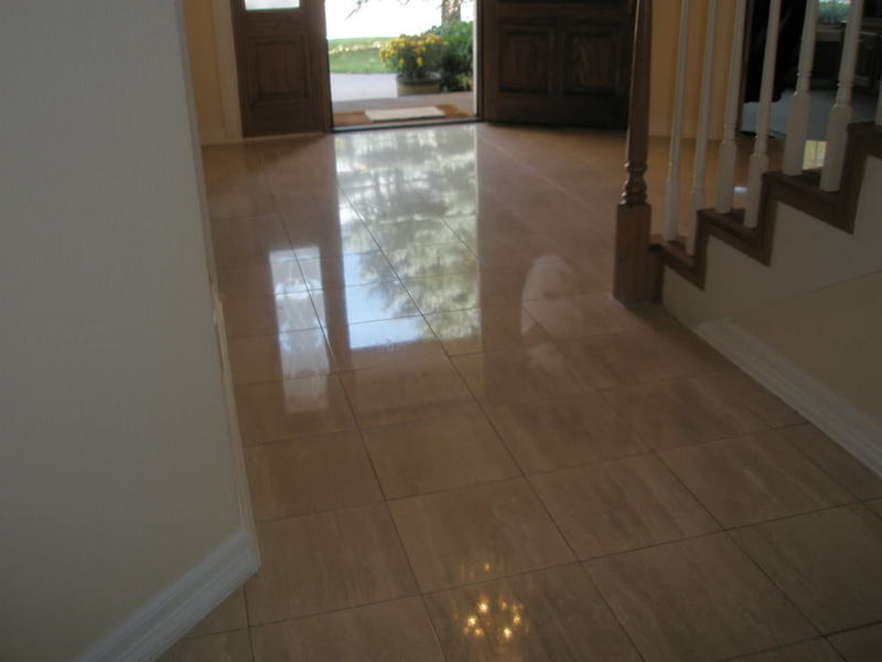

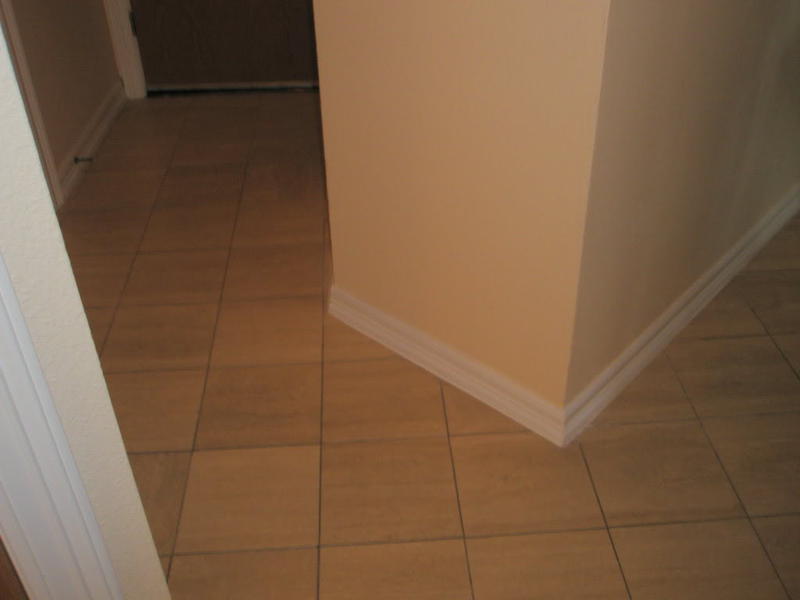

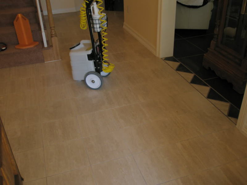

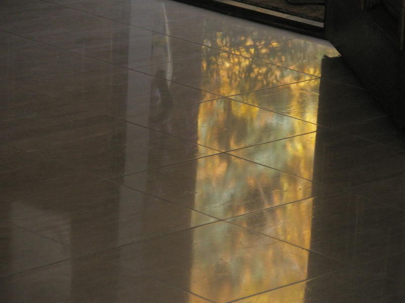

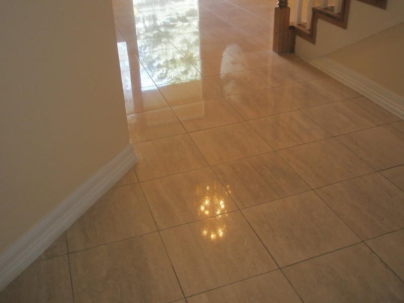

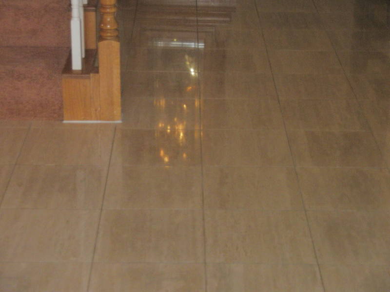

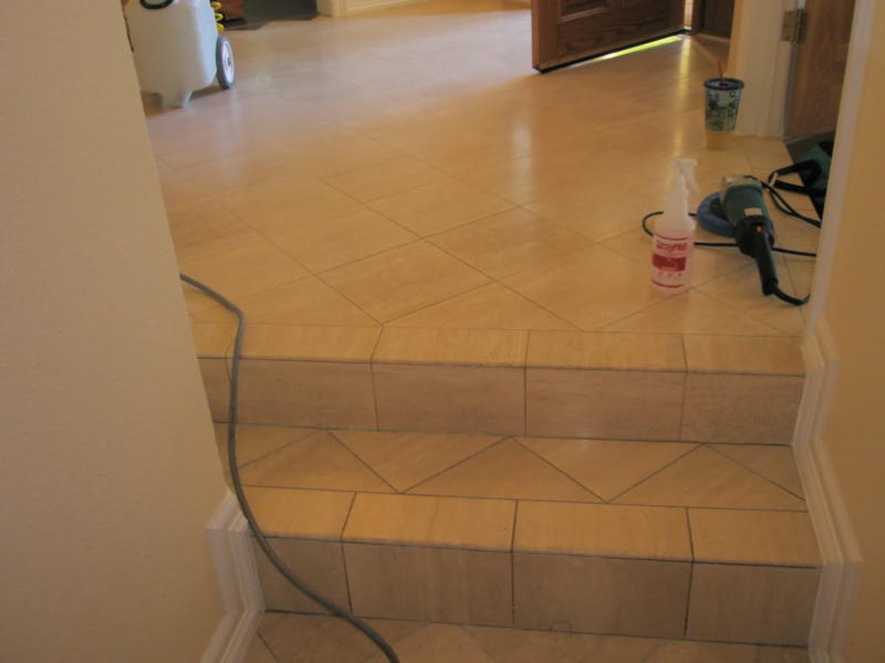

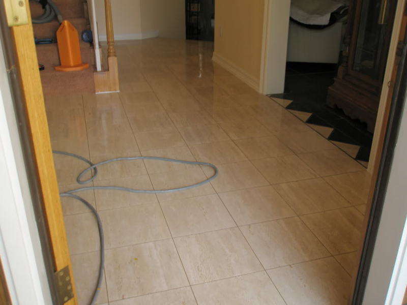

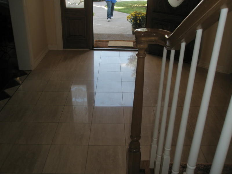

Nov 3, 2008 #1 Ron Lippold RIP Joined Nov 8, 2006 Messages 3,373 Location Albuquerque Name Ron lippold It just keeps getting easier Before after

Nov 3, 2008 #4 TimP Member Joined May 19, 2007 Messages 4,055 Looks like that one was done by a pro before to not have any lipage like that. You did a good job shining it up....however I think that's an ugly floor.

Nov 3, 2008 #9 Scott S. Supportive Member Joined Feb 3, 2008 Messages 3,225 Location PA Name Scott ok cool. just wanted to know how this amazing glossy floor came to be. what do you get for a job like that (per sq ft)?

Nov 3, 2008 #13 P Phoenix Phil Guest Nice work! I see your fine new Mytee sprayer! How's the sprayer working?
Nov 4, 2008 #14 floorguy Supportive Member Joined Nov 7, 2006 Messages 6,948 Location Utah Name Doug Not to down grade the job.... but why are all the before pics not in a lighted area??? Either from above or a door open?? Because all the after pics have lights shining on them...
