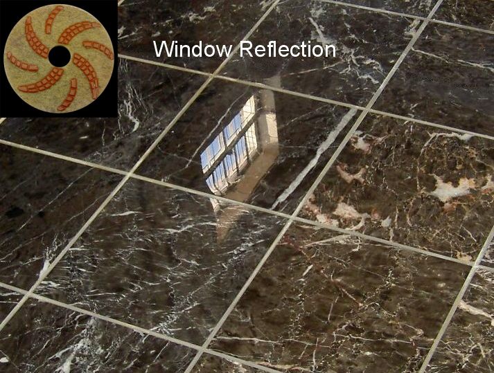

The diamond floor pads require using the 800 grit floor pad for the clarity you are seeking.
Here is the clarity of a similar marble floor I did with 400, 800 and 1500 diamond floor pads:
The best system for marble polishing is the heavy metal diamond driver along with the rigid diamond discs.
It is however, more dependent on a perfectly flat floor to eliminate the "window pane effect".
(Notice the effect between the stones)
It also costs more for the rigid diamond discs (about $192 for each grit required).
Diamond floor pads are ~ $75 per grit required.
Our experienced stone refinishers use both the diamond floor pads, and the rigid diamond discs (we supply both systems).

I said in my post above that the rigid diamond discs ARE the best system for obtaining the best polish.
I do think you need better rigid diamond discs than the $12 ones.
I also like polishing powder systems with the Gorilla pad, but they require masking and have acid components to contend with.
It takes a little practice to achieve the best results.
There is a place for all 3 systems in stone polishing.
