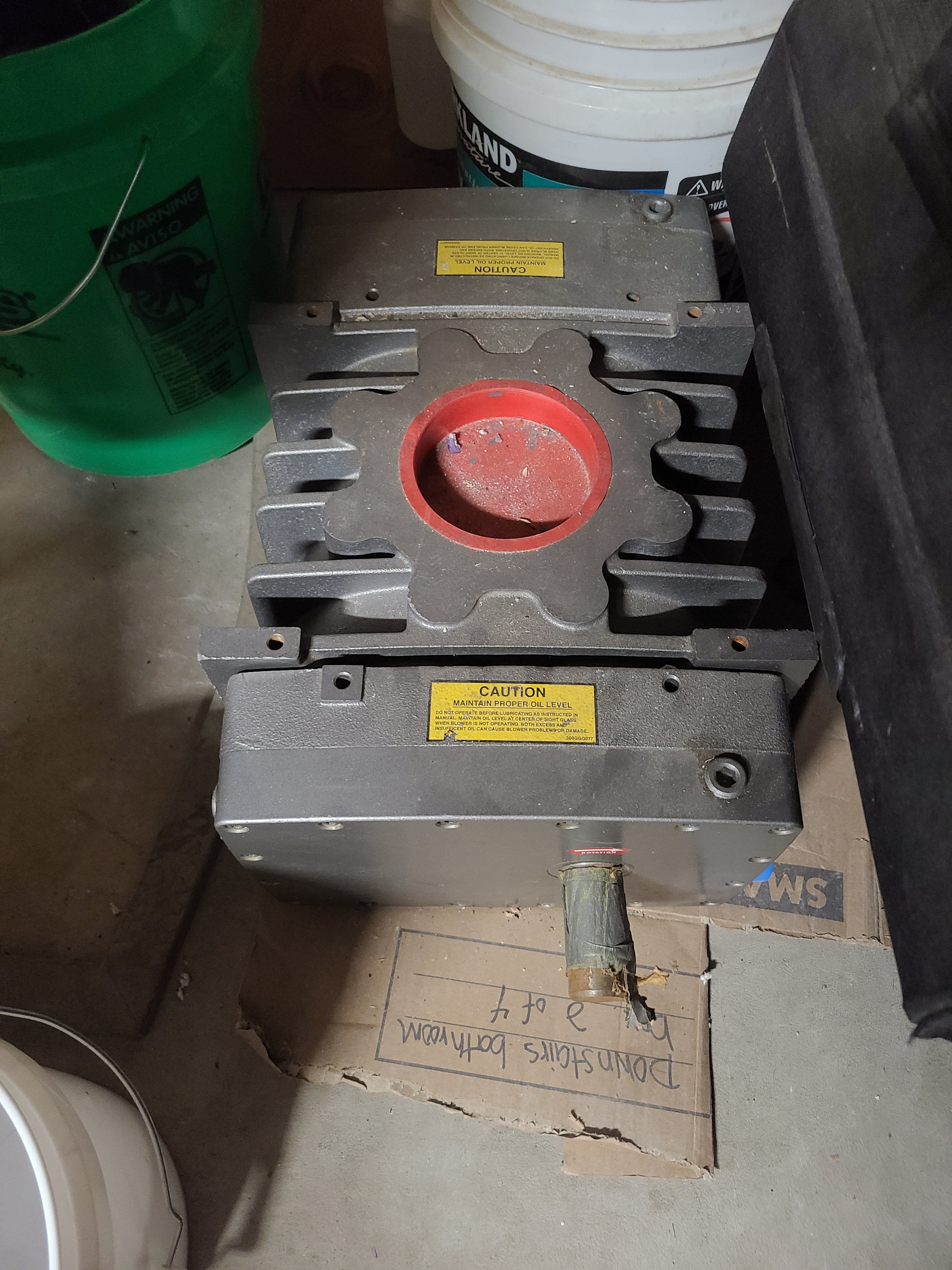

One we have been robing parts from but I have a new 40 hp Kohler and a 410 blower that I want to put on it so we can duel wand and put it in a big box truck with 500 gal fresh and waste tank we do some large commercial pre virus .

Might be a fun project. How are you going to quiet it down?

Not sure I'm not mechanical by any means .when we rebuilt my amtex my old mechanic put a car muffler on it . Not a flow master but similar.
What are your thoughts ? The rebuilt scamtex is loud .

It will take the right size silencer for that blower. The problem is finding room to put it. Mufflers will not cut it.

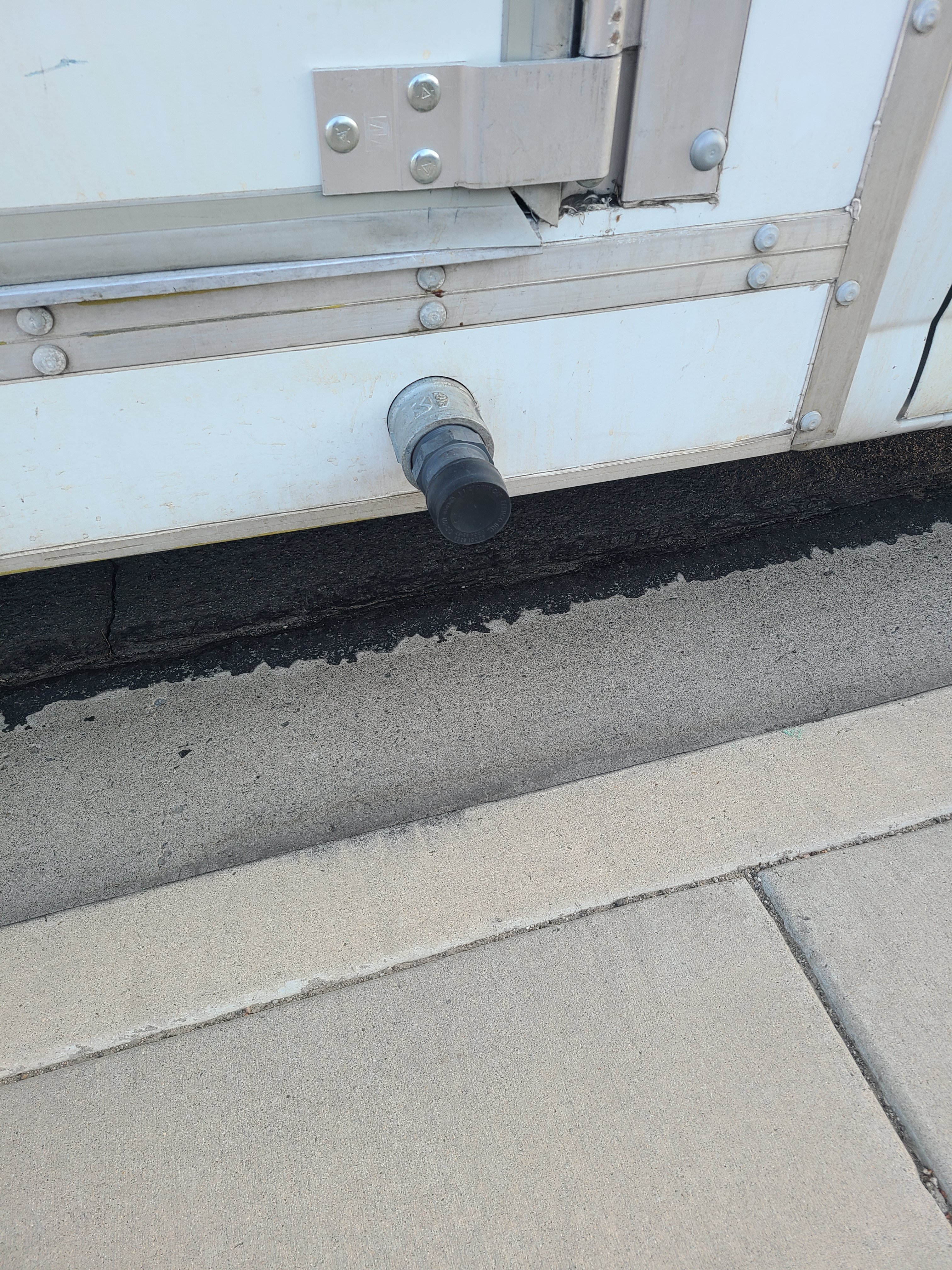

I am thinking Bout mounting stuff under the van .on my current box truck I have my dump line ran through the floor and mounted to the bottom so I don't get spillage in my truck supper nice to have will post pic in a sec .I am open to what it takes to do it right i will look into it for sure .
