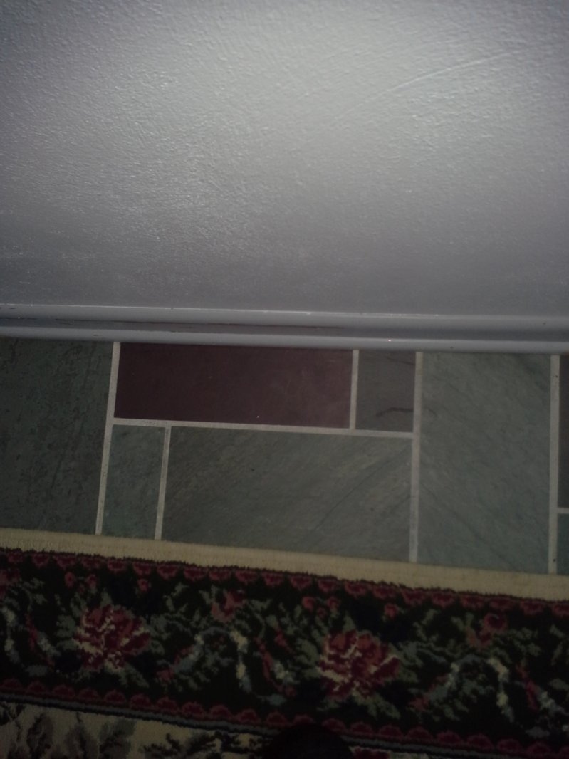

This is the tile in my home. I dont think its been cleaned proffessionally since 1956 when it was new.
This is what im down to after 4 cleanings. The mosaic in the bathroom is just as bad. Each cleaning gets its closer but no magic bullet yet.

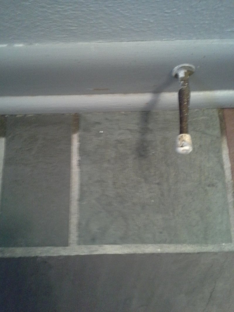

I still cant get it all off. I will have to remove the baseboards I think so I can scrub up to the wall. I shouldve jist done that from the beginning. I tore up the paint job my brother did this spring.

60 years of mop n glo!
Where I could run the buffer cleaned up pretty good but these edges just dont want to clean up. Ive even used a stainless steel brush on it.
Just brutal.

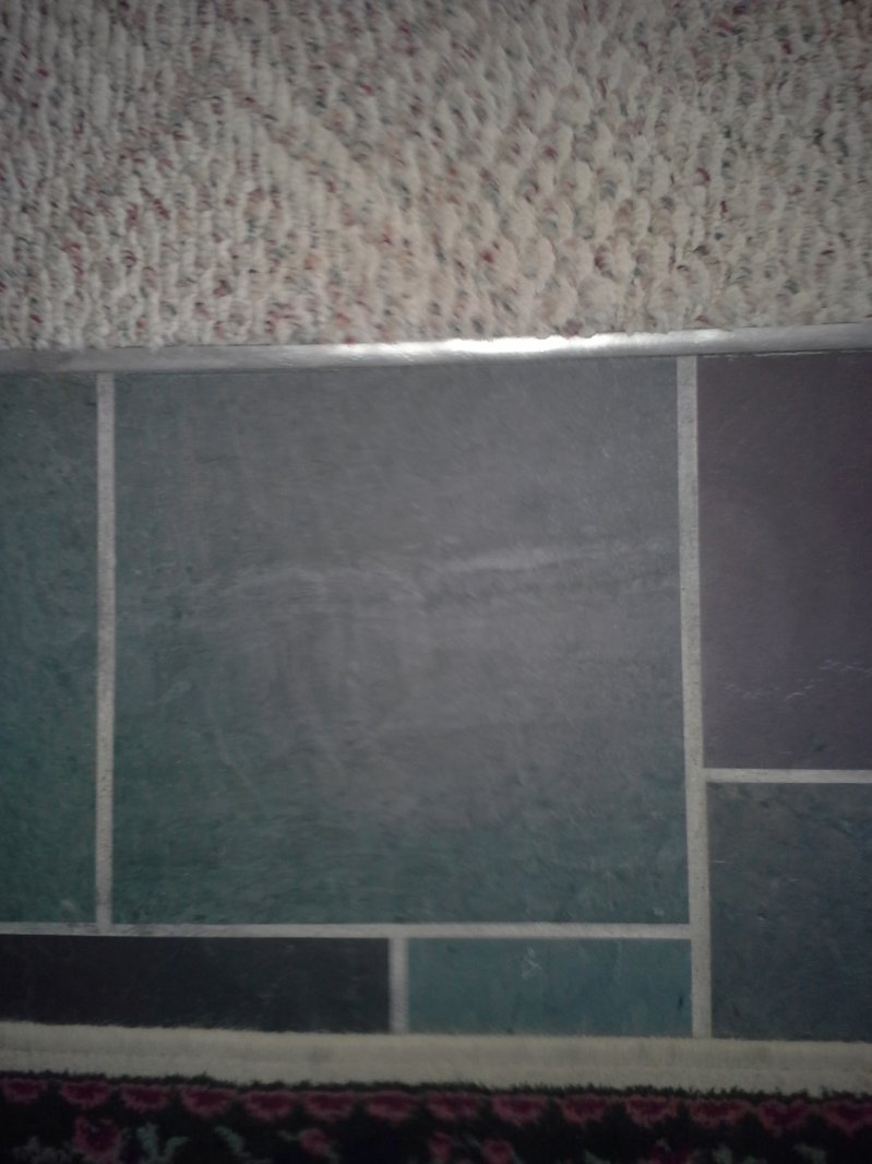

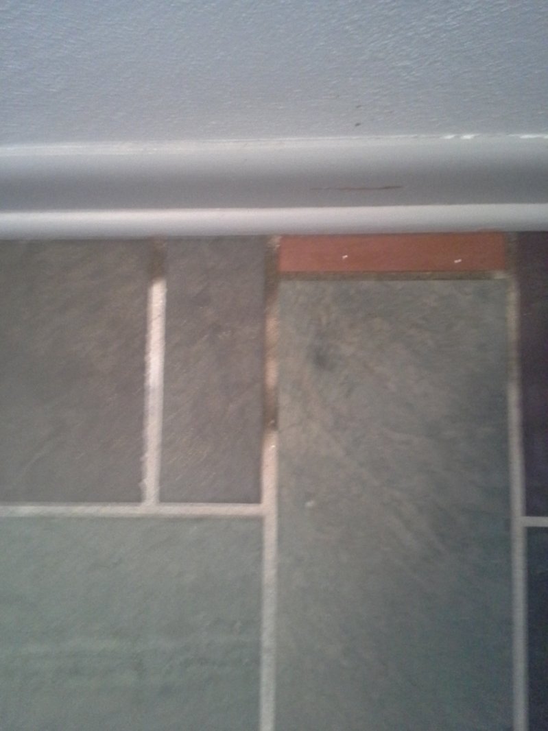

13,371
After a couple weeks the dark edges have lightened and there are only a couple lines where its dark.
I need to pop the baseboards and give it one more good cleaning then seal it.
Found it interesting how much its lightened.

13,371
I havent touched this floor since the last pic. Each day it got lighter and lighter.
Im going to pull the baseboards and clean it lightly and rinse it real well. Ill let it dry for a couple daus maybe to make sure its dry before sealing it.
