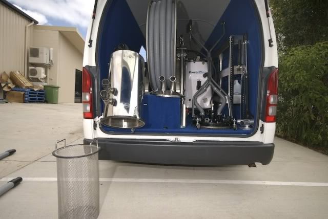

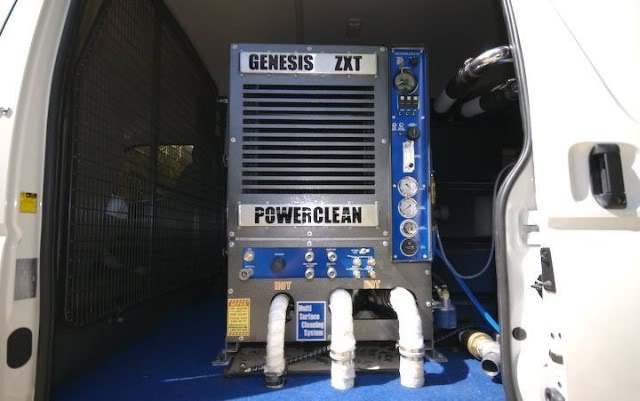

This again is a Toyota Super Long Wheel Base - yes this is one of the larger vans we get access too here in Australia before you really need to fork out for the larger Sprinters and Iveco vans.

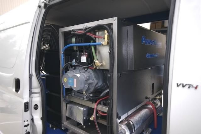

We installed the new Genesis ZXT into it and ducted the exhausts through the floor with underbody mufflers.

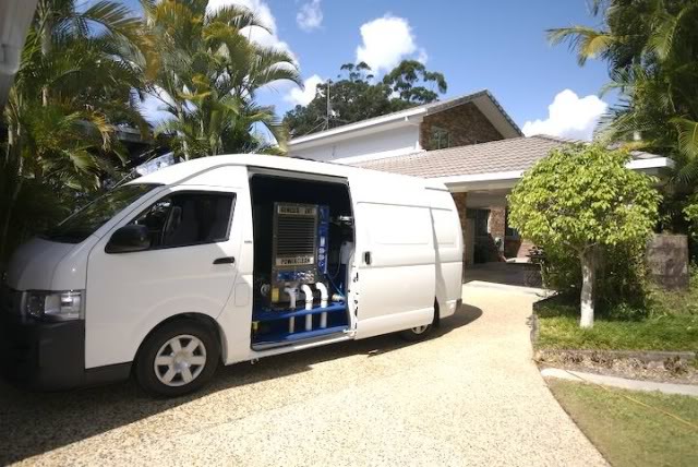

These are one of the few vans we have down under that have dual sliding doors. Make servicing the machine a breeze with the second sliding door.

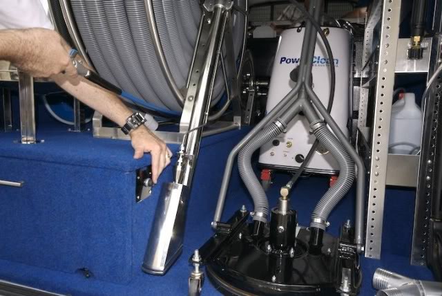

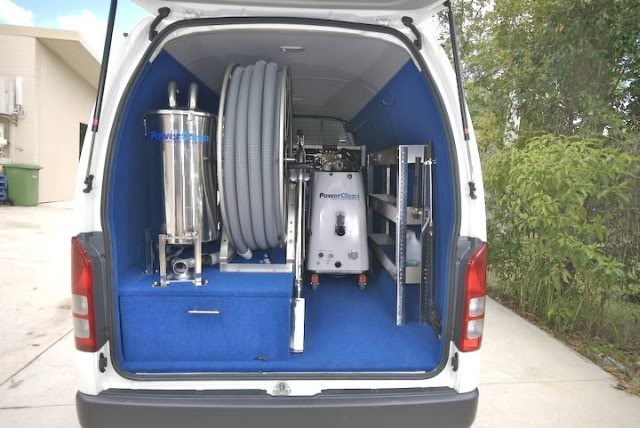

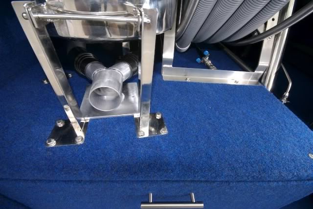

This is looking in the back door of the van. This van and machine have been set up specifically for hard surface cleaning. You can see in the right hand side mounted against the stainless chemical shelf is a high pressure lance and also the foam generator attachment also.
We have made the suspended drawer with enough width left in there so we can wheel in our high pressure portable (1000 psi with 2x3 stage vacs) which you can see. Sitting in a bracket affixed to the stainless steel vac hose reel is our edging tool, and of over the far right hand side is the larger external waste pre-filter to stop the larger debris reaching the vacuum tank.
And yes, we have plumbed this rig for 2.5" hoses.

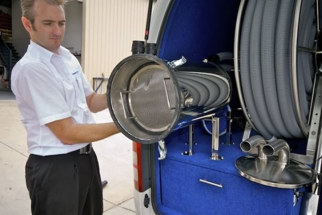

When you go to empty the stainless pre-filter, it is as simple as unclipping three hold down brackets, then the entire filter pivots over and outside the rear end of the van.
You can then place the rubbish from the mesh cage into a bin, and hose out the rest of the tank whilst it is upside down.
We mounted the high pressure solution hose at the back of the vacuum hose this time. Being electric wind up, we don't have to reach back and wind it up by hand, so essentially, we could mount it wherever we have spare room in the vehicle. We just press the button and it winds up from underneath the vacuum hose reel.

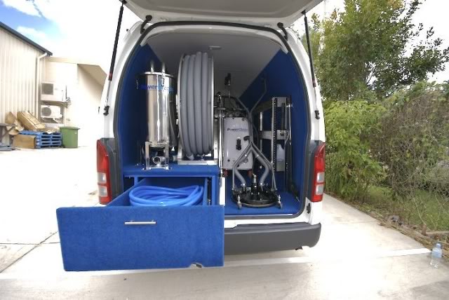

This is the final shot of the rig showing the hard surface head in place and also the sliding drawer being filled up with extras.

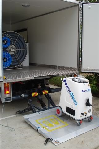

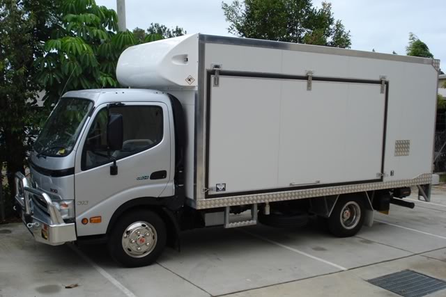

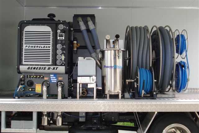

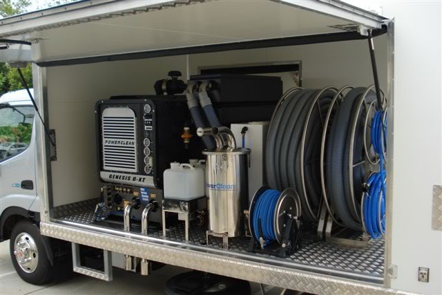

Here are photo's of a truck I put up in another post recently. This is our closest thing we can get legally on our roads and still keep a normal car license without going to a truck licence.

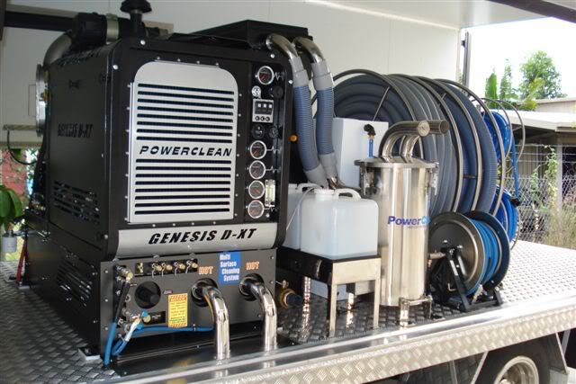

We have installed the new PowerClean D-XT Diesel Genesis
The D-XT has been been completely designed to handle 2.5" hoses. So we continued that train of thought on even to the external filter. It has 2.5" outlets as well (that can be quickly adapted back to 2" if necessary)

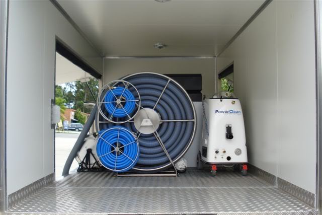

We put in a separate Stainless vac hose reel just to cater for the 2.5" hose. It holds 2 lengths of 2.5" on it. The reels are electric wind up as well with variable speed depending on the length of hose you have out.

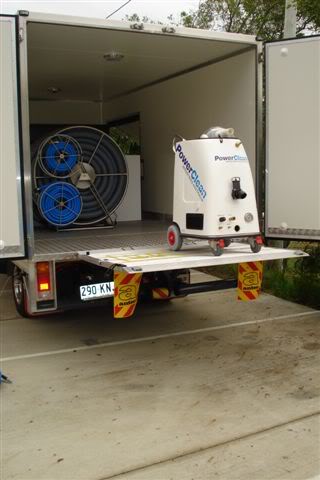

We fitted it with a tail gate loader as well to make getting portables, Cimex and dehums in and out of the truck a lot easier!
This rig isn't quite finished yet either. We are building racks that will hold 25 airmovers around the edge of the spare cargo area and then over the Vac hose reels. I will post more photo's when we are completed if you guys like.
This is a custom external filter box we manufacture that can easily pivot outside the pantec and drain. We make this for the guys doing external hard surface cleaning as well as flood work. You can see directly behind this tank is a 600 litre poly fresh water tank that feeds the Genesis on a demand system.

That is a sweet lookin rig. Is that a marine grade carpeting on the drawer?
When we do use carpeting, we rust proof the floor first, then use marine ply as the base, and affix marine grade carpet with marine glue to make sure with all the moisture and heat in the back of the vans, that our rigs still look great years down the track, not just while we deliver them.

Jim, the new installation pictures are just as awesome as the others that you have posted.Going back to the Toyota installation;is the carpeting glued directly to the factory walls or to the marine grade plywood?Also,if it is glued to the ply,do you attach the wood to the walls and then carpet the wood or do you carpet the wood and then attach to the walls?Thanks again and keep those installation pictures coming.
