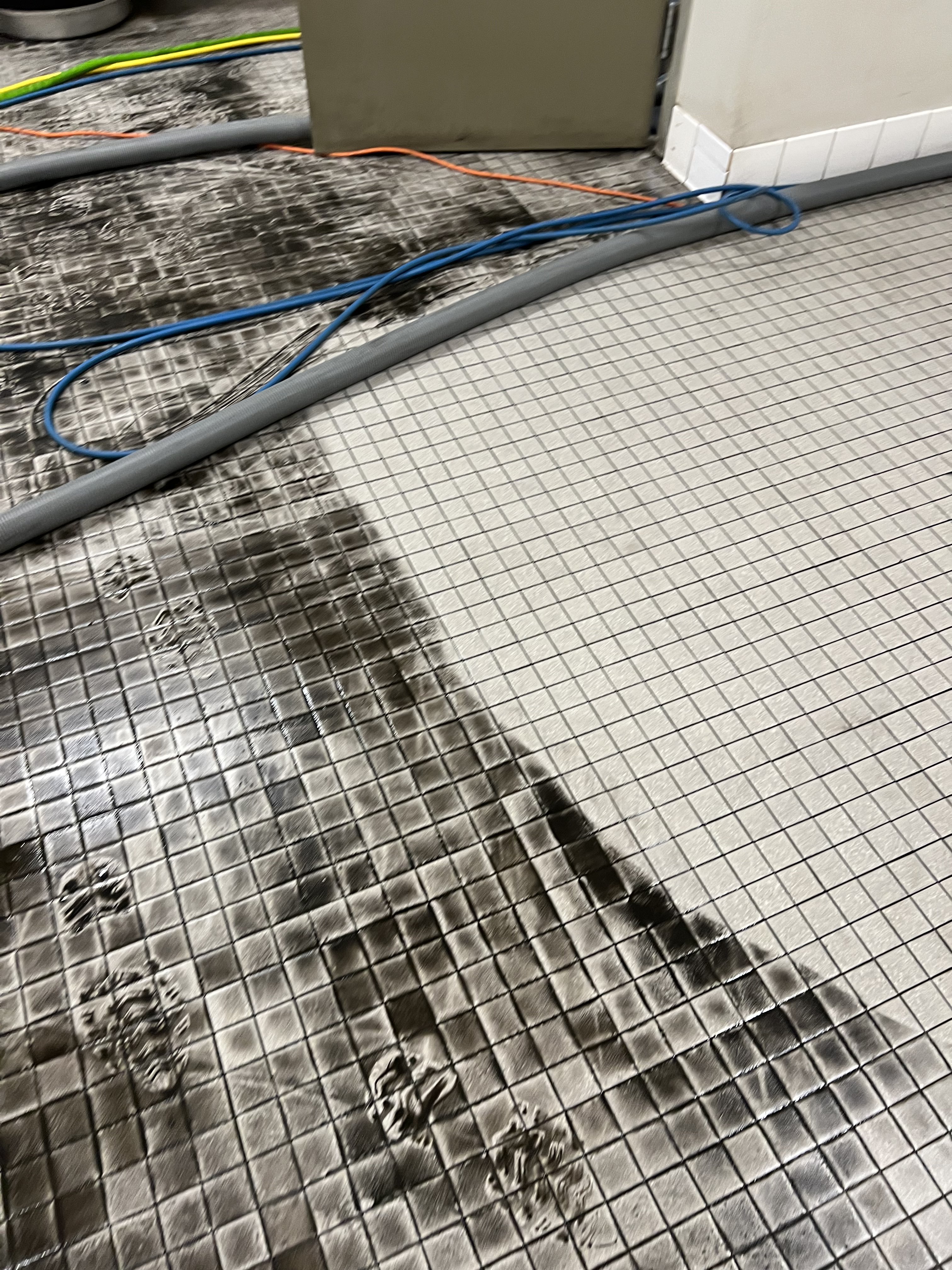

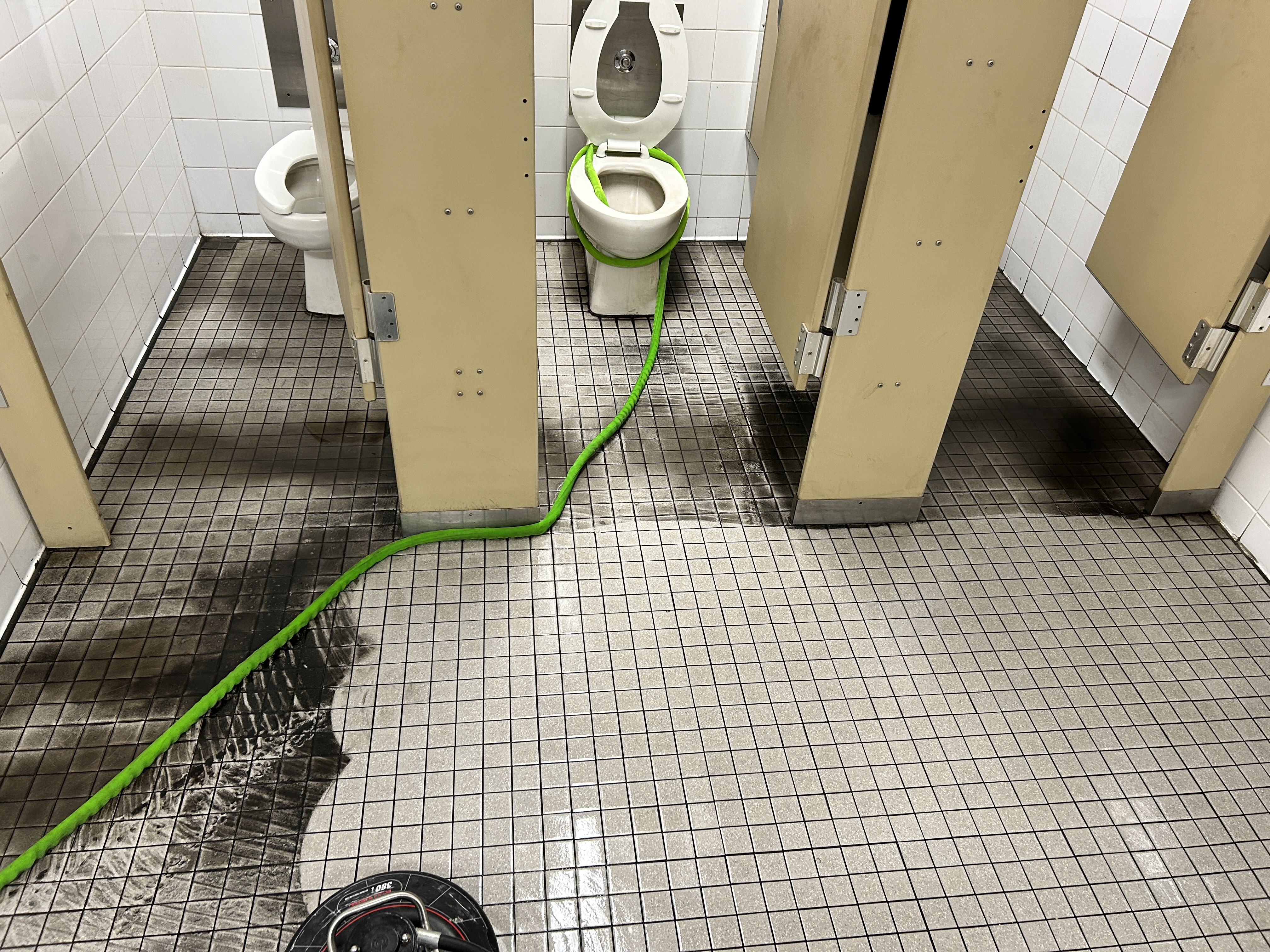

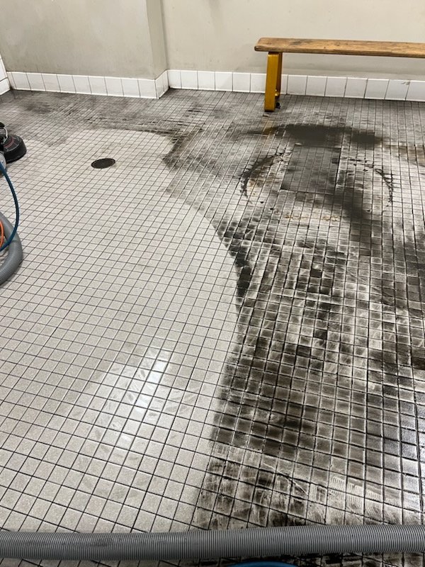

AA0FABA6-9230-4187-A032-CA9E6F5B1FE9.jpeg7A89B9C5-6CA4-4209-A0F2-4754352E5703.jpeg1EF866CA-C298-4656-934C-954912728CE9.jpeg

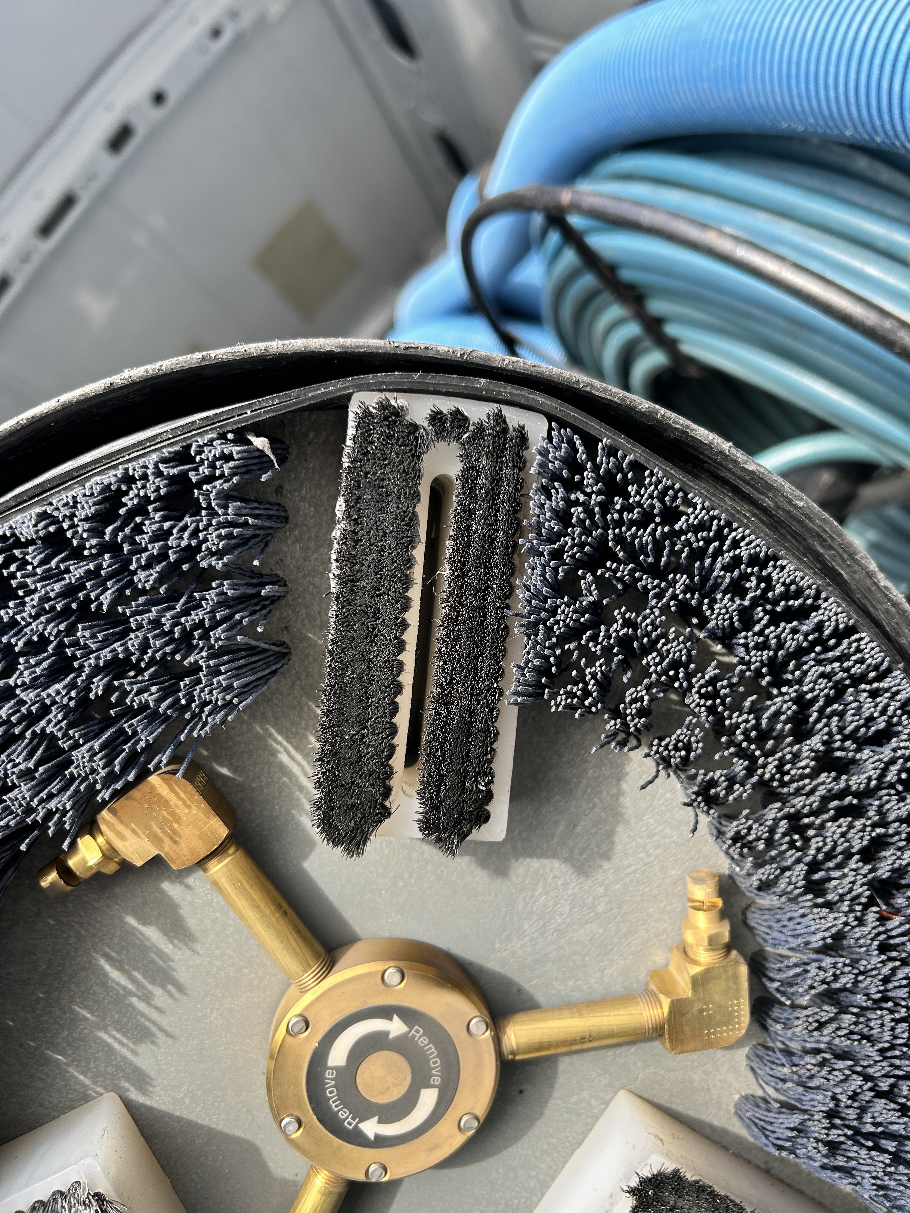

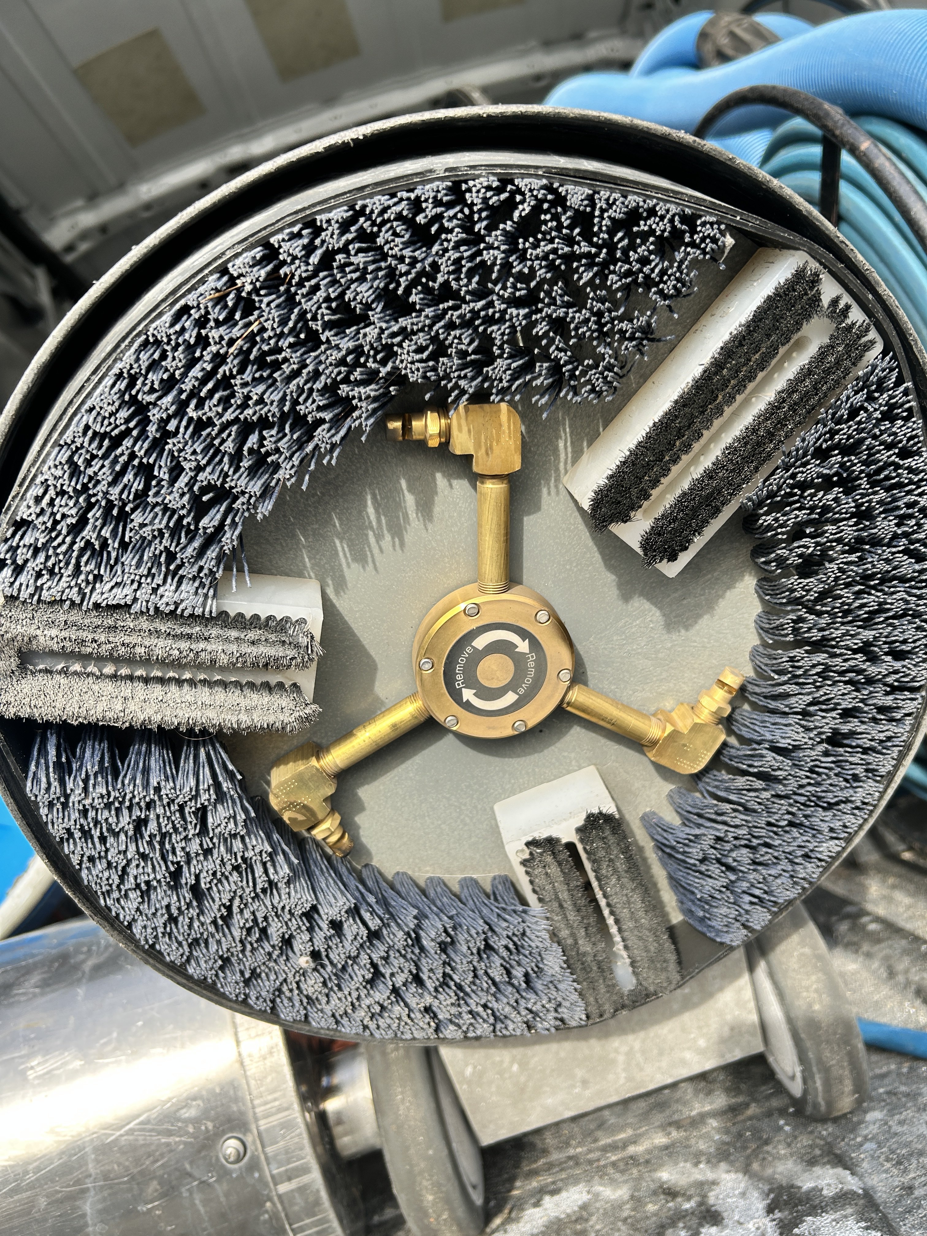

That's with the floating vacuum ring, correct?
No. It has white plastic brush slots in place of the swoops. Plus brushes all around like the carpet brush head. It’s like a 175 malish with vacuum slots and flood jets.
