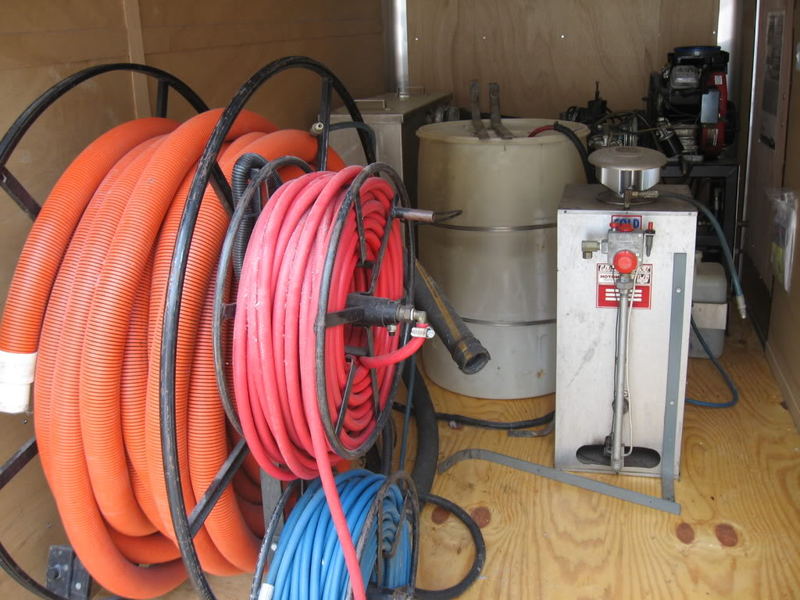

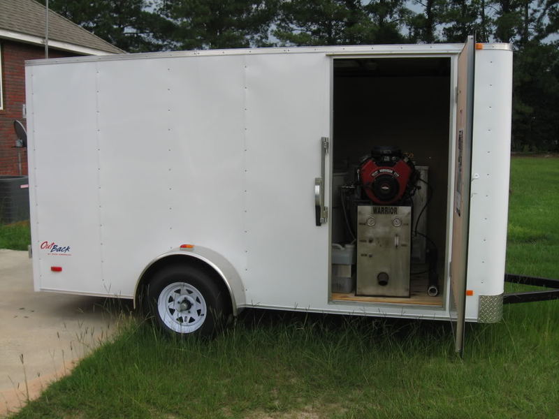

Yes it is a TCS warrior. A Marty special as I like to call it. 18 hp briggs engine, cat 3 pump, a lg 3ht, and a 36 blower. It actually has good suck from the vac port off the blower. I can't wait to see if it puts my cds to shame in suck at the wand.

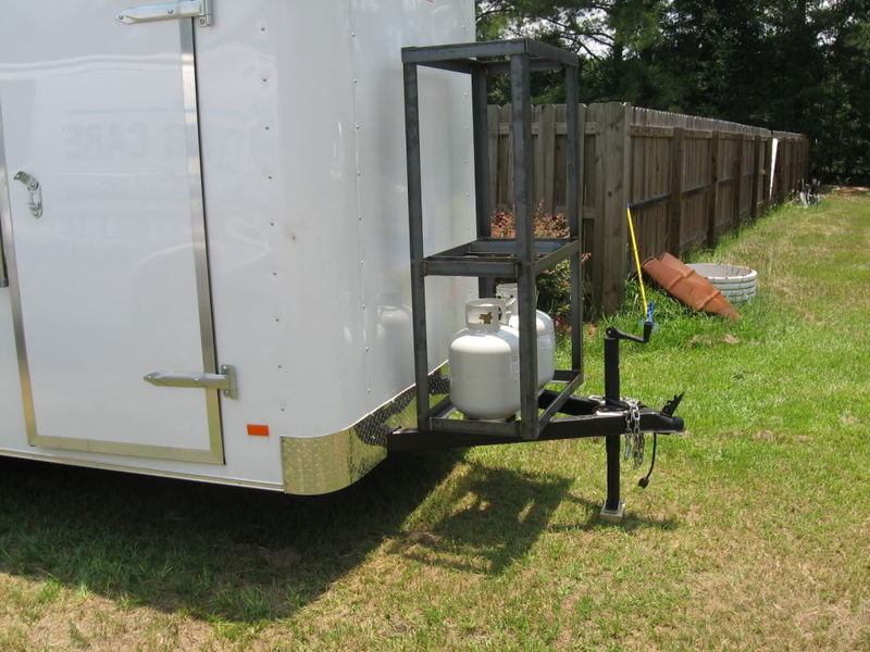

I just took it to the machine shop to get some shelves put on it for the LP rack and gas tank on the tongue. Supposed to get it back friday. I should have it going by monday.

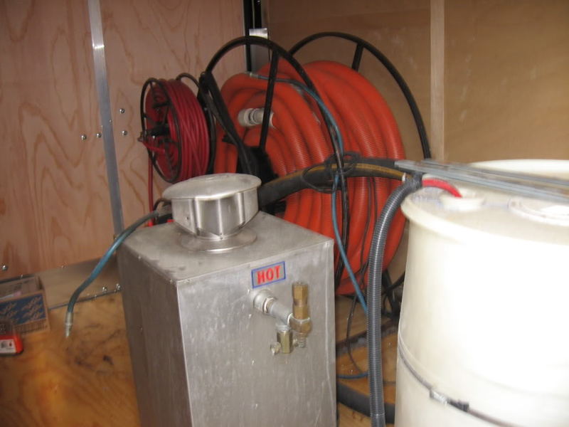

It looks like it would do the job. I like the simplicity of that setup. That’s a fancy live fresh water real. Is there a float shut off or overflow drain on the fresh water 55 gal drum?
TimP
May 19, 2007
4,055
The drum has a float and there is no overflow for it. That reel is an electric vac reel too buddy so it sure is FANCY :shock:

Ok here is the stuff they welded on the tongue. I'm going to have to paint it eventually to keep it from rusting but it's the best I could get done in such a short time. Tomorrow I'm going to get it all connected and it should be good to go. And if you couldn't tell we cut the grass....

That's a nice rig. If you put a swept 2.5 inch port on the waste tank and run 2.5 to the trailer door, you'll have more suck. TCS doesn't plumb as well as I would like for them to.

It's up and running now. It will be a machine I have to get used to as far as my cleaning habbits. There isn't as much suck off the carpet is what I noticed but when you put the wand on the carpet it takes about 5-10 seconds for the power to build up under the load. It sucks pretty good at 1 lenght of hose which I tried. Just as good suck or better than my cds once it builds back up. My CDS has the electronic idle so it adjusts a lot quicker I guess.
I think the water pump may need new seals other than that it's good to go for tomorrow.
