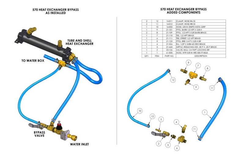

In reality once you figure out the 570 its very simple, an air pump that use's the vacuum pump to move the heat diverter and crazy cheap heat. Ya it bypasses but its not much different component wise then yours Mike.
4.8 Tri lobe blower 454 cfm, general pump, kubota motor and if you take off the machine covers its a thing of beauty.
An auto pump out is a must, the biggest problem for me would be the shut off switch in the dump tank.Do you use a better one Mike???? is there a better one????
11,567

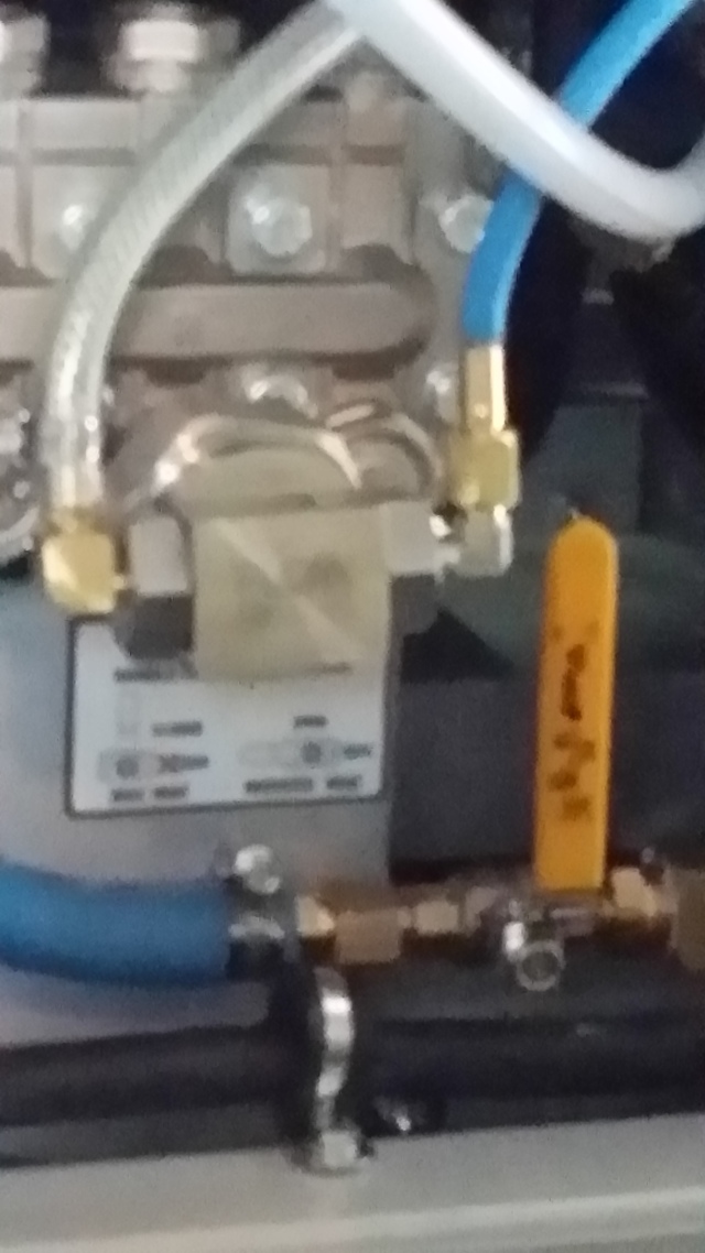

One last thing if the heat get taken out and you have turn it off the machine produce 170 degree water all day and you can easily unhook the pump air lines and manually turn the diverter off at that point you'll have not bypassing and still be able to clean.
