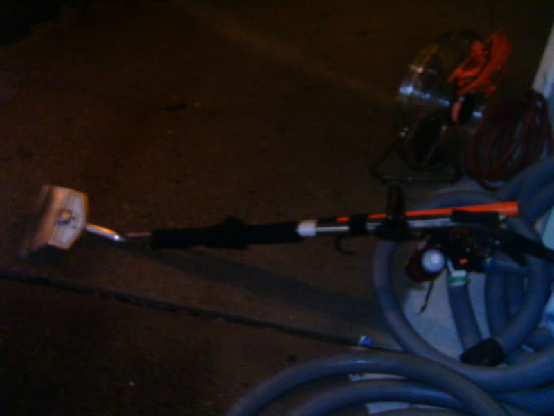

Great job on improving the wand picture...
