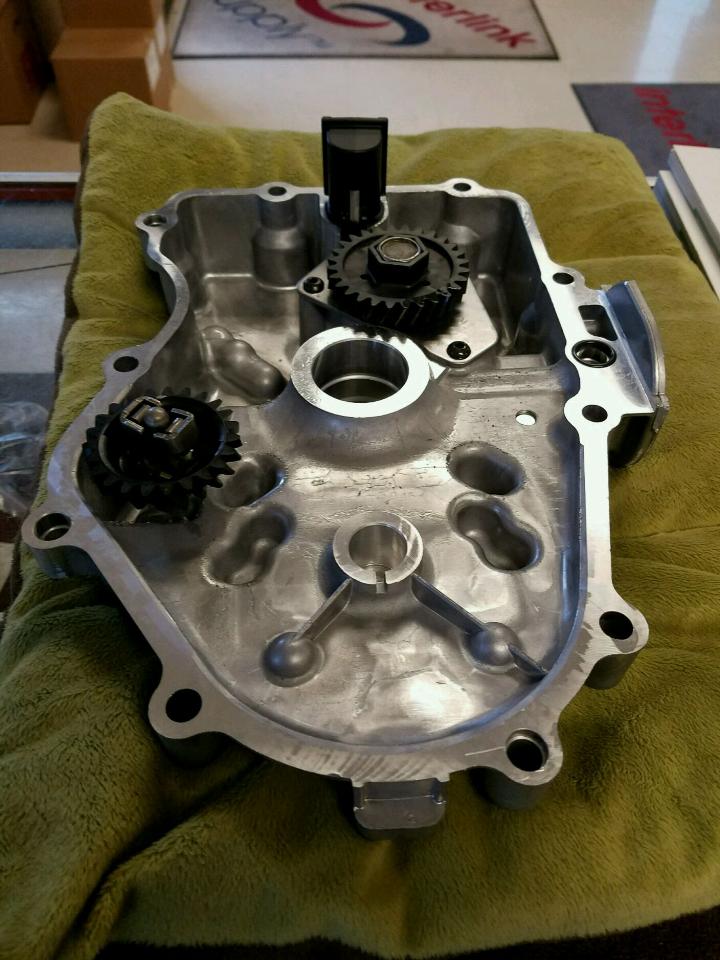

Back end has an oil leak.
I guess it so common than Kohler has modified the back to help the RV THREADS do its thing..
See that bevel on the lower inner edge?
That's where the RVT will gather to do it job..
Kohler is covering the whole tab.
