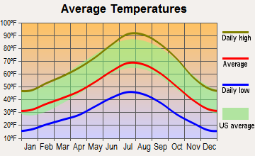

How cold does it get at the new digs? 31.5????
