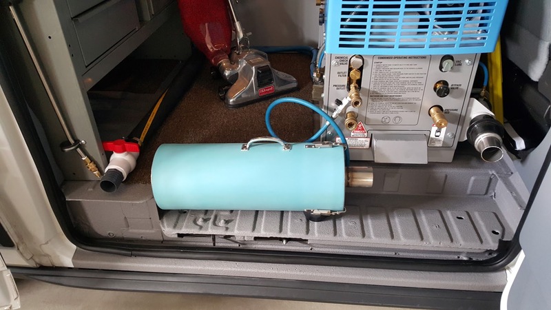

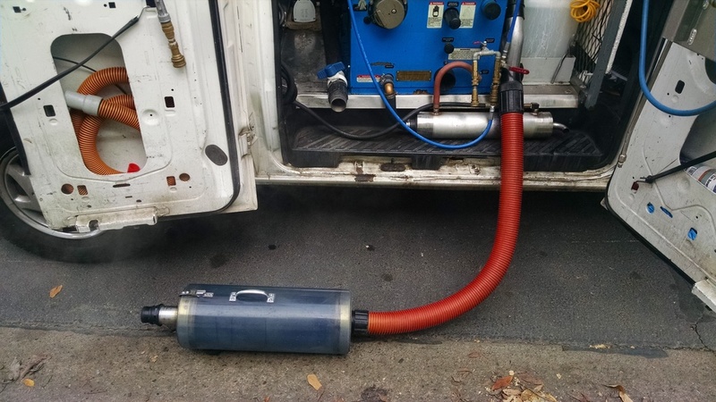

Sorry about the sound..
Perfect fit..

Thanks Mike,
One thing just make sure the Hd bag is sitting down on the ring kinda have to give it a little push to set it. Enjoy it, I wish I was closer I would run over there and let you try out the NO NAME .

Mike, I am sending you a extra 2" lid, so you can set it up like you were saying in the video.....at the end of your first run of 2.5 hose.
I also run 2.5 hose on my PC L, I have found it much more effiecent to have a short 2.5 hose that goes to from TM to the ground @ 3' or so. I just set it beside my TM, so when I set up, I hook 2.5 hose up, set Dev down on the ground and plug it in.
Now I also have 100' of 2.0 that comes off reel FIRST if I can reach the job with that I use a adapter (I made it) that slips into the 2.5 port so I can just hook the hose to my Dev.
If my job needs more than 100' I have my 2.5 cut in 25' sections and if I get into the 2.5 I then just take out adapter and hook the 2.5 hose up the the Dev.
This keeps you from having to walk the filter up the hose run, everything is set up right at the van, the Dev will easily (most of the time) never need to be checked on one job......If it DOES then the Dev is already out by the van where you have your service rinse hose that can quickly spray down filter bag to get you back up and going.
I have not noticed any real gain by taking a filter UP the hose run...UNLESS it is a step down filter, meaning it has a bigger set up on the van side vs the job side....4 2 door or 2.5 with a job side port being a 2.0.
I will post pics but it is basically the same as Mike Drapper's pic of his twin Dev's

Any performance testing done on where to install the filter?
Is a few to ten feet away from the truck any more or less effective than at the end of the first 50?

I have not noticed any gain worth going up hose run when filter is straight through flow meaning 2.0 x 2.0 or 2.5 x 2.5
It is just a way easier set up to just drop down and hook up by the van, the other reason for this also is sometimes at least for us the filter would end up being placed in a awkword place, stairs, or just off the front porch you know what I mean, and then we would have to pull off a whole extra section of vac hose to get it to sit in a good spot.
Setting it down by van.....it is the same everytime.
Also it makes your step down from 2.5 to 2.0 on your hose run nice and smooth as it is just done with a cuff and that is much easier to bring 10 or 15' into the home if need be to reach the back of the job.
