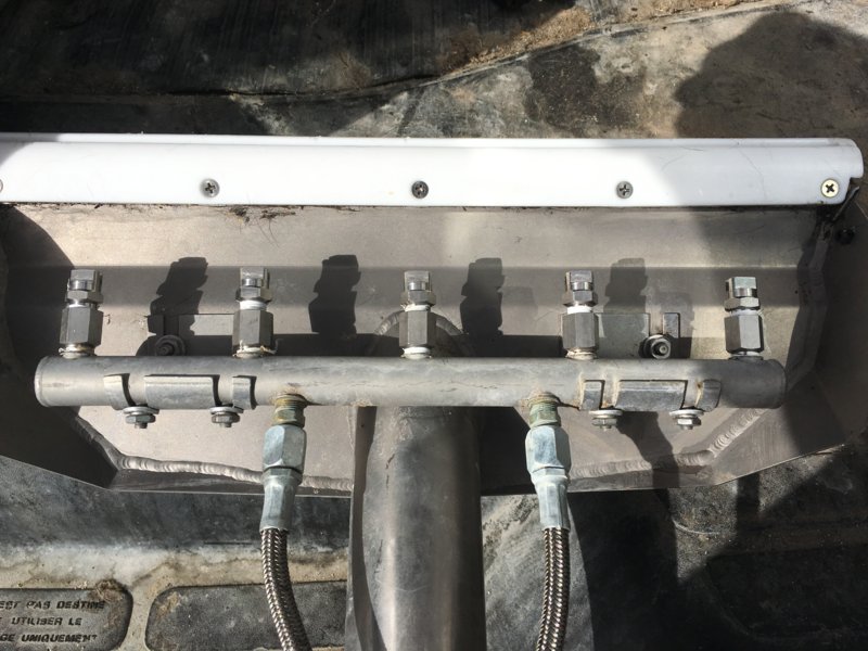

My new Mach 15 titanium wand
11,551
I got a screaming deal from @Mikey P

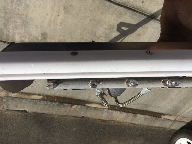

So I pulled the 7.5 flow jets
Kicked it up to 10 flow, two 9502 on the outside 3 11002 in the middle with a 1/2 inch extenders and Joe's stubbies.
Readjusted the jets to spray much closer to the glide.
It's a square footage killer.
I need to put a feather touch valve now.
