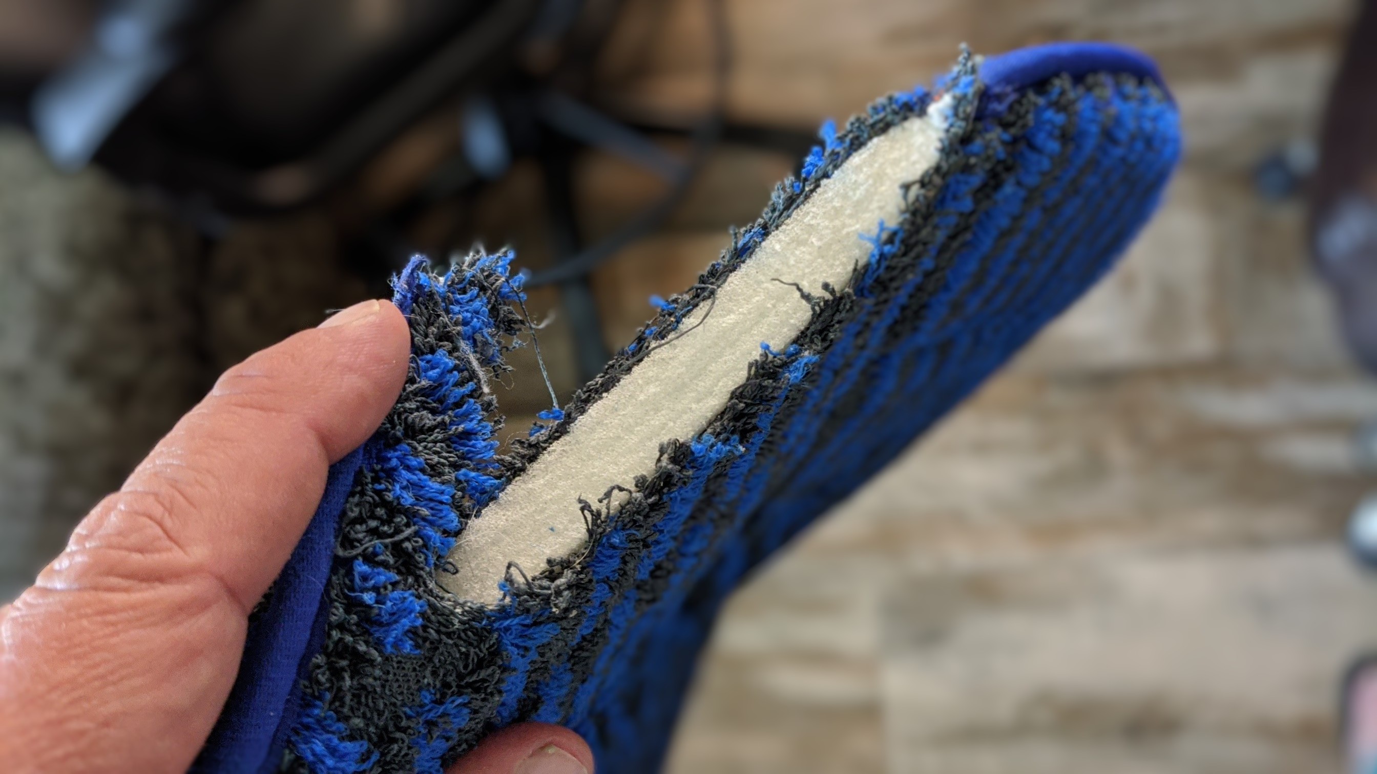

Somehow this brand new TOPS MF pad got sliced in the washing machine on it's initial run through...It's interesting to see the foam in there before it breaks down with use...
I think I'll do a little soil soaking experiments out in the laboratory tomorrow...

I think the pads shine the most getting the last of the dirt, after the heavy soil load is out, or on VERY lightly soiled carpet.

The microfiber texture itself is likely to hold far more actual soil than the (compressed) foam would ever be able to
