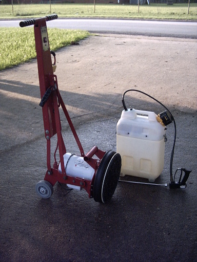

I bought this sprayer about 12 years ago, like Lee said, the removal dewalt batteries are nice. You can have one battery charged or charging while one is in the sprayer so no down time due to dead batteries. The down side is the batteries are expensive.
9,757
I bought this sprayer about 12 years ago, like Lee said, the removal dewalt batteries are nice. You can have one battery charged or charging while one is in the sprayer so no down time due to dead batteries. The down side is the batteries are expensive.View attachment 2582
