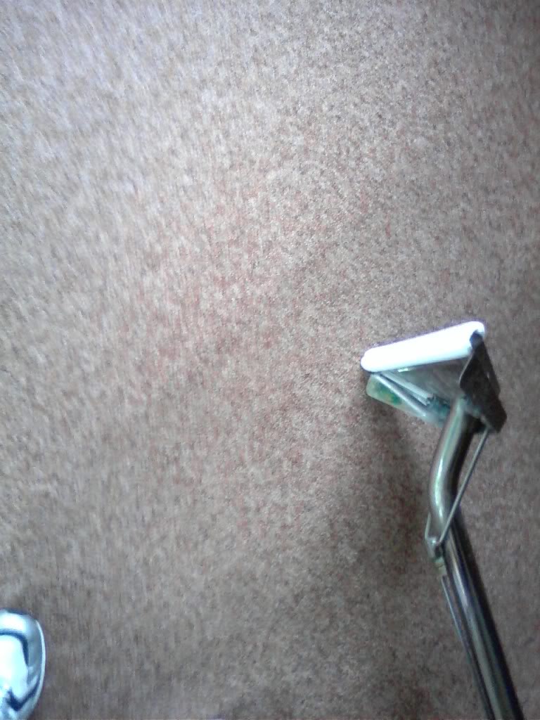

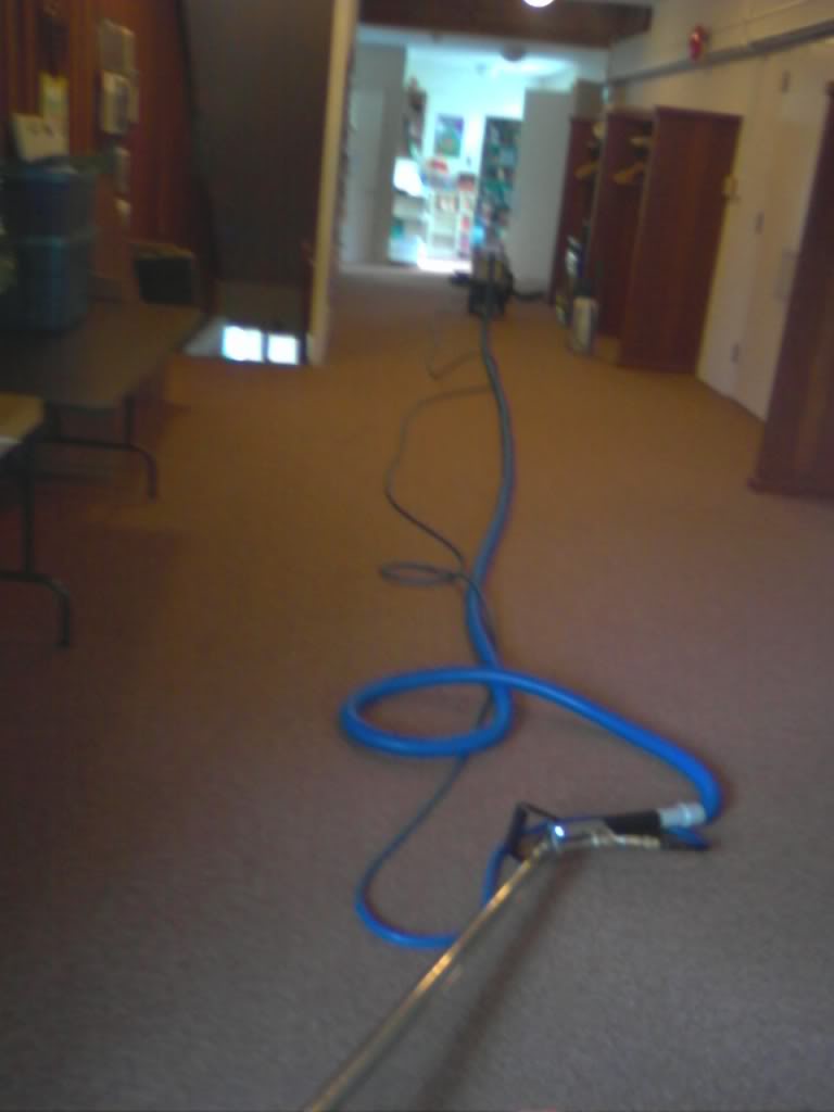

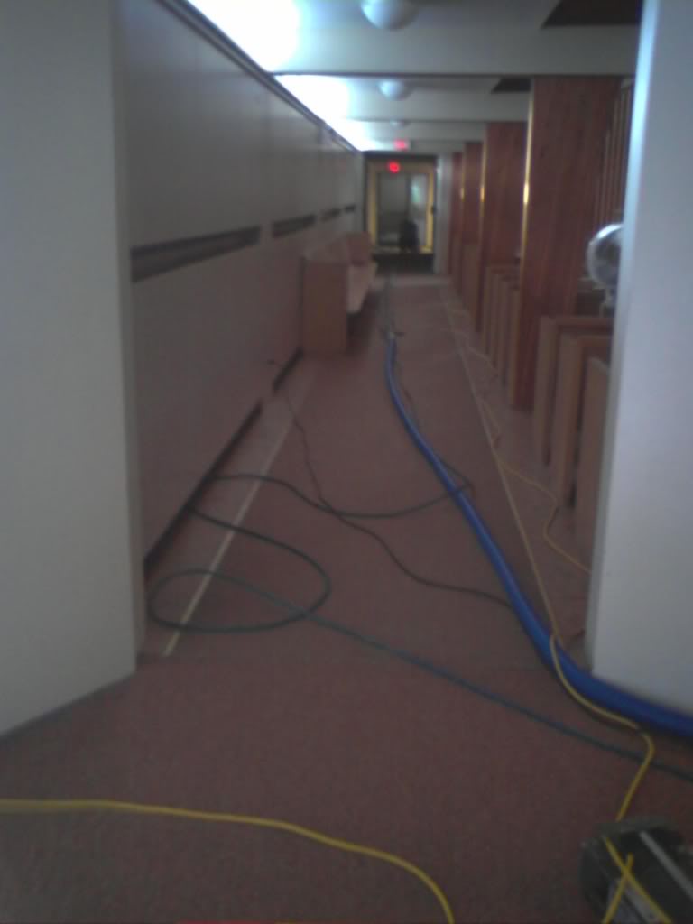

Here you go Larry - You don't know WTF you're talking about. (Or Chavez but that's a given:biggrin:) The carpet was dry in 4 hours. I did use a booster 50 feet downline.
Start here:
so you're 50ft to nearest vac
cut that off and run that 150 down to the finished basement
Lemmie know how that works out
is that your machine in post #127?
Willy P
Oct 2, 2007
10,952
Willy P
Geez, all you gotta do is run it from the basement. Catching on yet? However for the most part- I rarely use more than 35 feet because I'm an apartment ho. Sometimes 50 for townhouses.Dual 3 stage vacs and a good dry stroke technique and I don't get any complaints about dry times. I only use certain machines for certain jobs. My old Recoil is a 3 vac tank. 8 years old and still killin' it.
Yep- that's the Recoil doing a church. I was watching for lightening bolts.......:eekk:
