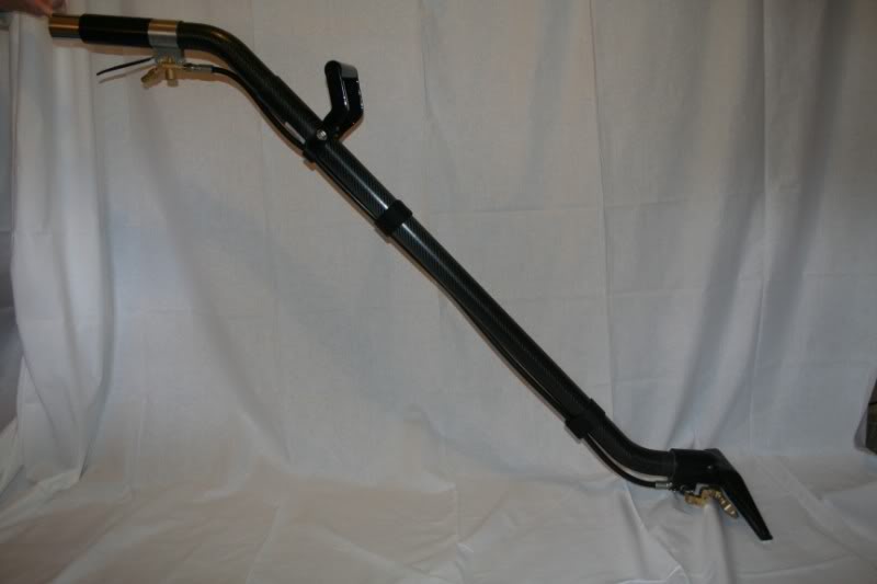

I would like to see the other end of this photo to see how high the wand handle is lifted to get the jets that high off the ground.
Same here Dave....cause that damn sure doesn't look like the angle the wand would normally be used at...BUT...it is also using a GG ($109 option)that raises the jets

With most wands the top tube (Where the trigger is mounted) is horizontal to the carpet or even slightly downward in the other direction. (You can see in this pic it is far higher.) They also sell a gun grip option that would place the jets even lower.

That picture looks like the jets are much higher. How does that wand work if any anybody is using it?

Here is another photo with the Stainless Glide that comes with the Bentley:
View attachment 1165 You can see the slot is at the correct angle to the carpet.
The stainless steel slot glide is longer wearing, and still has the rounded bottom of a glide
(although not as slippery as Teflon).
The cleaning test between the 14" CMP and 14" Bentley was done on dirty carpet with a #4 TM.
The Bentley was visually cleaner with only 1 pass for each wand.
Larry
P.S. The newest manifolds from Mytee have a Stainless Tube clamped to the wand . . .
with brass fittings used to position the jets higher.
